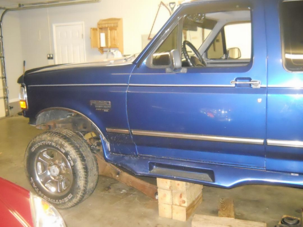

got some more pics finially... thay are horriable. gonna get a few more on sunday when i work on it
OUT WITH THE OLD
the super duty frame ready for the scrap yard tomorrow morning. so glas i got a tourch
IN WITH THE NEW, not where its gonna sit. my blocks are right where the radius arm is gonna go. dont wanna move them back due to im afraid its gonna teider on the front heavy engine. gonna have to block it up on the front horns
another shot
