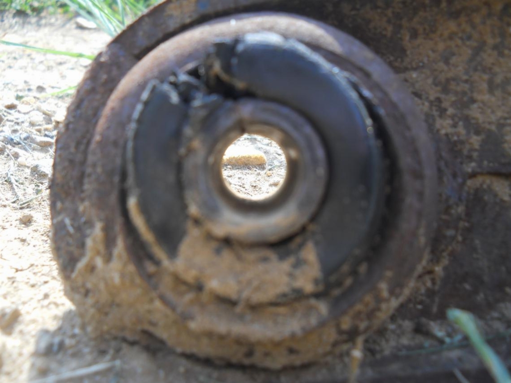

got some more pics for everyone..... these are my old bushings in the D50... SHOT.... THAT IS WHY IM DOING ALL OF THIS IS BECAUSE OF THAT BUSHING, WELL BASICLY

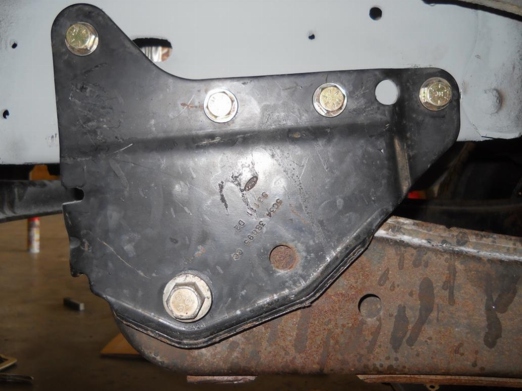

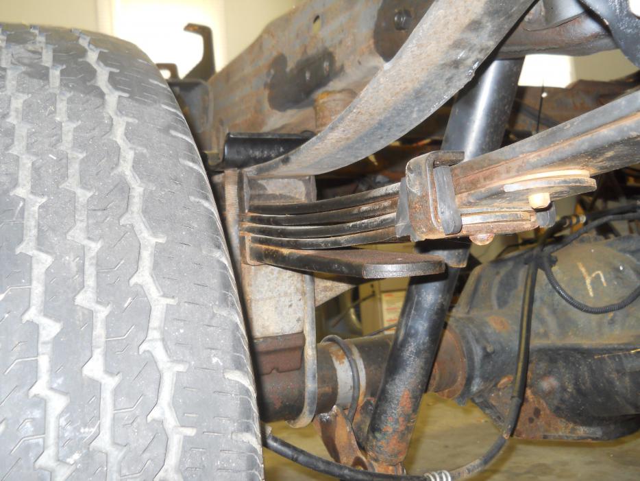

GOT MY F350 4" BLOCKS IN AND PUT MY OBS OVERLOADS ON FOR NOW UNTILL I FIND A BETTER SET

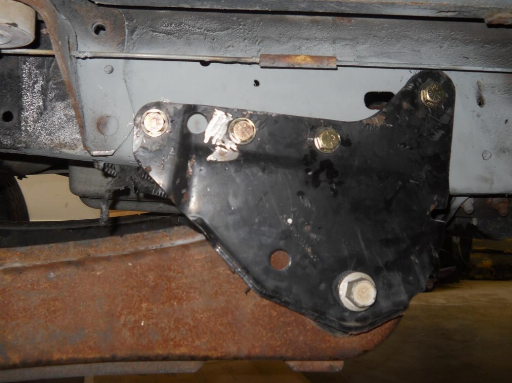

GOT MY RADIUS ARMS BOLTED IN AND READY FOR SOME STITCH WELDS
I DECIDED TO JUST BUTT THE MOUNTS UP AGAINST THE BODY MOUNT AND NOT CUT THE MOUNT BACK ANY. I LIKED WHERE IT WAS.... I WAS CONTAPLATING MOVING THE AXLE FORWERD TO GIVE ME MORE CLEARANCE ON THE FENDER FOR BIGGER TIRES AND JUST TRIM THE FRONT BUMPER BUT LIKE I SAID, THEY WERE PERFECT RIGHT THERE

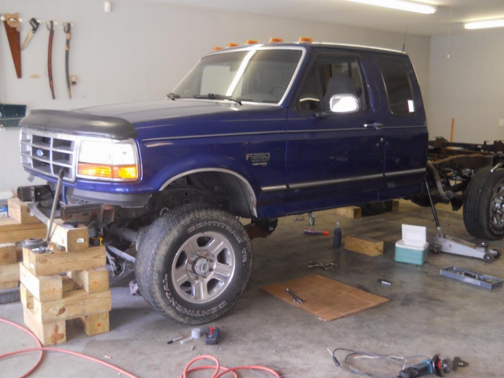

A SHOT OF THE AXLES IN THERE FINAL SPOT. SPRINGS ARE NOT IN YET

Your missing a rivet on the body mount.
yes i know.... when i was grinding off the backs of the rivits to driveout the old leafspring pearch i started on the wrong one. i just reamed it out and put one of the 1/2" bolts iwas usin for the swap in. its not missing any more

i didnt have to go as far as i di on the rear but i needed new spring pearches and hangers so instead of buyin OBS ones i just used the SD ones an modified the frame. and i wanted to paint everything
