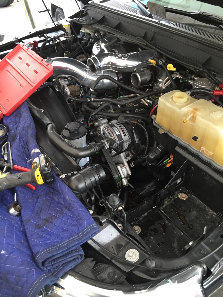

It's time to come apart!
jcain
Jul 14, 2013
2,017
Motor done? I see you pulled the i/c and battery. Taking the whole front clip off for something?

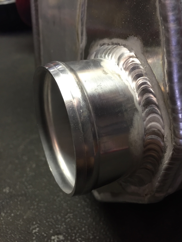

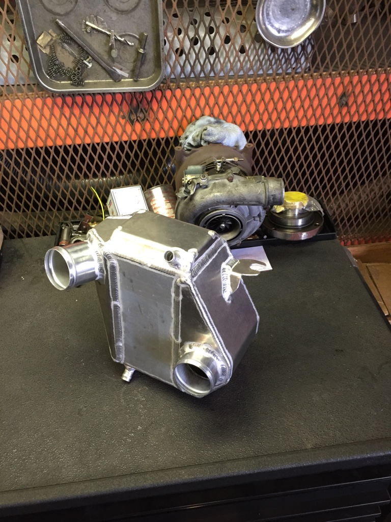

Mike Custom made a rolled bead outlet on the bottom outlet of one of his Intercoolers for me to help with the problem I was having with the bottom hose. Thanks again Mike it fits perfect! Problem Solved.
Jomax
8,576
Arizona
Are you going to start making them all like that Mike? (Rolled lip)
bigrpowr
<How I Fly
Administrator
15,240
no, not needed. mine held fine with 55-60 psi and a lot more cfm. his just kept blowing off for some reason, most likely pipe angle .

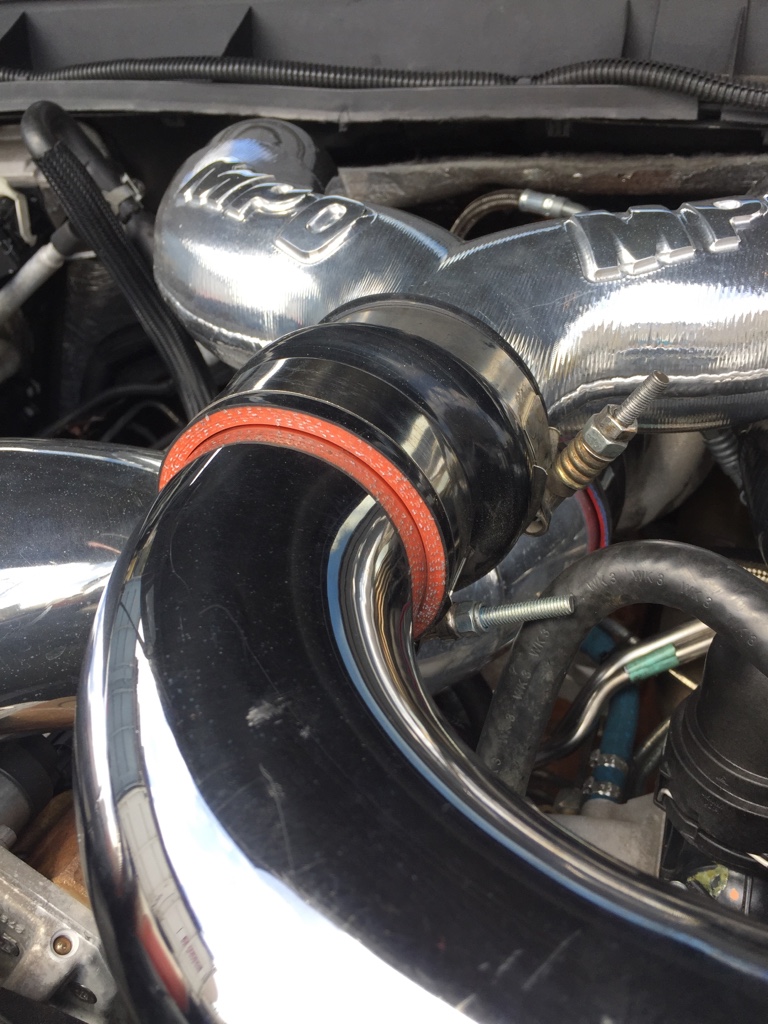

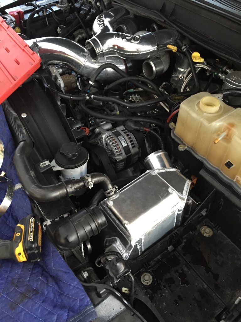

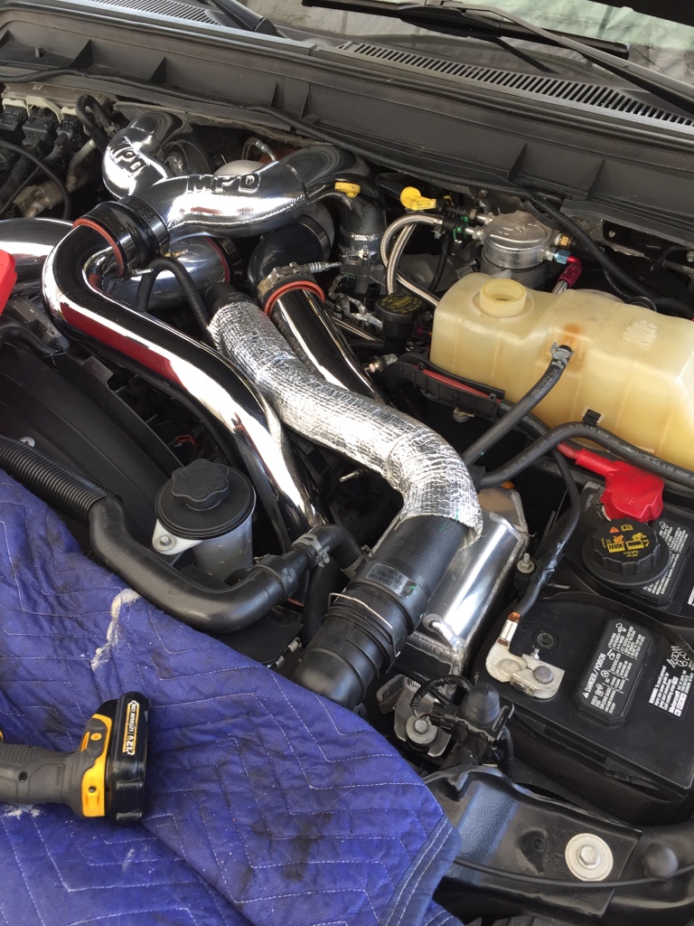

We got it back to get get with the No Limit Intercooler. And the new connection worked perfect just like we planned.
With the cooler in we had one more adjustment to deal with. The cooler moves the pipe 1 inch to the left and makes the hose not fit like it should.

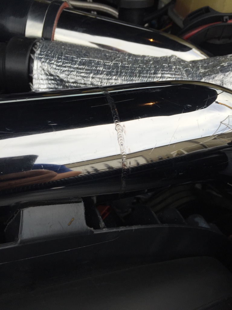

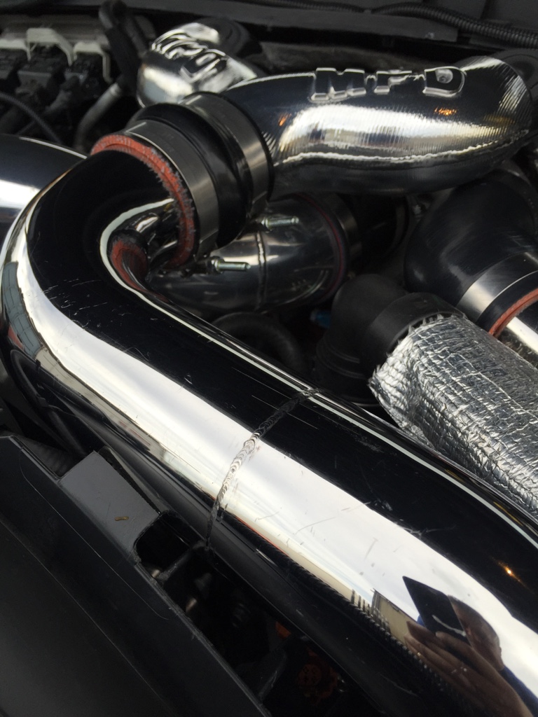

Not a problem. Cut 1-1/8" out of the pipe and welded back together and now we have a perfect fit. I was able to make several test runs over the weekend and never had any problems with the hoses or connections coming off even at peek boost at 53lbs.
Everything has come together and I think we are finished with this setup.
Could not be happier with the results of the 367FMW. Ended up with 12.6 1/4 with 671HP in Craig's Race tune. My daily driver Tune settings are 615/627/643 HP and the mileage is not bad. I have seen over 17 @ 70mph on a trip if I drive very conservative on flat ground in FL. I tow quite a bit with a trailer that weighs more than 17,000lbs. Tows real well and is very clean.
