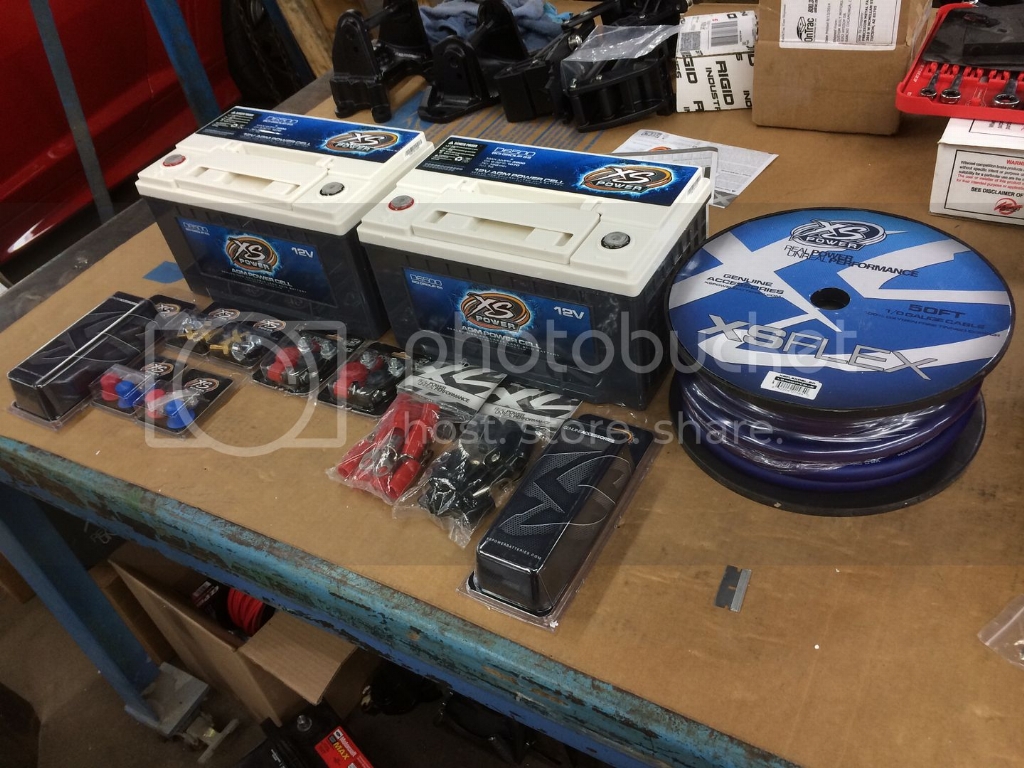

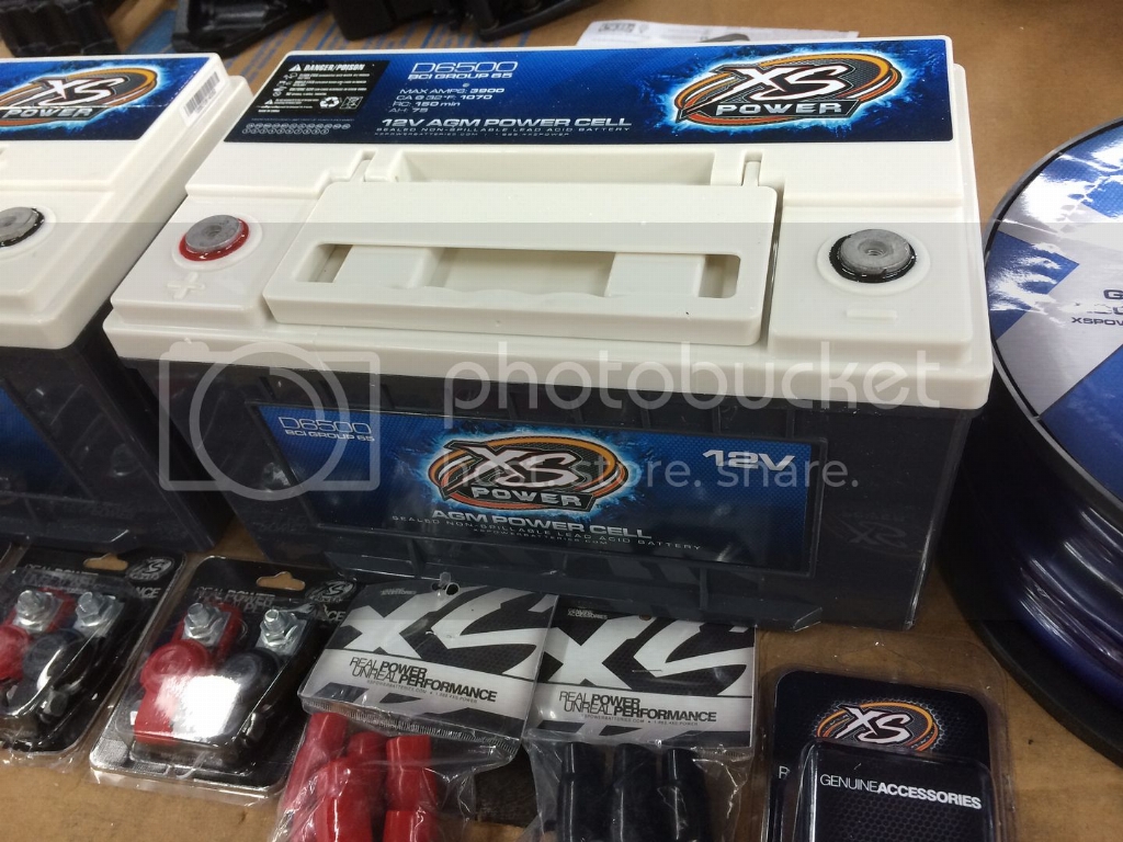

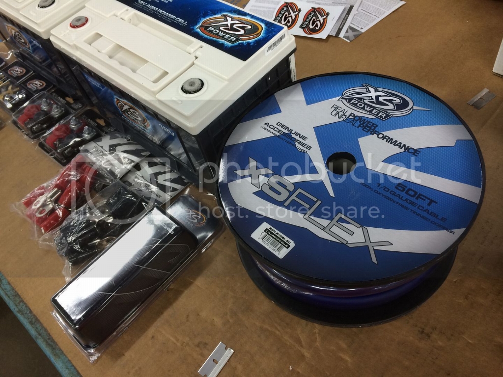

Some XS power supplies made it for the truck, if you could guess I bought it all from Josh again at the diesel cartel. Some real nice stuff and should make for a very clean, easy way for us to run our main power feeds around the truck.

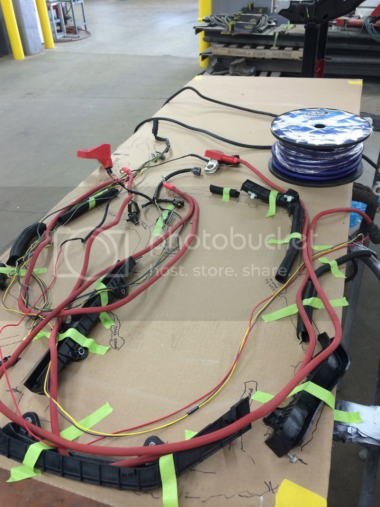

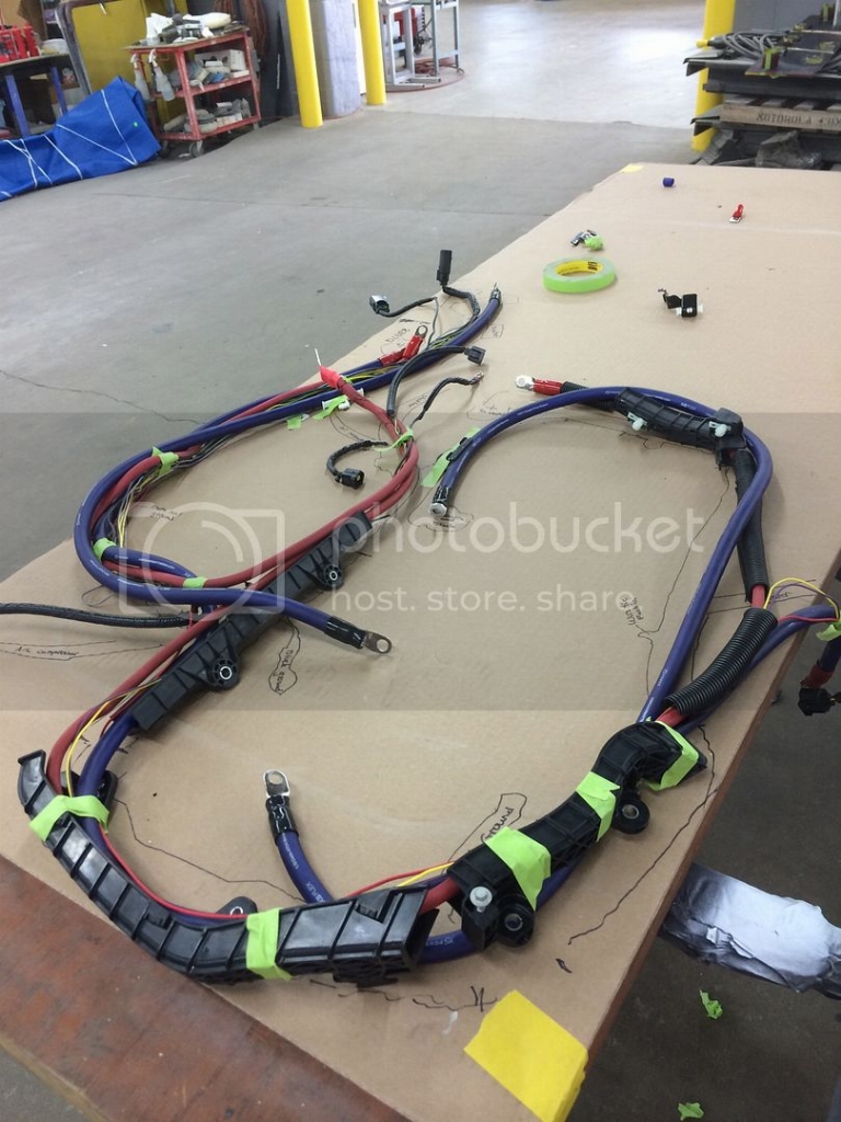

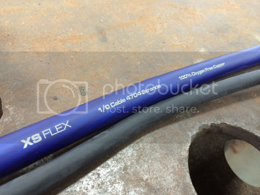

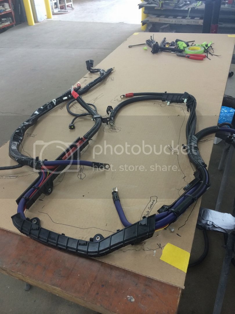

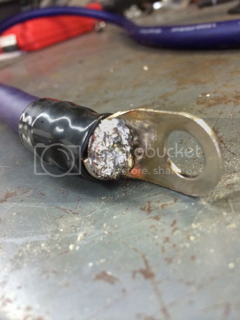

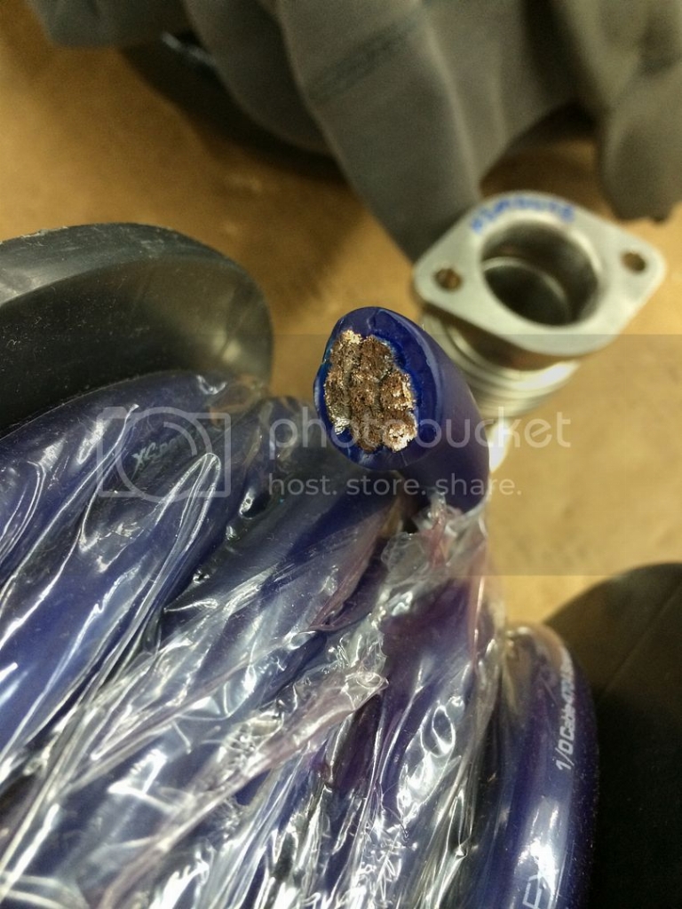

The main wire harness off the alternators to the batteries along with the grounds were all upgraded to 1/0 wire. We'll be adding around 250 additional amp draw when everything is on so we'll need some healthy wire to survive. This wire is 100% oxygen free so it is rated to carry around 400 amps for the lengths we'll be using it in. I figured best do it right from the start because once the engine is back in there is no chance of rewiring this harness. A high output alternator from DC power inc is also being built right now.

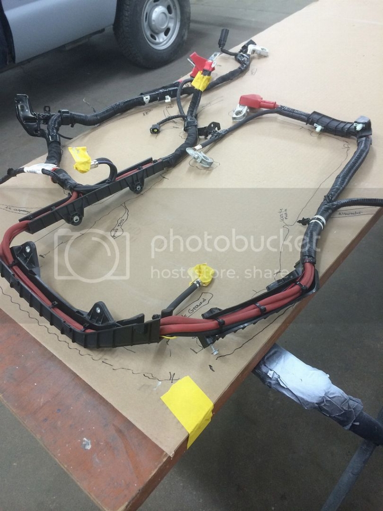

I was pretty worried about keeping the harness in the right proportions because once everything was stripped things got a little wild. Tracing and marking every wire on the cardboard proved to be a life saver as you can see,
Crimped and soldered!
This is that time consuming work that needs to be done, I have seen other "sema" builds that throw numerous light bars at the trucks and do nothing to the electrical system. The main wire was glowing orange, not good.

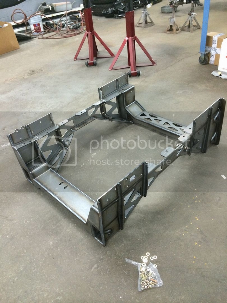

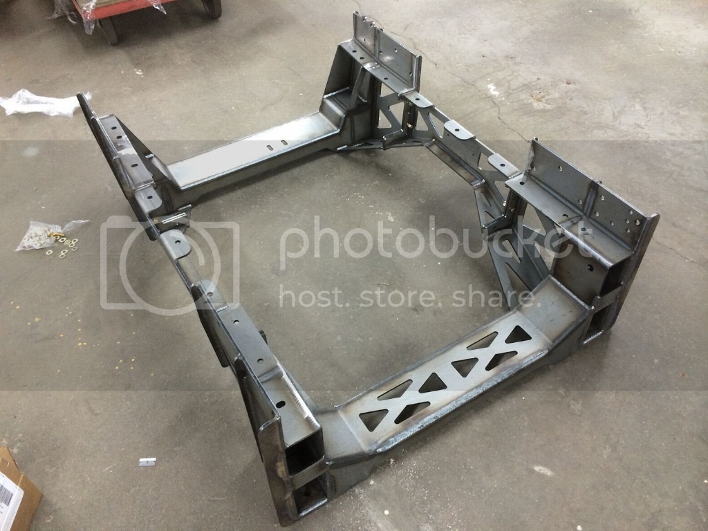

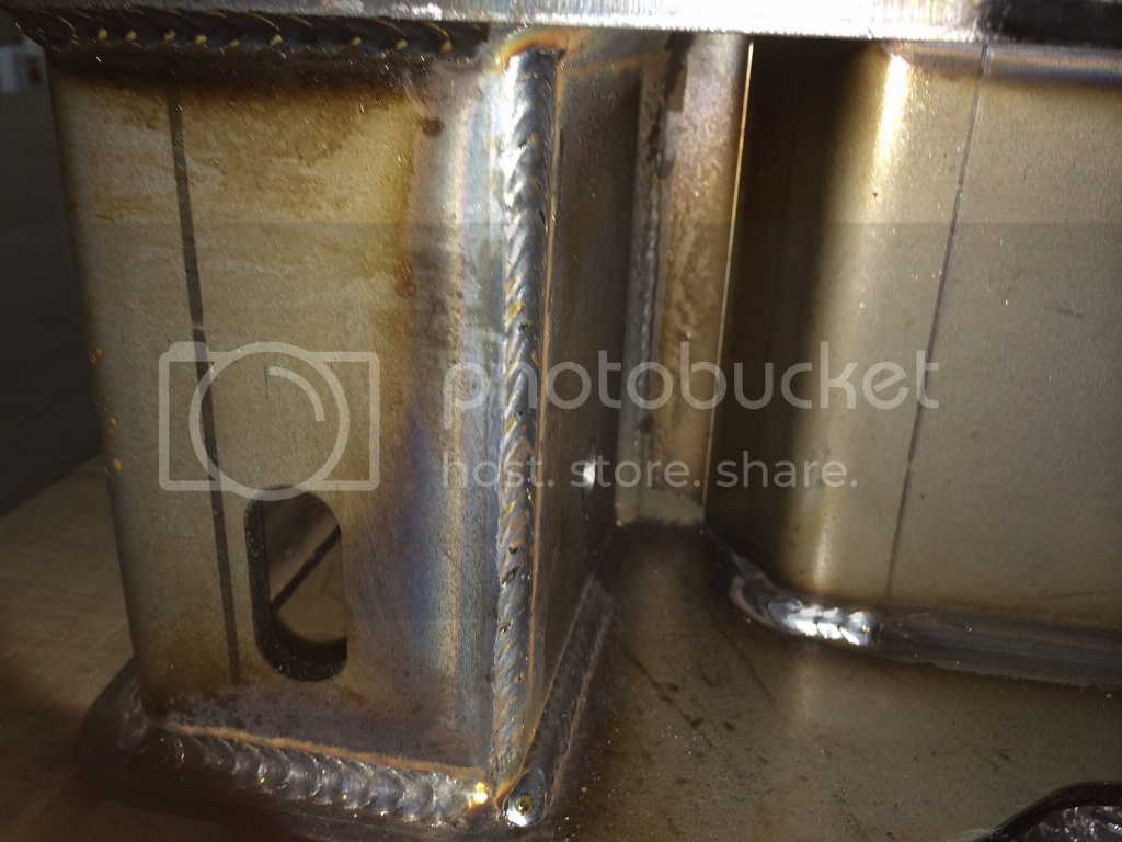

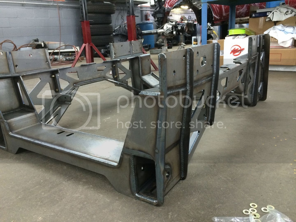

A lot of work going down lately, we've all been working a lot on the frame mainly. I'm trying to post whenever I get a minute, anyway the main focus for the rest of the time remaining is reassembly and painting. The cab is all buttoned up, all the motor work is done. The remaining lift pieces are set to show early this week so the race is on. First take a look at this masterpiece, Trevor has some insane skills and talent that rarely get seen. This subframe is the heart of this lift. The design and welding time to get this thing built is ridiculous, the freight delivery driver wanted to push, yes push it off the end of his truck. He said it was just a pile of metal parts, :clapping:.
This subframe is a monster, check it out,
:drool:

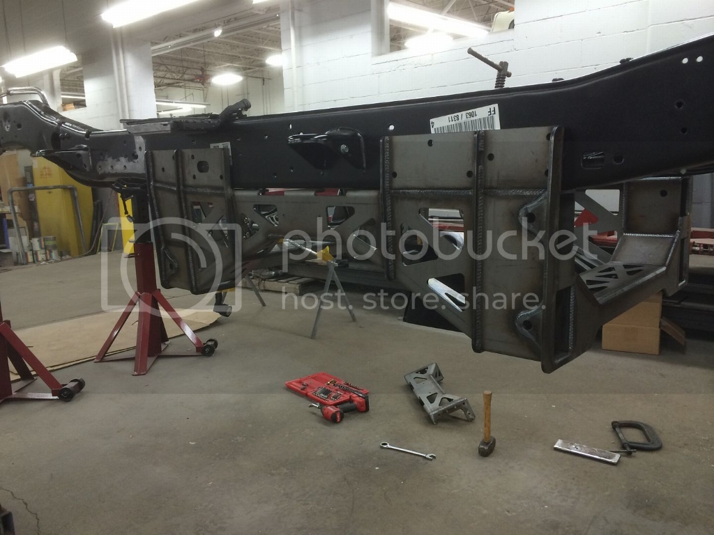

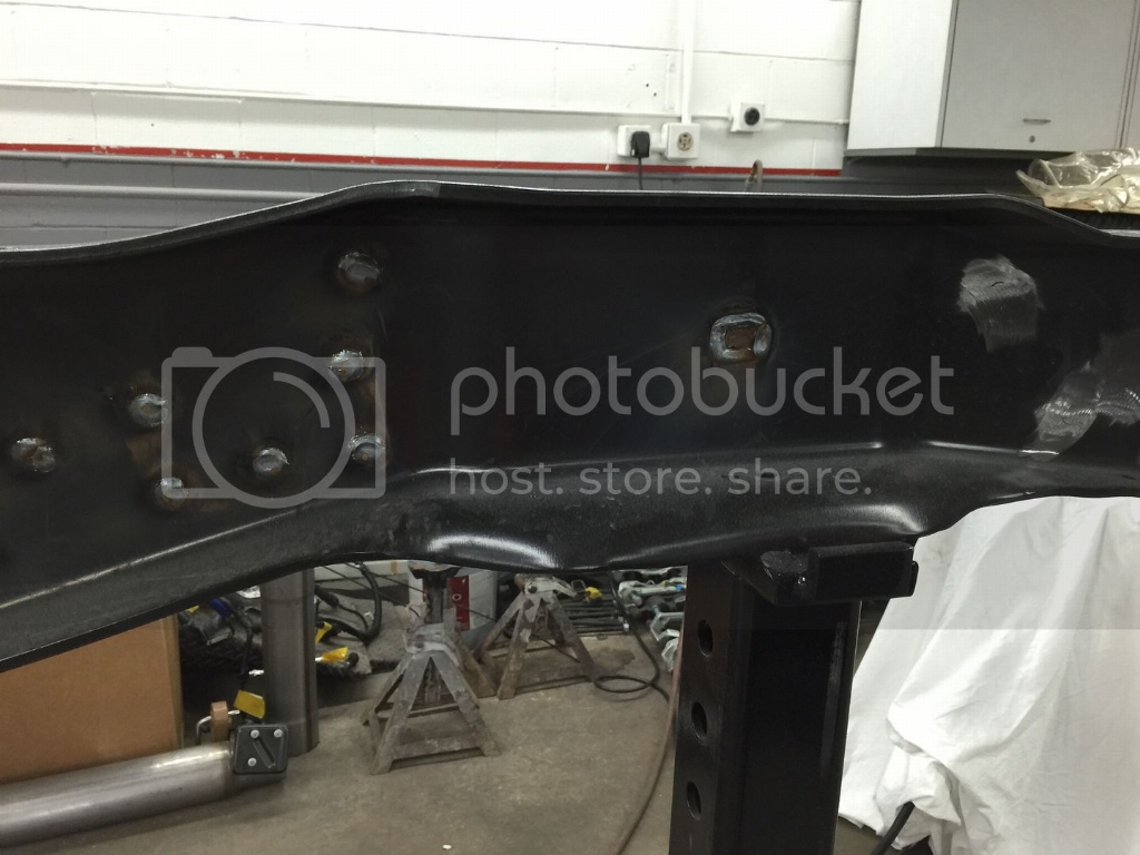

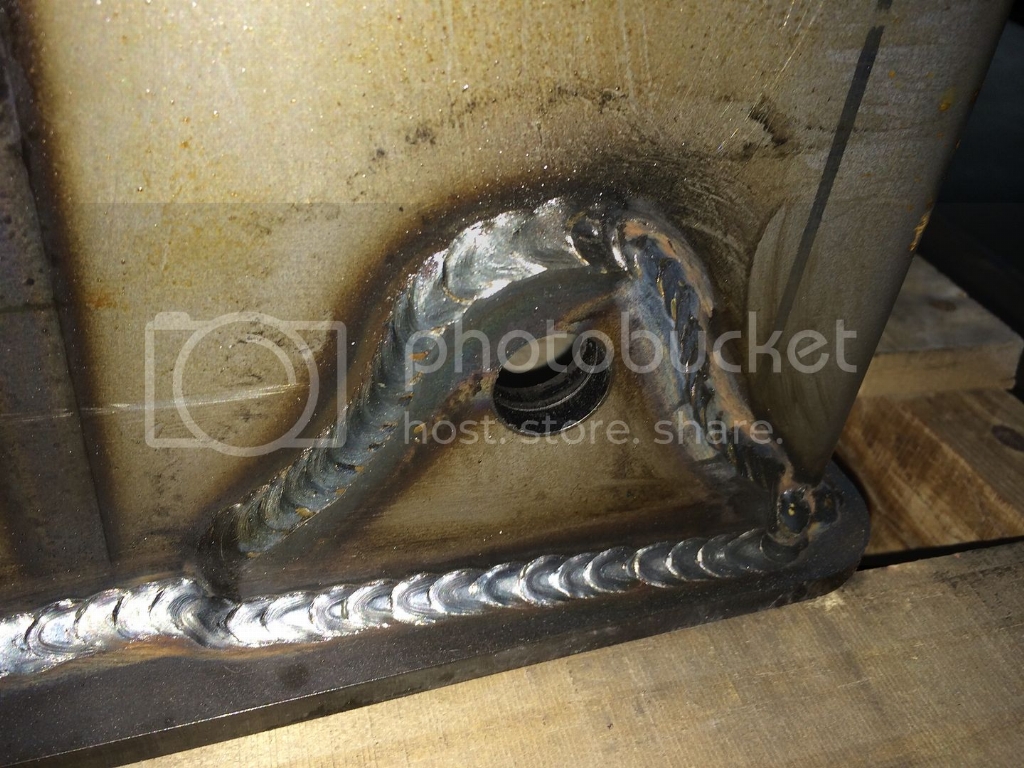

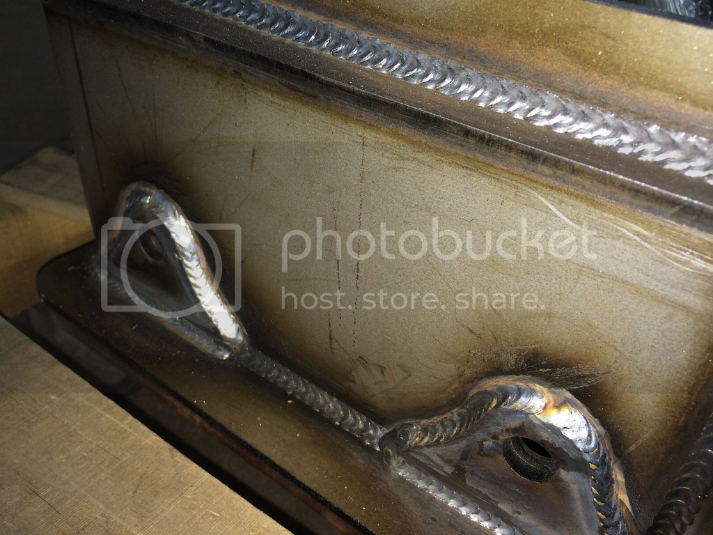

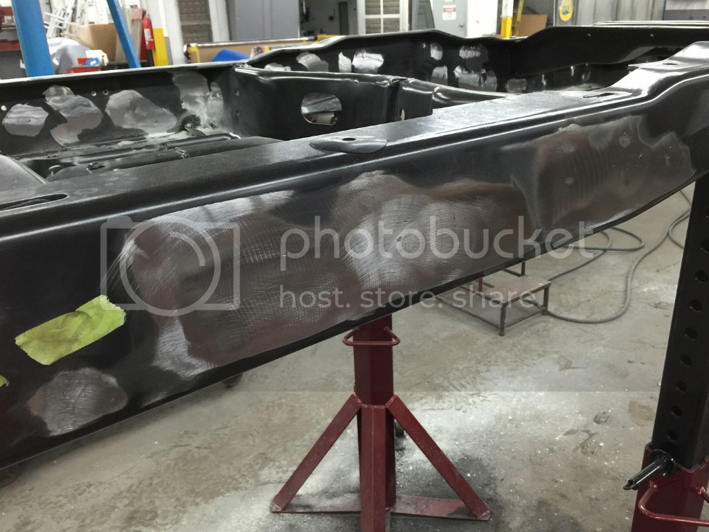

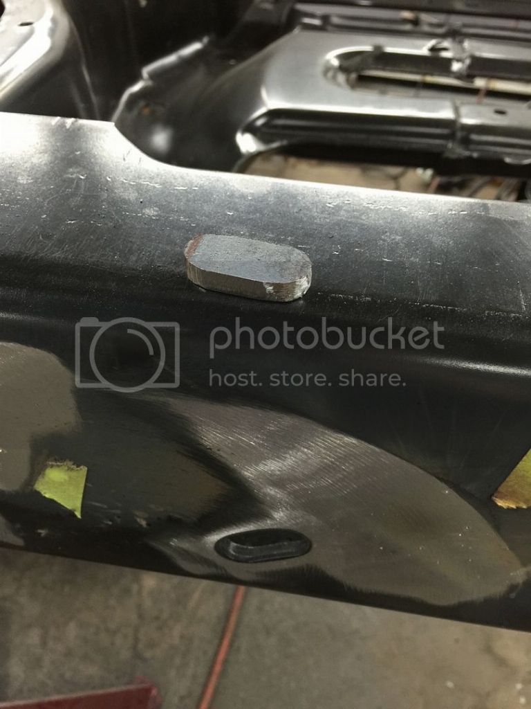

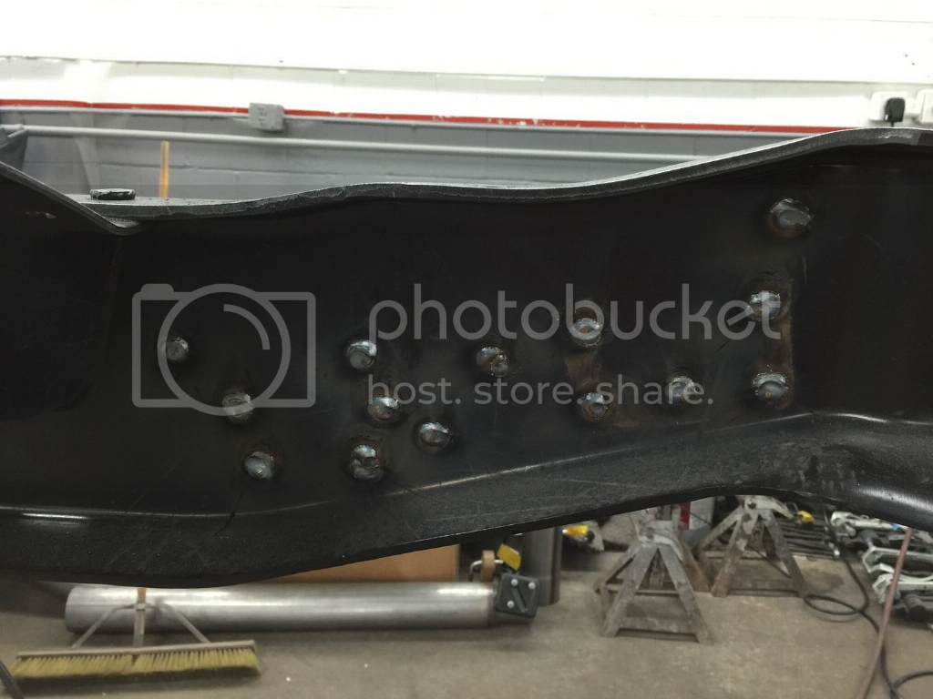

Frame time, what a chore this beast is/was. We fitted the subframe and drilled all necessary holes for that early last week. Then the welders came out to start filling the insane amount of holes, the larger holes had to get plugged with metal slabs ground to fit each hole. After that hours and hours of grinding, filling, sanding, refilling, sanding, priming, sanding, final body work filling and then paint.
