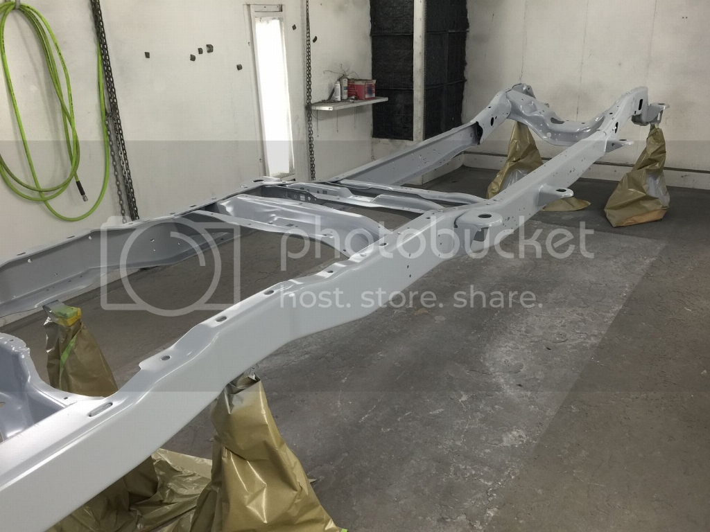

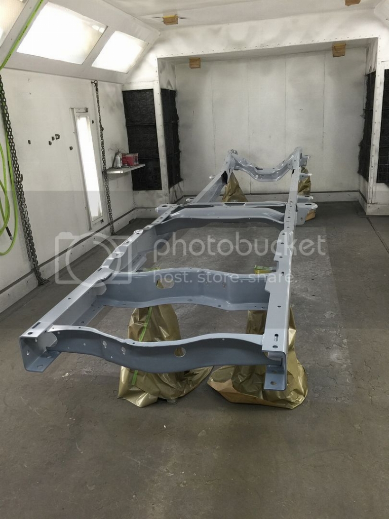

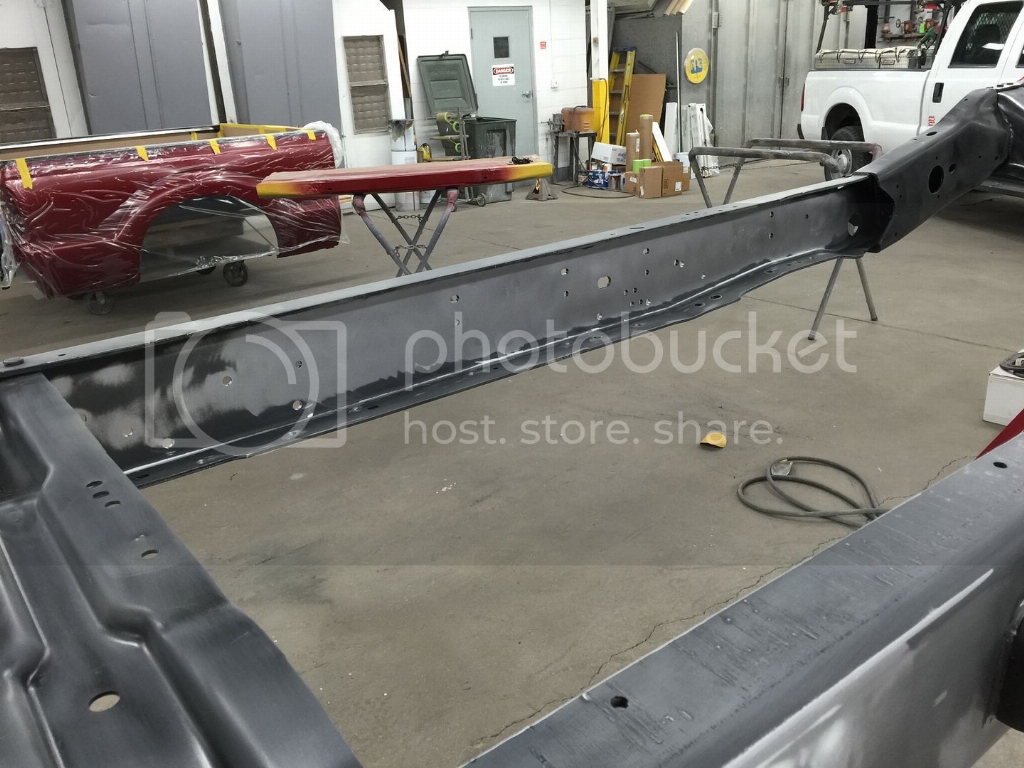

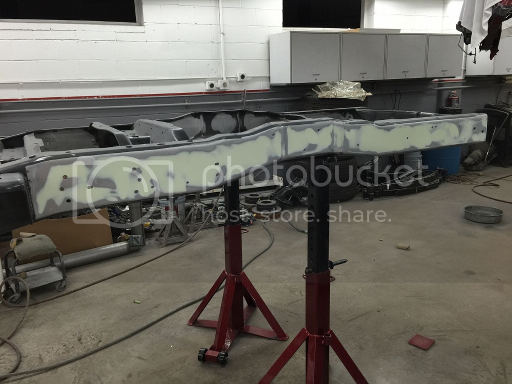

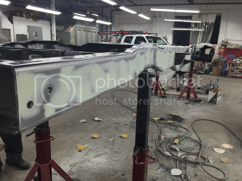

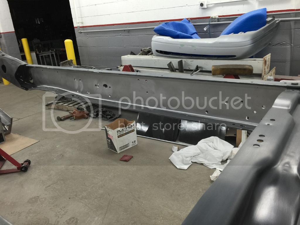

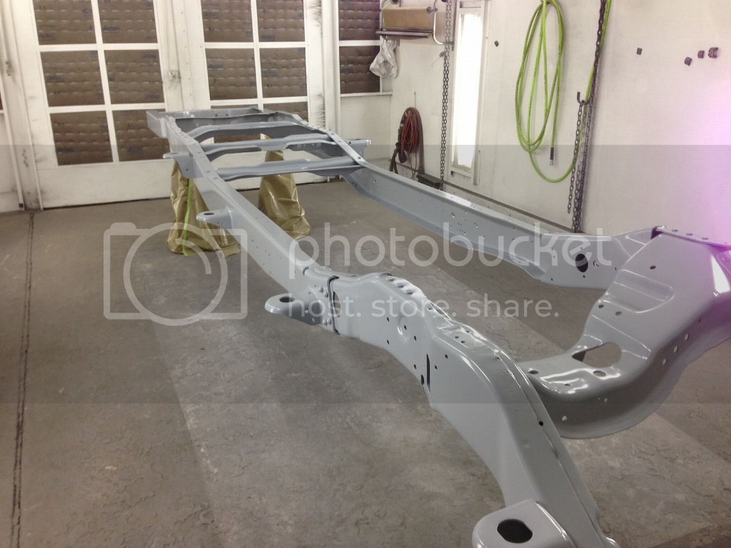

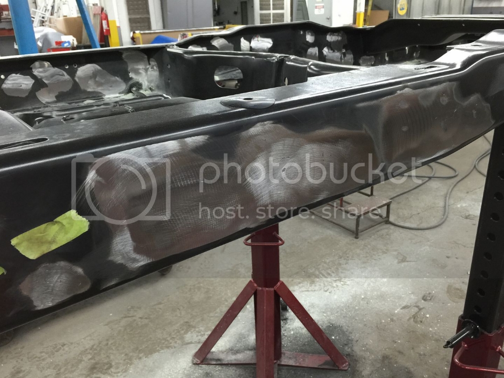

Frame time, what a chore this beast is/was. We fitted the subframe and drilled all necessary holes for that early last week. Then the welders came out to start filling the insane amount of holes, the larger holes had to get plugged with metal slabs ground to fit each hole. After that hours and hours of grinding, filling, sanding, refilling, sanding, priming, sanding, final body work filling and then paint.

Getting after it,
Spare tire carrier cut out to make room for a few air tanks,

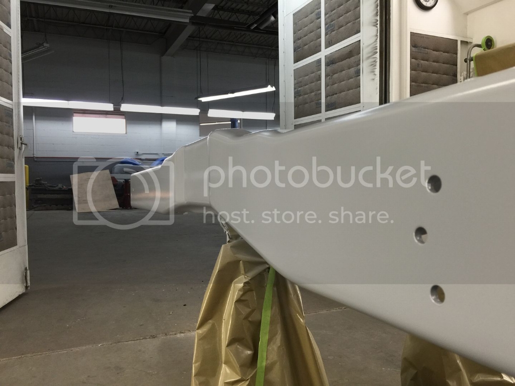

I wish I could say this was ready for the final paint, we primed it after all the body work and blocked the rails with 320. Random pin holes throughout the frame were filled again and sanded back down. Ready for paint!
