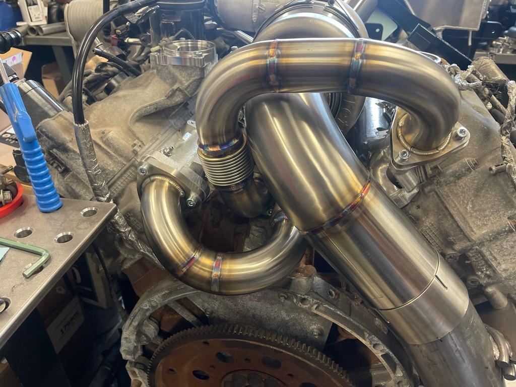

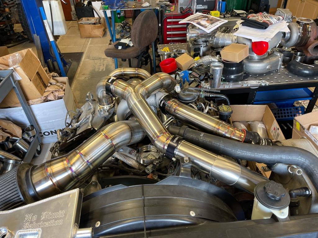

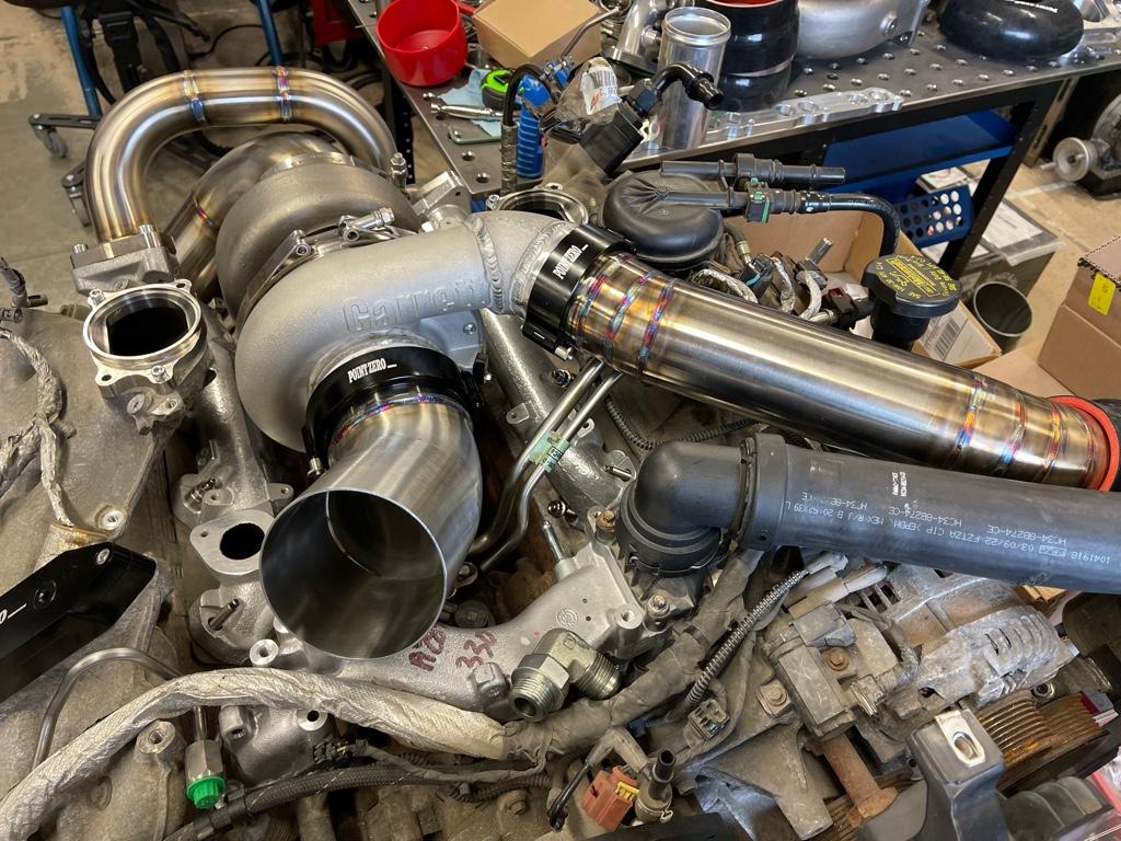

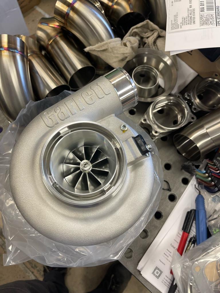

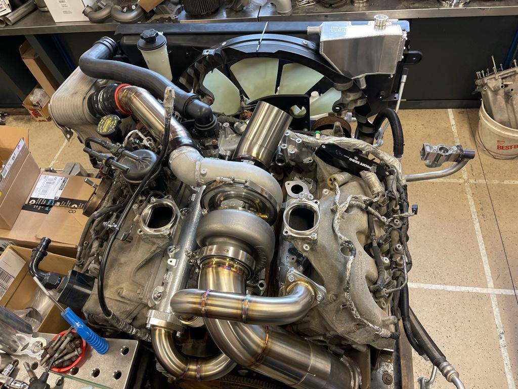

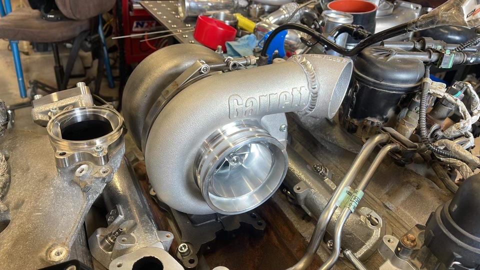

Pics of my Garrett NON VGT kit that Shane built for me. Turbo is Garrett G40, 62mm compressor, 70mm exhaust side, dual ball bearing, T4 divided housing with a .95, SS exhaust housing and its water cooled. Pedestal is from H&S, whole kit is 304SS
