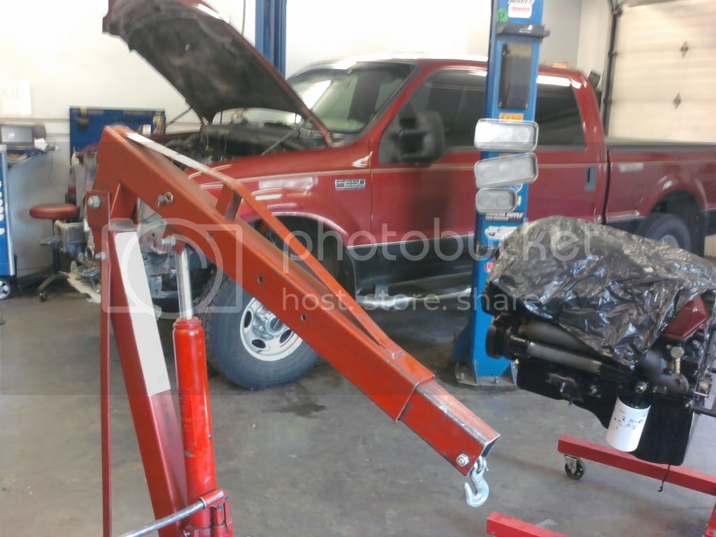

Hmm, plastic bag over motor, indoors.
No shots of turbo setup anywhere.

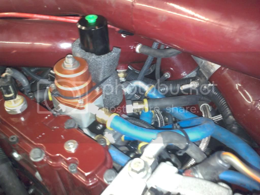

Well, still sorting through a few issues.
First problem was with my alternator, I had installed a 200 amp alternator kit into my original alternator and replaced the rotor as well. When the truck is running the battery light was dimly lit, and the alternator was only charging at ~13.2 volts. I unplugged the regulator and the battery light when out (like it should), but the voltage jumped up to the mid 14's....WTF? How can alternator charge without a regulator? Called up the alternator company and they are shipping me out another regulator.
Second issue, and the one I need some help with.
The fuel pressure was bouncing around pretty violently with the new regulator, almost 20psi. My first though was that the regulator is simply too big and the poppet just cannot easily control pressure at a volume much lower than what it is rated for. I called up Fuelab and they said the pump will be fine under these conditions. I could have left it at that, but I could not take the sound the pump made.....it was so violent that the fuel lines were bouncing all over.
Aeromotive said its not the regulator or the pump.....its cavitation......huh?
Why does is only do it with this regulator and not the previous one?
This evening I had planned to put a piece of clear hose in the return line to verify, but I could not find any around the shop. Instead I plumbed in another regulator after the big one.....and bingo.....fuel pressure was silky smooth again.
This disproves the idea that the regulator is simply too big, or it would not change with the other regulator downstream.....or am I missing something?
So in the meantime I pulled the adjusting screw out of the big regulator and used the second regulator to pull the fuel pressure up to what it needs to be.
Any ideas or direction I should take to resolve this?

Forgot to add that I had flipped the switch to run the pump at full speed and it made no difference, almost seemed more violent.
If it smooths out with the second regulator installed - it could be a "catch" in the movement of the big regulator - I would crack that puppy open and look for defects. I recently was working on a truck and installed a new fuel system - the damn thing wouldn't build pressure for nothing - no matter what I tried.... I ended up disassembling the regulator and found that it was "locked up" - cleaned up the parts - put it back together and it ran like a champ. This regulator had already been used on this same truck in the previous system it was running without any issues.
907DAVE
2,166
AK
That was the first thing I did, could not find a thing wrong with it.
