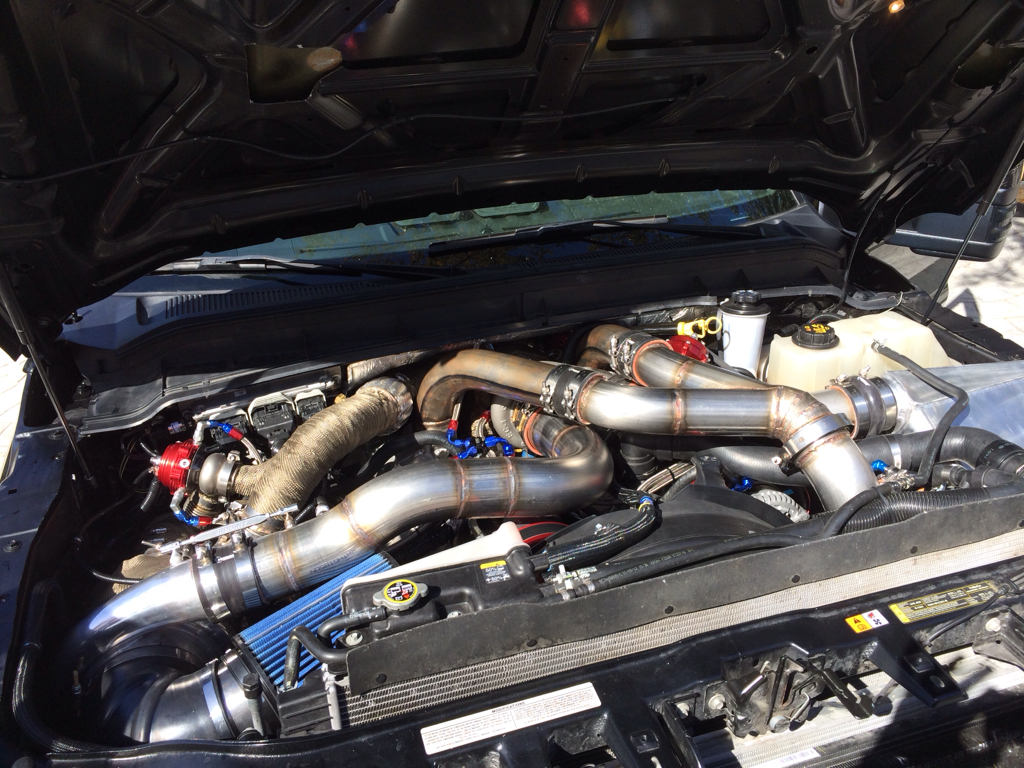

But could it? Like if someone copied your build
Sent from my SPH-L900 using Tapatalk
My single 66 towed 13,000# 500 miles this weekend. Never broke 1,100 degrees. So I don't see why this couldn't tow anything a stock one could times two....
And I love the turbo sizing, kinda what I was thinking you had.
And for the rest of the guys doubting the charger sizing, how many can say they drive 800 true rwhp that lights instantly and is totally smokeless? Just because it may not make 1000 hp on fuel, who cares? Something everyone thinks you gotta make 1000........
Off my rant. My hats off to you guys, very well done. It's gonna have way more power than you can ever use on the street. Which means it's gonna be scary fast!

This setup would be awesome for towing. Instant boost with zero smoke output and more power than you would know what to do with. The truck still has a receiver hitch. So to answer the "could it tow" question, yes by all means.
Thank you Morgan for that post. 100% accurate.

I really like the raw look too. Makes it look more serious vs dolled up.

When I get ahold of some stainless intake pipes I will probably leave them raw. I am liking the raw look with polished compressor covers and intercooler

Seeing yours makes me think harder about getting my comp covers polished. Would help distract the eye from all the piping.
Looks good man.

that thing looks like a blast to drive. i bet it has a smooth and flat power curve.

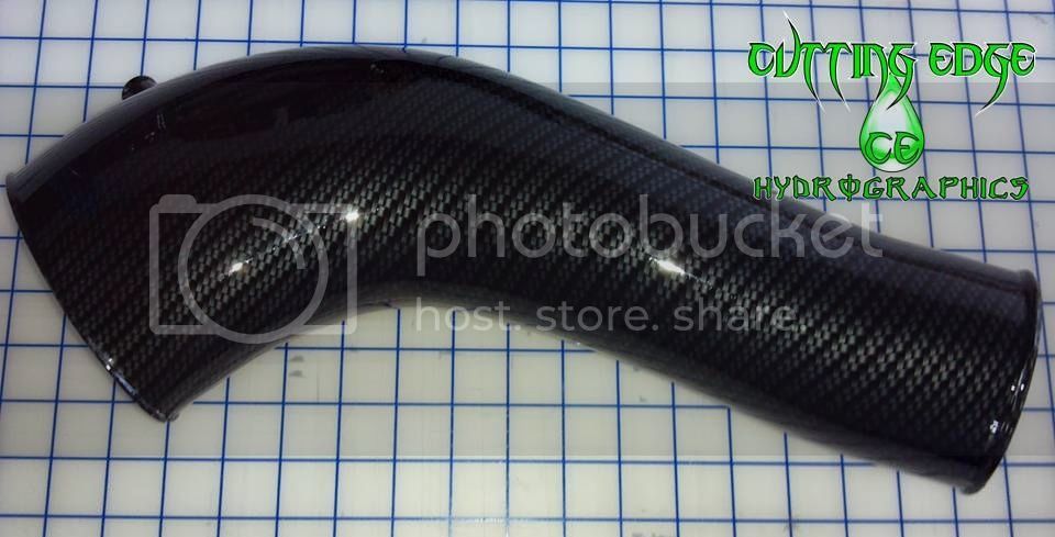

I do agree that the raw steel good but at the same time it kinda looks unfinished, don't get me wrong the work done is amazing but I personally think a finish would be nice. If it were my truck I would hydro dip the piping with this skull mattern. I also think the carbon fiber wouldn't be bad
