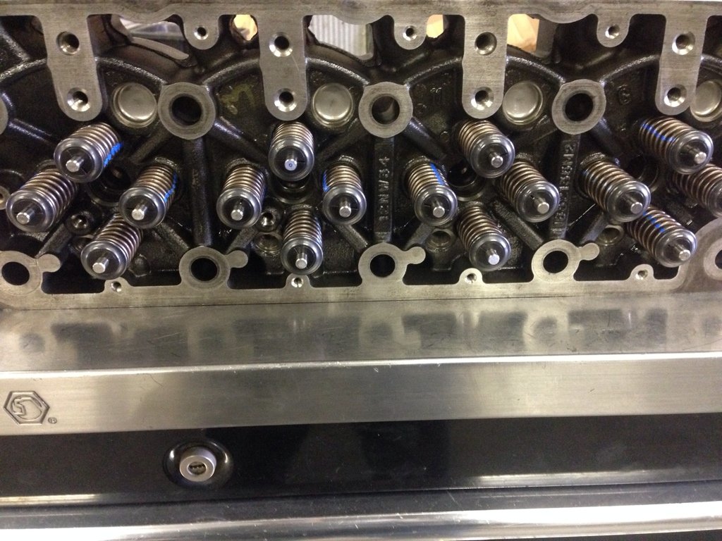

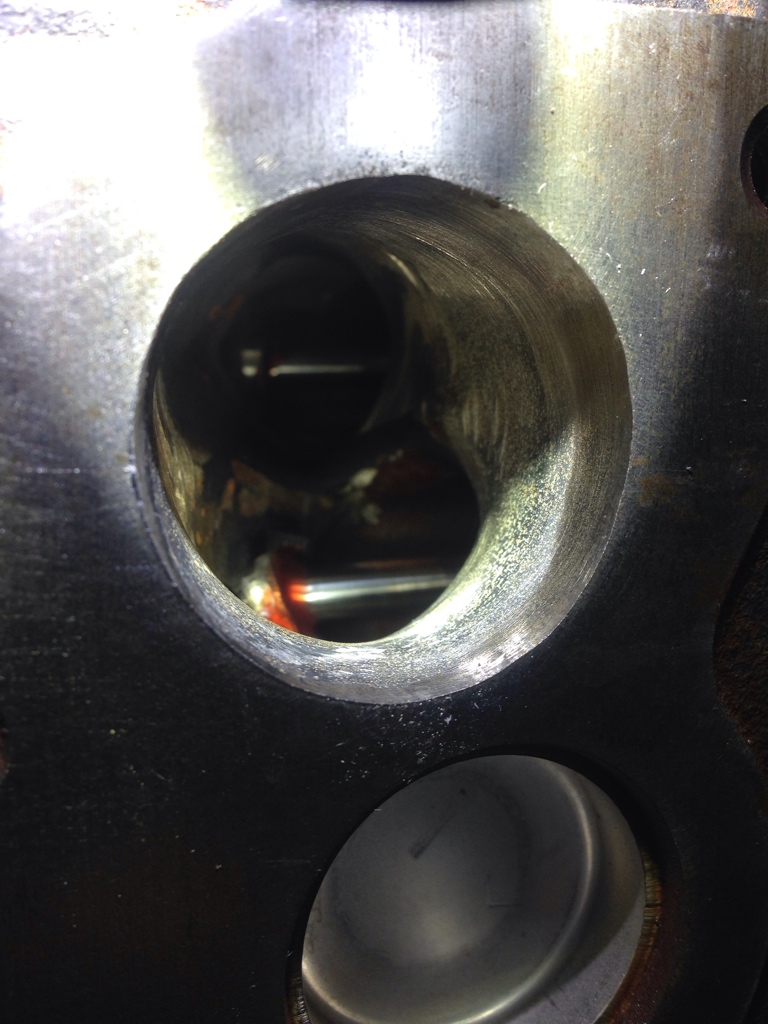

Specs on the heads are, our full competition porting- plus a little extra, new valves, our springs, bronze guides, hardened seats, our chromoly retainers and locks. Ohhh and moroso block filler.
