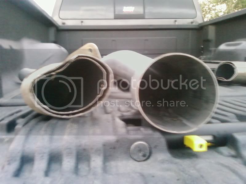

OK, then do I even need to do an exhaust then based on Corb's answer? Sounds like it only changes the sound?
do you have the stock downpipe on or an aftermarket one?
if its stock, id do a full 4 inch to get rid of the stock downpipe...its so crimped and smashed that upgrading will help...stock downpipe (left) aftermarket (right)

I have the stock exhaust with only a delete pipe. Thats a great pic showing the difference. I think I'll do like you suggest and go with a full 4" kit. Thanks for the help!
Damn, I never really looked at the stocker.... That thing looks horrible...
