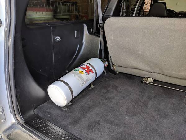

Thanks guys. Also, I figured I'd mention I put it in the unlimited class for the dyno competition at weekend on the edge. The local 2000 hp dyno queens were all recently blown up, so I ended up swooping in, and won the unlimited class. Too bad they don't read torque. I uncorked the nitrous system, and shot it with oversize jets through 2 .120 rated solenoids, after purging. Seemed to work pretty well. The number is SAE corrected.

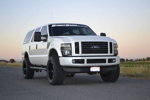

Here's a current pic of it. I changed up the tires and wheels since I got bored of a set I've just about worn out between my old posts and now.
