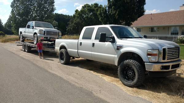

Not a very good pic, but these are the tires and wheels for the project. They're 20x10 bmf novakanes I've had for a few years, and tires are 35" Dick Cepek Extreme Country. I just gotta finish the lift on the truck so the big tires can go on, and I can save these tires for the ex.
Here's the current state of the ex, minus the tires. It's got some stock wheels with 35's as rollers for now. I just had to throw on the 40's I got for my truck as perspective since I'm waiting for my lift to get finished up at OUO.

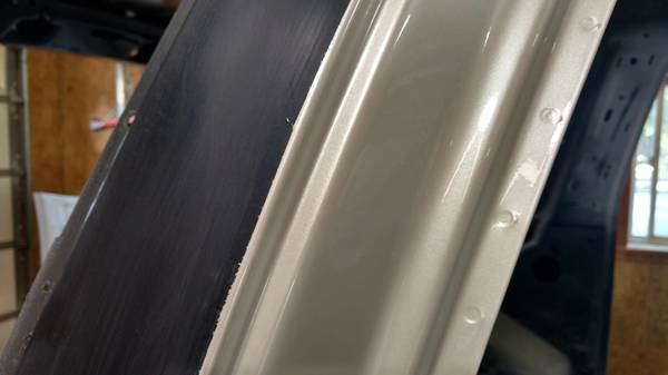

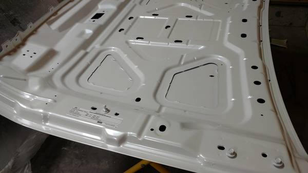

Between the last couple weeks I've been able to find enough time to paint all the jambs including inside the fuel door, fenders, doors, hood, and rear section. I put an extra coat of pearl on, so it's more noticable that it's not just a generic white; kind of like gm's white diamond color. I'll do the same for the rest of the paint process. The pics don't do a very good job of showing how it looks in person, but oh, well. Over all I do like the color, and my wife loves it, so I guess it works out. I don't know how far I'll make it between tomorrow night, and a really long day Saturday, but I'm hoping to have it sprayed. This paint is tricky enough for me that I'm a little nervous about the pearl flowing properly, so I decided to paint every jamb before the rest of the body, then soft back-mask all the jambs when I spray. That way, I can have every panel final-hung, and in place. I've got to paint the entire exterior of the body at once so I know the pearl will match from panel to panel. Below are a few progress pics. I know they look a lot different in shade from pic to pic, but they're all the same shade in person. It's just how the light and camera react to it.
