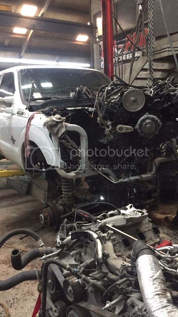

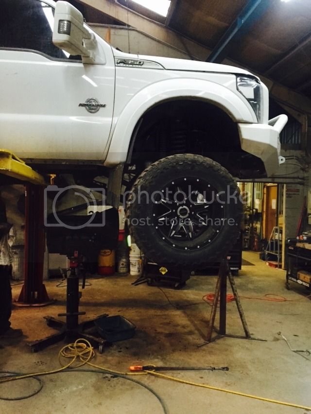

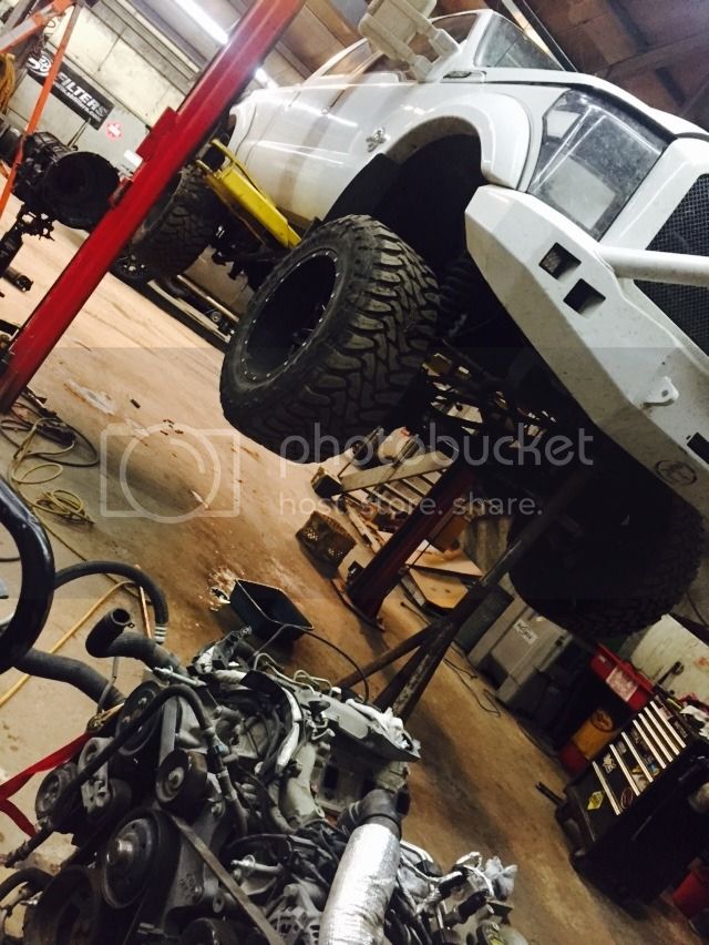

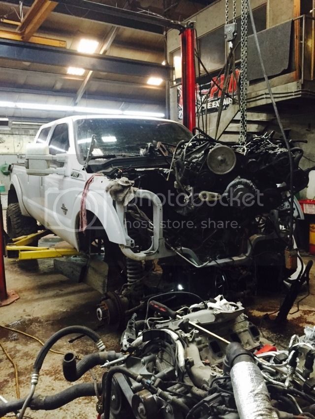

Lots going on today... And finish up tomorrow!
Starting to get fast with these engine swings...

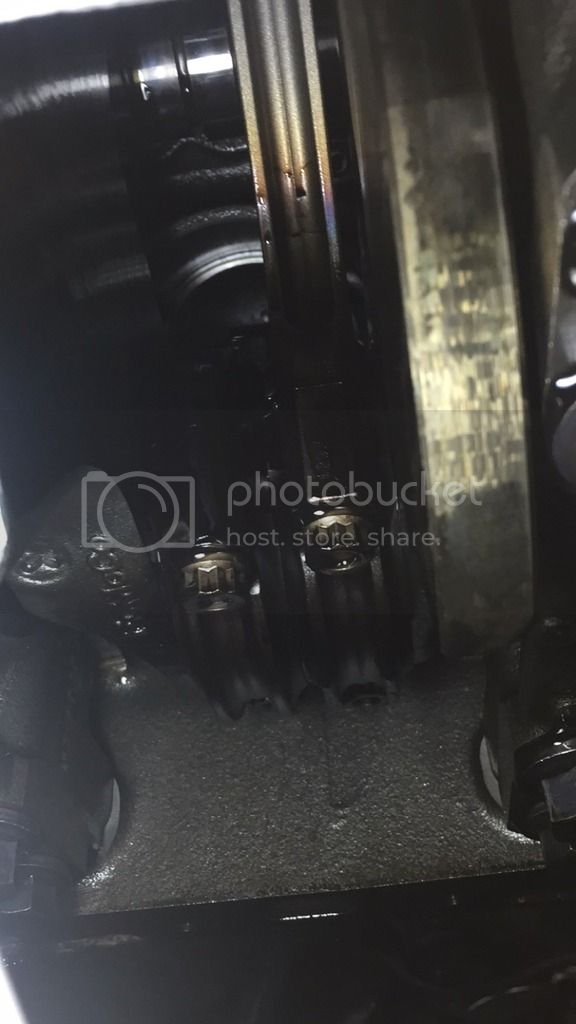

What is with this thing and torching rod bearings?
#1&#4 this time...
So basically the initial set of rods I bought, every single one of them has spun except for 1. I haven't had a rod spin that was purchased after the initial set... Maybe it's time to purchase a complete set of a different brand? Anyone else had problems with carillons? I find it interesting that it's never the same cylinders... Either way... It's better having spun rods than spun mains! So I'm relieved about that!
You can see the heat marks on the rod

Damn... maybe give R&R a shot. I don't think it would have anything to do with brand. I would get a whole new set if it were me and triple check them before you put them back in. Would ease my mind if I had a whole new set for the abuse its going to take.
sootie
11,853
39
hit up Morgan @ Midwest for his 6.7 rods made by R&R. His truck saw 1300+ hp at 5000+ rpm and hasnt missed a beat.

*1&5 cyl
I was eyeing up Morgan's short block...
Kinda waiting for the OT to start flowing again before I make anymore engine purchases...
Dang oil prices

the other thing you may want to revisit prior to even driving the truck is the tuning factor. i know that spun rod bearings don't necessarily directly relate to tuning but could fuelling and rpm etc not play a factor in the failures?
Bustedknuckles
Aug 15, 2011
1,503
Yep, too much timing can knock out the upper rod bearings.
