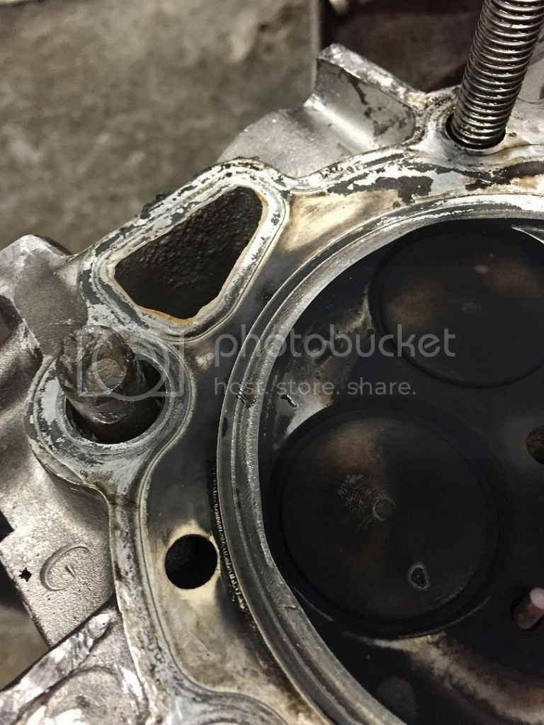

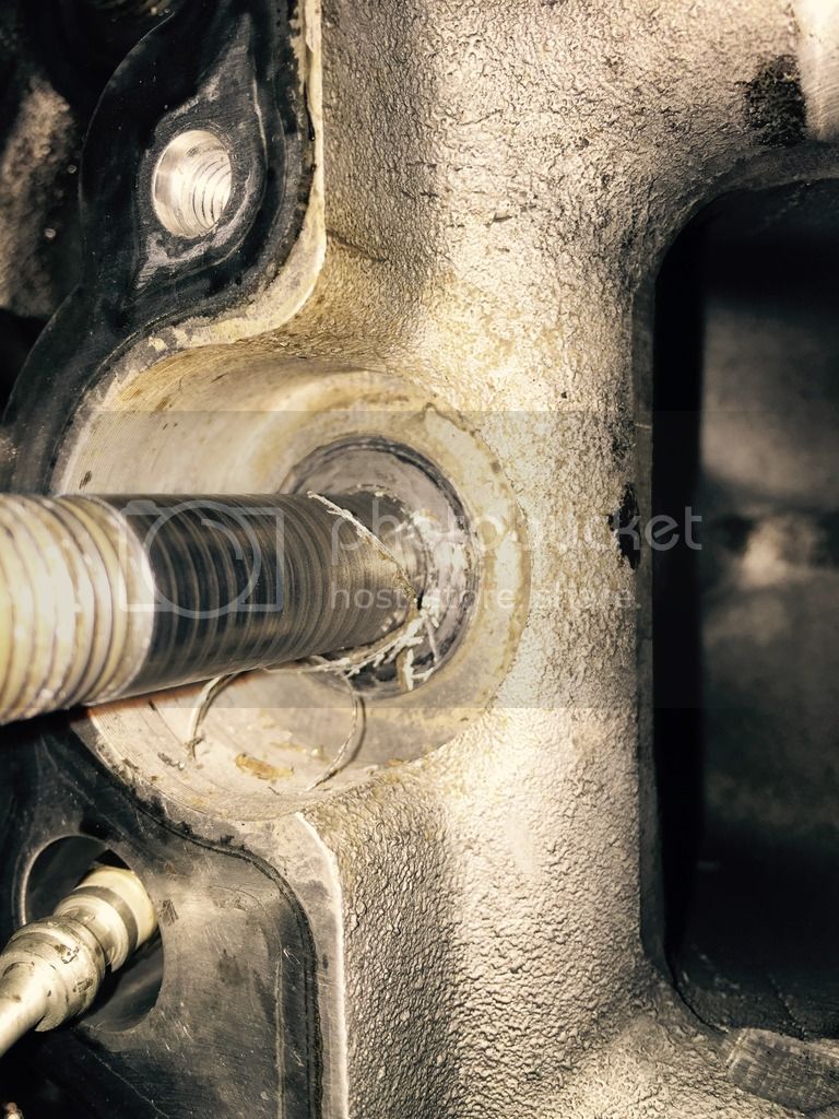

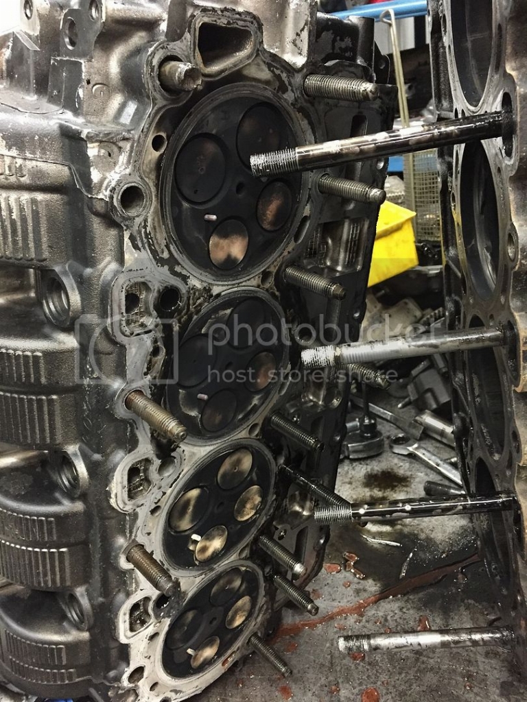

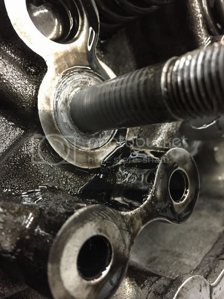

Probably no one cares... But A1 are garbage studs. And here's why.
Might be time for some of mikes extreme h13 studs. Has anyone heard of any feedback on those.
when i built my fist motor those werent done so i used a-1's , ive used them twice so far with no issue.
Dan
Sep 4, 2013
909
Fort McMurray AB Canada
This is the engine Wayne built right?
Yes
Also irrelevant. I can attest to how precise Wayne was going together with this engine. There are absolutely no workmanship flaws.
Send me some info and a "good guy" price if you don't mind please!
Curtis and I discussed the possibility of tapping the block out to 14mm and seeing what options we had going that route. Might be a possibility
