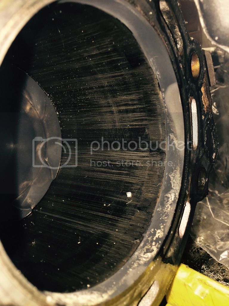

Also irrelevant. I can attest to how precise Wayne was going together with this engine. There are absolutely no workmanship flaws.

Curtis and I discussed the possibility of tapping the block out to 14mm and seeing what options we had going that route. Might be a possibility

I don't know, once stuff started blowing up I quit keeping track. I know before this last engine went in I had well over 125k into the truck above the 75k sticker price...
This is his 3rd built engine IIRC. Two from Elite and one built by Wayne.
1- stock one spun rod after confederate diesel turbo kit
2-confederate diesel built engine (carillos, head studs, valve springs, push tubes) was pulled still running to install elite engine
3-elite full meal deal blew up at dpc (spun rods)
4-elite parts (new block & 3 new rods) assembled by Wayne, blew up first wot run (spun rods)
5-elite parts reassembled by Wayne (new crank and 2rods) (most recent engine)
6-coming soon
Hahaha
engine #5 was the broken oil pump one
So that's basically what's went on in a nutshell
