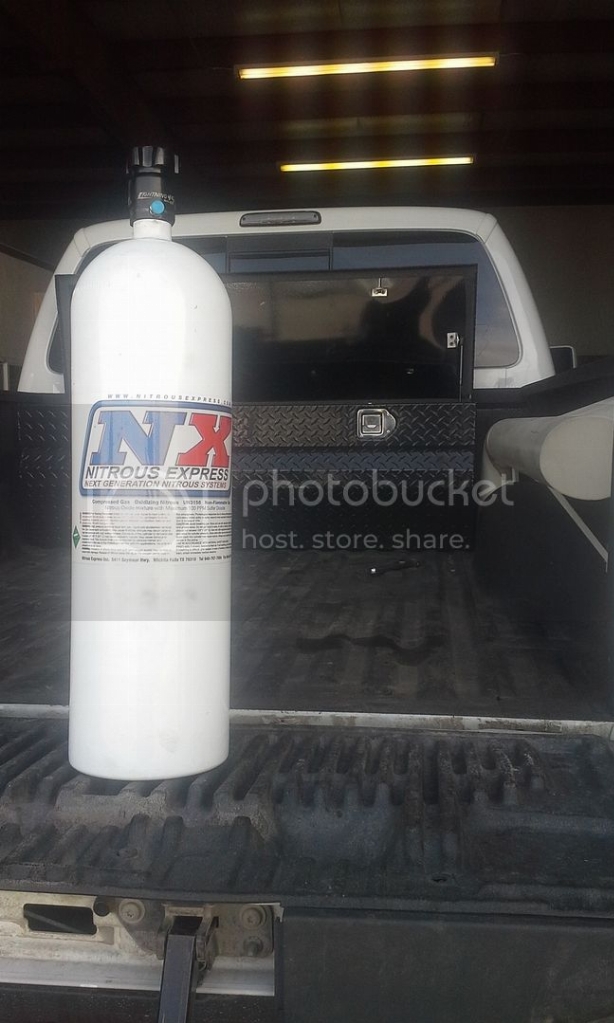

Nitrous pulls anyone???

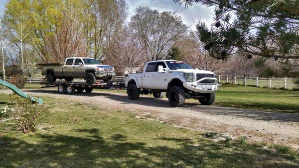

Well, here's to a safe phase 2 of the engine break-in, and bringing my trailer back in 1 piece tomorrow.:toast: Twin Falls to St. George pulling a big load of garbage on the stock tune aught to seat the rings. Too bad we didn't make the time to recharge the a/c :pointlaugh:

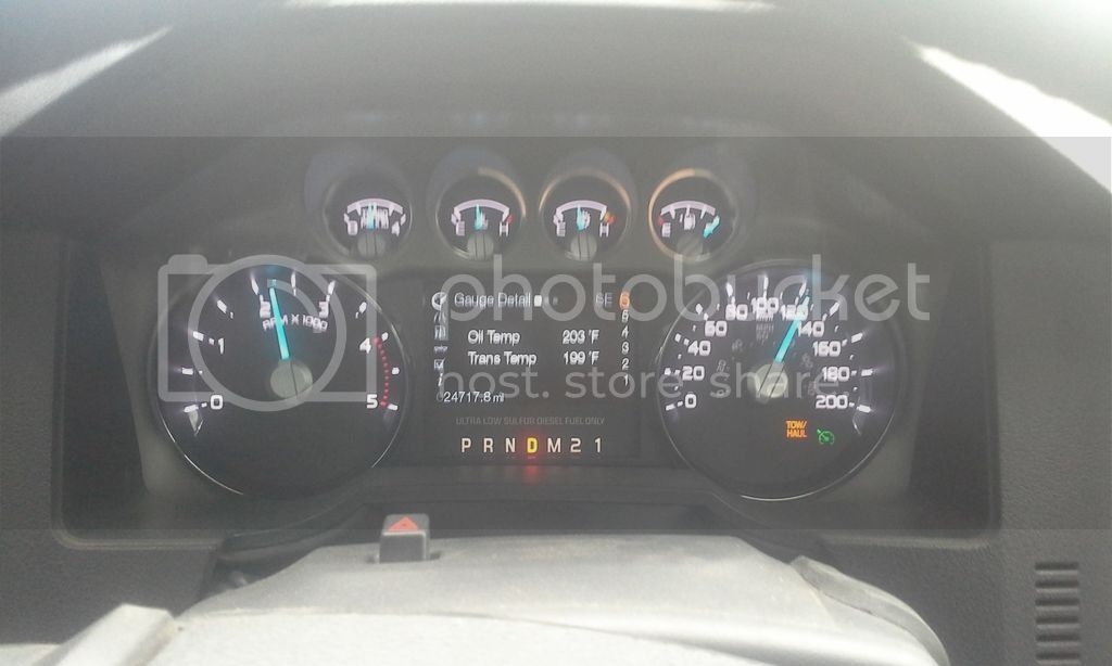

Hahaha yeah I'm sure I'll get a sec to peel the rest as well as clean the truck but it was crunch time as my schedule was way tighter than we planned haha
so I'm climbing in through all these "hills" on the way into salt lake city, truck isn't missing a beat! Tows beautiful!! Im so impresed with how these turbos preforn they just happily sing away! Turbo sizing? Nailed it!!
Oh and a little patato photo
thanks the final push to get the truck done and for the use of the trailer Wayne!!!

where did you mount the aux oil cooler? I haven't seen over 190* yet with my filled block .

No aux. Oil cooler for now. Just a new stock one with no block fill. She's just regulated by the coolant thermostats. He got the fancy oil pan mount bracket, and pulled the plug. I believe something was said about not spending more money on unnecessary parts until after some seat time to justify it.
