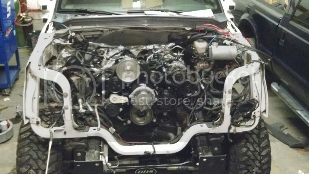

just a quick "patato photo' update!

Might as well stop tightening all the front end and cab bolts all the way down...
Dan
Sep 4, 2013
909
Fort McMurray AB Canada
Confederate had the cab up
and if you want my opinion about cab pulling...
It depends on the job you're doing, if youre just pulling the engine it is easier to just pull grill and rad assembly and the dressed engine minus turbos pulls out the front really nicely with plenty of room
If you're going under the valve covers in the truck it only makes sense to pull the cab
there's a million ways to do it
Also there's a lot of extra wiring etc etc that makes pulling the cab a little more time consuming

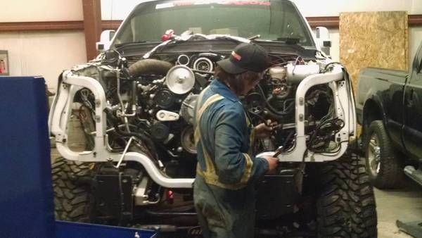

Got me some help today from an illegal immigrant north of the border. Gonna try to have it leave under it's own power shortly
Wayne
2,540
8
Twin Falls, Idaho
so far, so good. it has an intermittent charging problem that it had before, and still has we're chasing down. The electrical harnesses were changed significantly when the turbo kit was done, so it's taking a while to pinpoint were the suspected short is. Whenever it quit charging on the test drive, all we had to do was hit a bump just right, and it'd pick right back up. Now to do a wiggle test & ohm out the signal wires to the pcm and high current junction block. Probably a spread loose pigtail connection, or something simple. Gotta catch it in the act though.

Up late, found a loose ground connection and we have a consistent 14.4v. Feels good to be behind the wheel of this thing again even if it'll be just for a few days! Few minor things to iron out but so far very Iimpressed with this new engine! Hasn't missed a beat!
