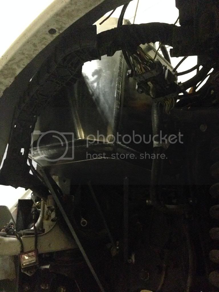

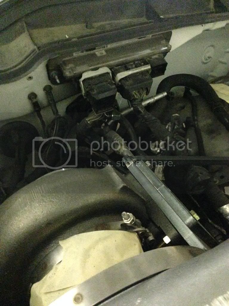

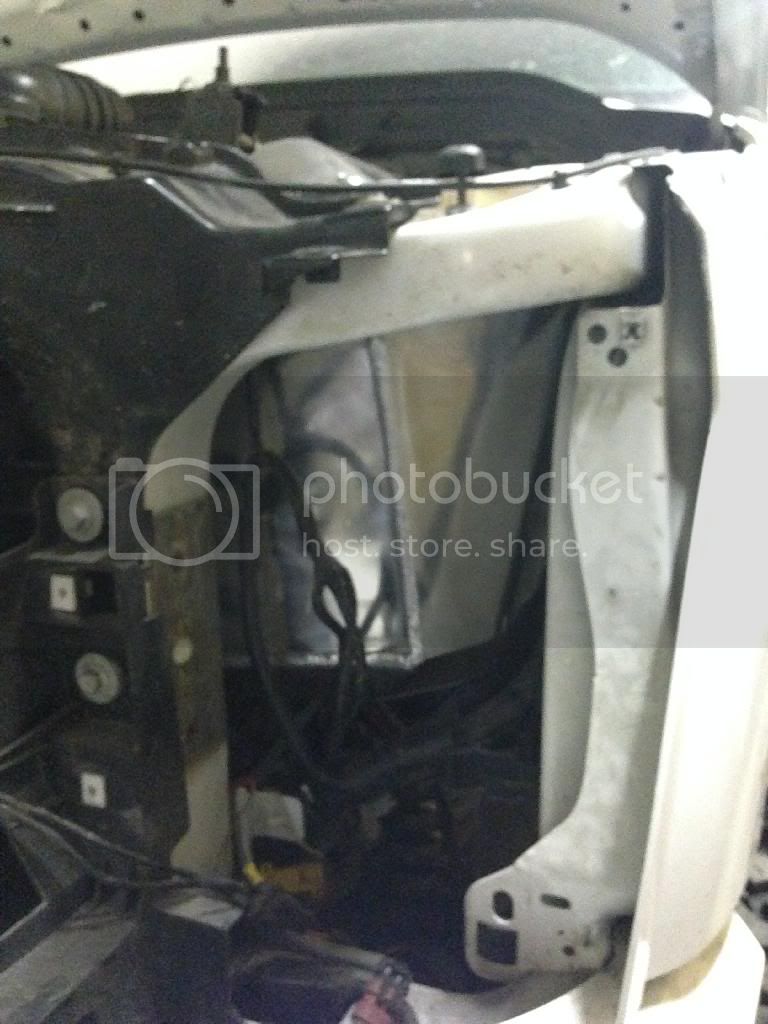

Dutton has the type 54 frozenboost cooler mounted in place and the gtx 55 mounted all decently! Starting to look good!!! We are waiting on a .85 housing that is being cut to fit the gtx 42 in there for better spooling! I'm SOO pumped you have no idea! It all seems to be coming together even with the truck still half appart! Injectors, modified pumps everything at custom auto ready to go

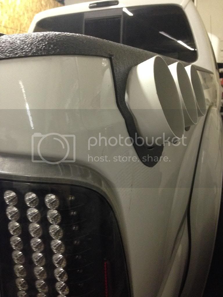

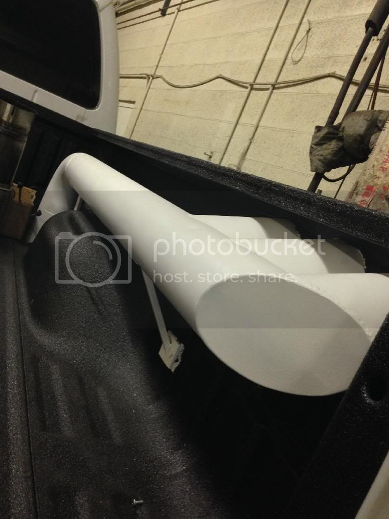

I think the exhaust looks awesome. I definitely enjoy seeing new creative spins on builds. Congrats on the email! Wish you guys the best of luck on the build, and in the competition!
Hahah thanks! It's one of a kind that's for sure! Except those guys at custom auto have a few trucks kicking around like that! Hahaha

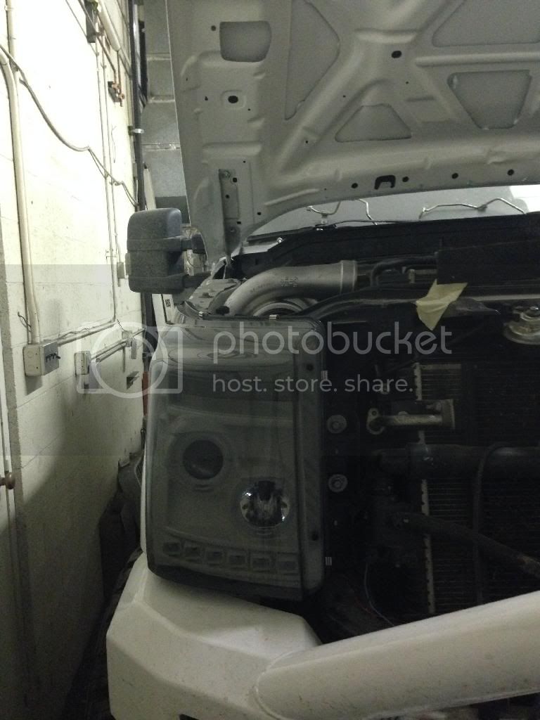

So just a quick little update! I stopped by custom auto on Friday and hung out for a few hours! Took off my mirrors to get painted and some small stuff like that! We are waiting for a .85 housing to stuff the 42 into and a certain 55 hasn't shown up yet! Something I didn't anticipate is when we pulled the trans out to send to elite the engine is rotating on the motor mounts and it's hard for dutton to do all his plumbing without a definitive placement of the engine! And with the tight clearances we have with piping it would be awkward to have the twins all piped in and the engine to sit different causing clearance issues when the trans is in!

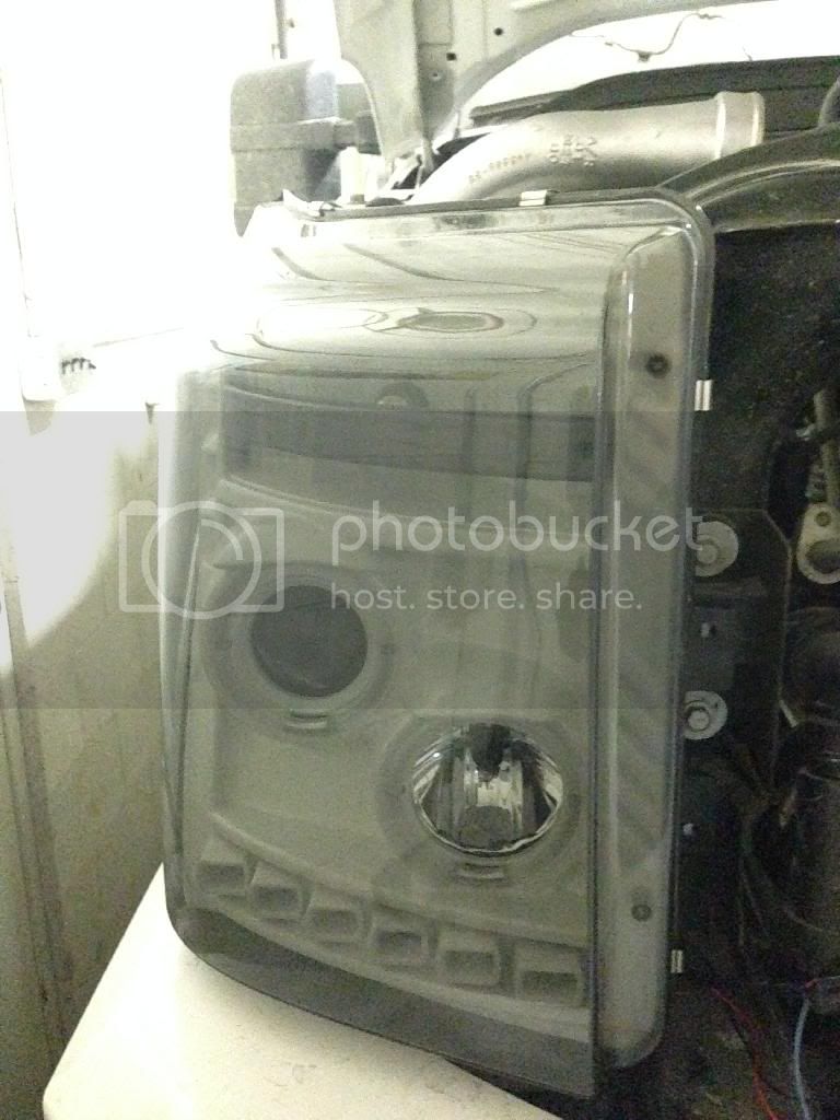

Looks sweet! Let me know when or if you come down here, we will go ride! :D
Yeah man! Thanks for those lights! They turned out perfect, it'll be cool to see what they look like with the grill painted all nice instead of rattle canned! Haha
And as soon as it's done, I'll be headed your way!
