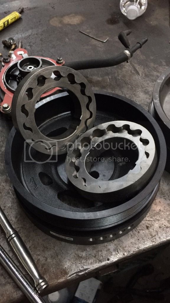

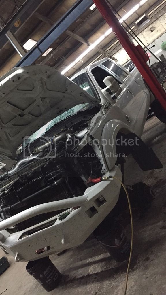

So.. Got pulling apart the truck at 7 this morning, hour and a half to get the front cover off.. Found this again:

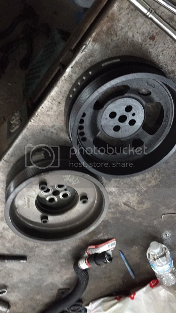

So yeah, went digging around through all my old parts and found a couple pumps... So I'm all stocked up for this event! Haha I ditched the fluidamper for a new stock one due to speculation that that is likely causing my oil pump issues... I guess we'll see what happens! So it's 2pm here now and I'm back up and running again, engine runs like a beauty still, so I got lucky 2 times now on this oil pump deal... Soon I'll be able to do these on the side of the road! Hahaha
