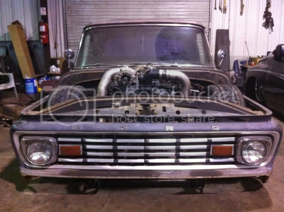

Kinda what you are talking about ?
powered by this (╯°□°)╯
Mike@MPD
4,782
Pasadena,MD
Its something Craig is testing. Not bad so far. Needs to get the sizing dialed in a bit more
