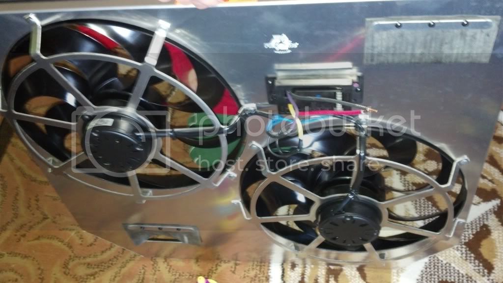

My new fans.
JDub
1,813
Hooper, Utah
I had nothing but trouble with the electric fans I put on my 99 truck.
Sent from my XT907 using Tapatalk 2
4.0l sahara
Dec 10, 2011
1,600
shelton,ct
If don't mind me asking how much are those fans? I might have to buy some and try them out.
