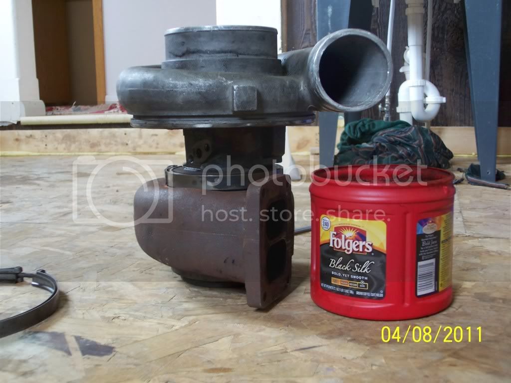

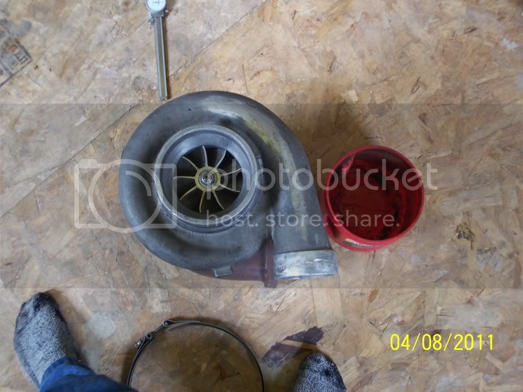

It has a 96/156 comp wheel not sure on the exhaust side right now.. I have those spes someplace. Right now it has a 1.27 T6 A/R exhaust housing.
I do not think it would fit in where you want it...
This is a full size coffee can...
and this is what it is...
I think you could spool it.... BUT might not fit it where it needs to go...

I lot bigger then the 400 frame... The S400 with race cover is 9.5 inches across. This one is about 11.5 about 12 in the biggest spot not to mention it is about 12 from the intake the the exhaust exit.. i was going to use as a atmo but did not fir where I wanted it. then tried it as a single but still did not fit.... and the OBS pickups have more room...

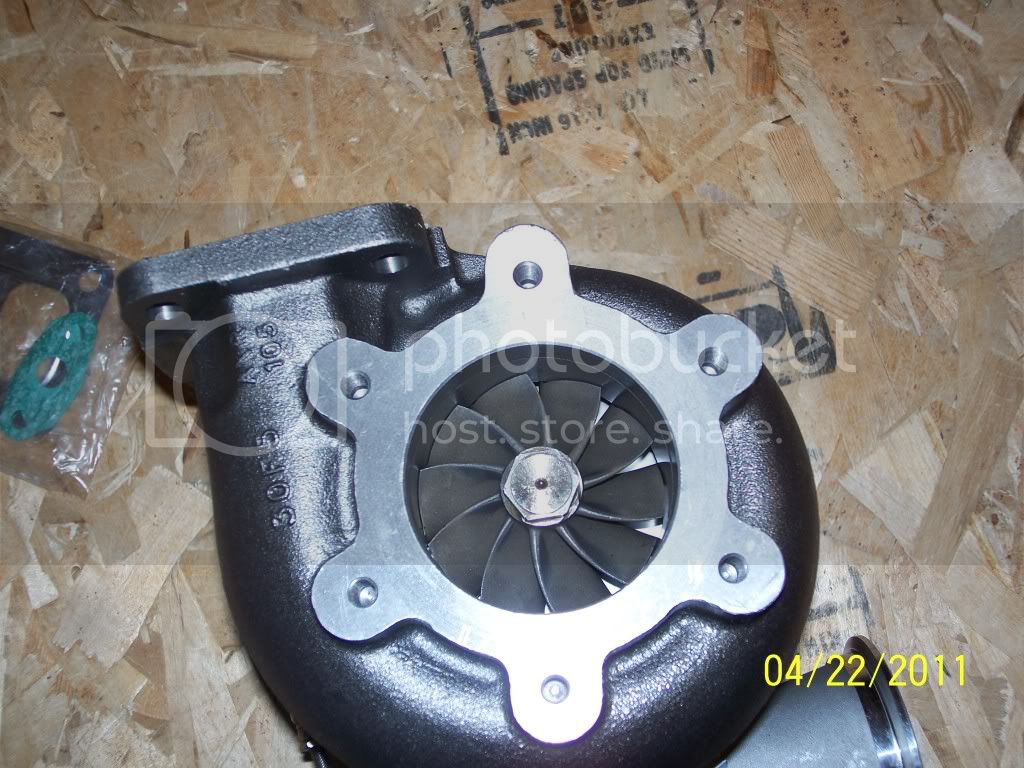

Yes it is a V-Band... Here are the specs..
Intake :5 inch
Outlet: 107mm outter diameter, 82.35 inner diameter
Compressor trim: .60 ar (anti- surge)
Compressor Wheel diameter: 74.80 /102.40 (big wheel)
Turbine wheel diameter : 75.35 / 81.70
Exhaust trim: 1.05ar
Turbine flange type: t4 flange ( twin scroll )
Downpipe flange type : 6 bolt type
Cooling type: oil cool only
Horsepower rating: 1000hp+
(wet float bearing)
