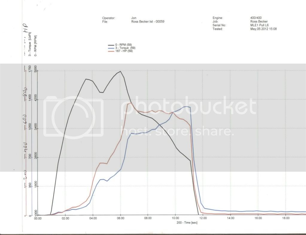

i think peak was near 3800rpm. ill try to go back and find his sheet. been a while though.
live life full throttle

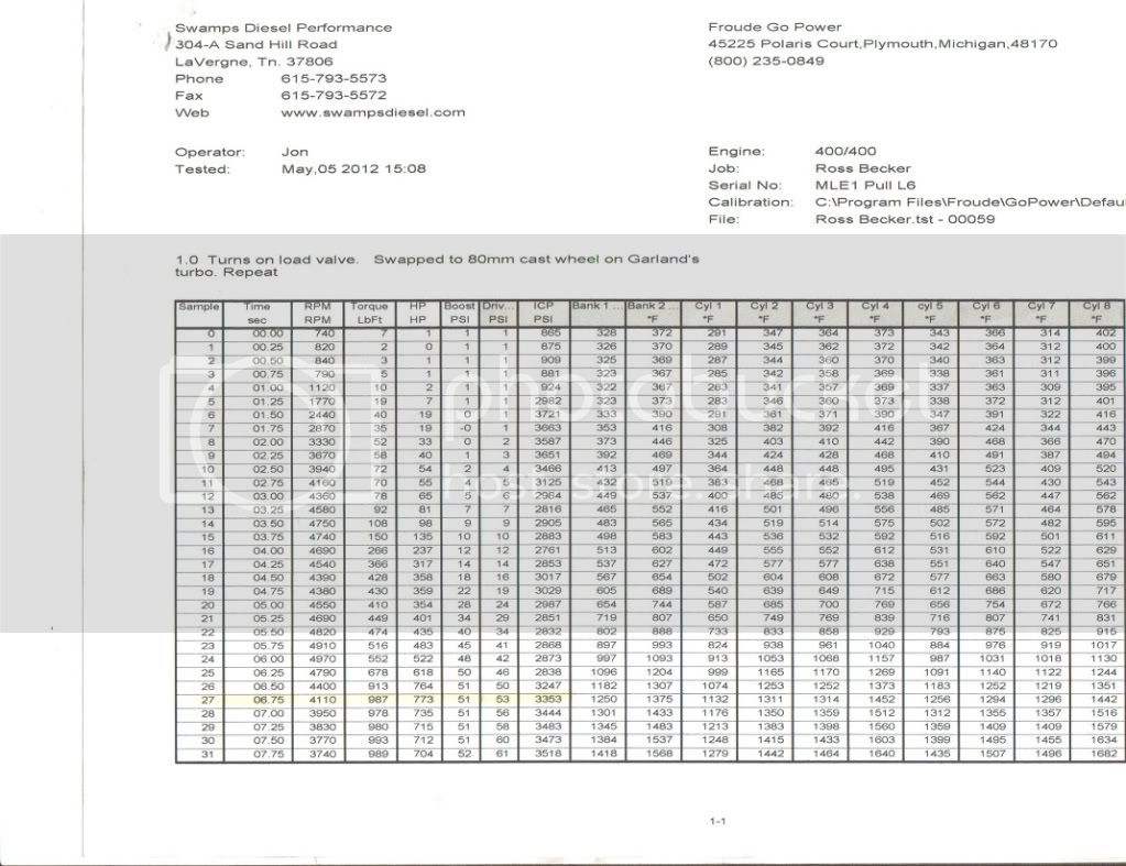

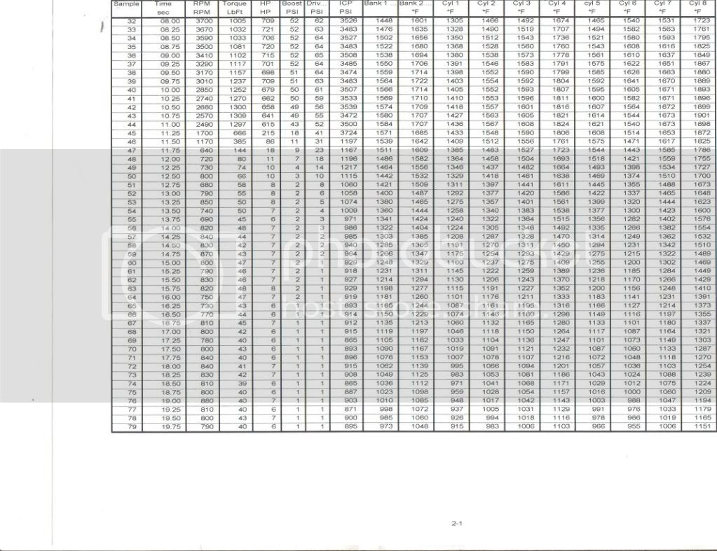

found it

peaked at 4110 but stayed above 700fwhp from 3700rpm on up..
