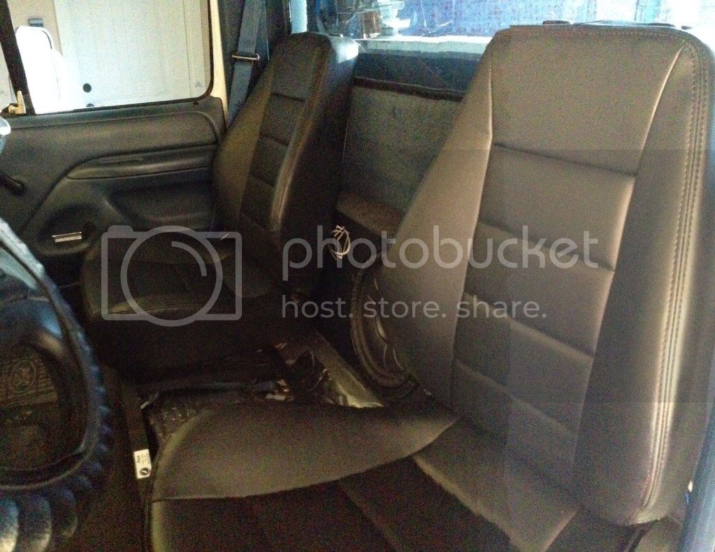

The king ranch seats was a huge fail and so was trying to find the factory 40/20/40s so I decided to order a set of corbeaus and their bracket. By far the best thing I've bought for the truck. The seats are super comfortable. They sit kinda tall but i can live with that. I have a black 08 console that i'm going to put in the middle of them when i get time. I think I'm going to convert all the interior over to black as well. Thinking about a swede headliner and I'm looking for something that will dye plastics and hold up very well. So if you know of anything I'm all ears
