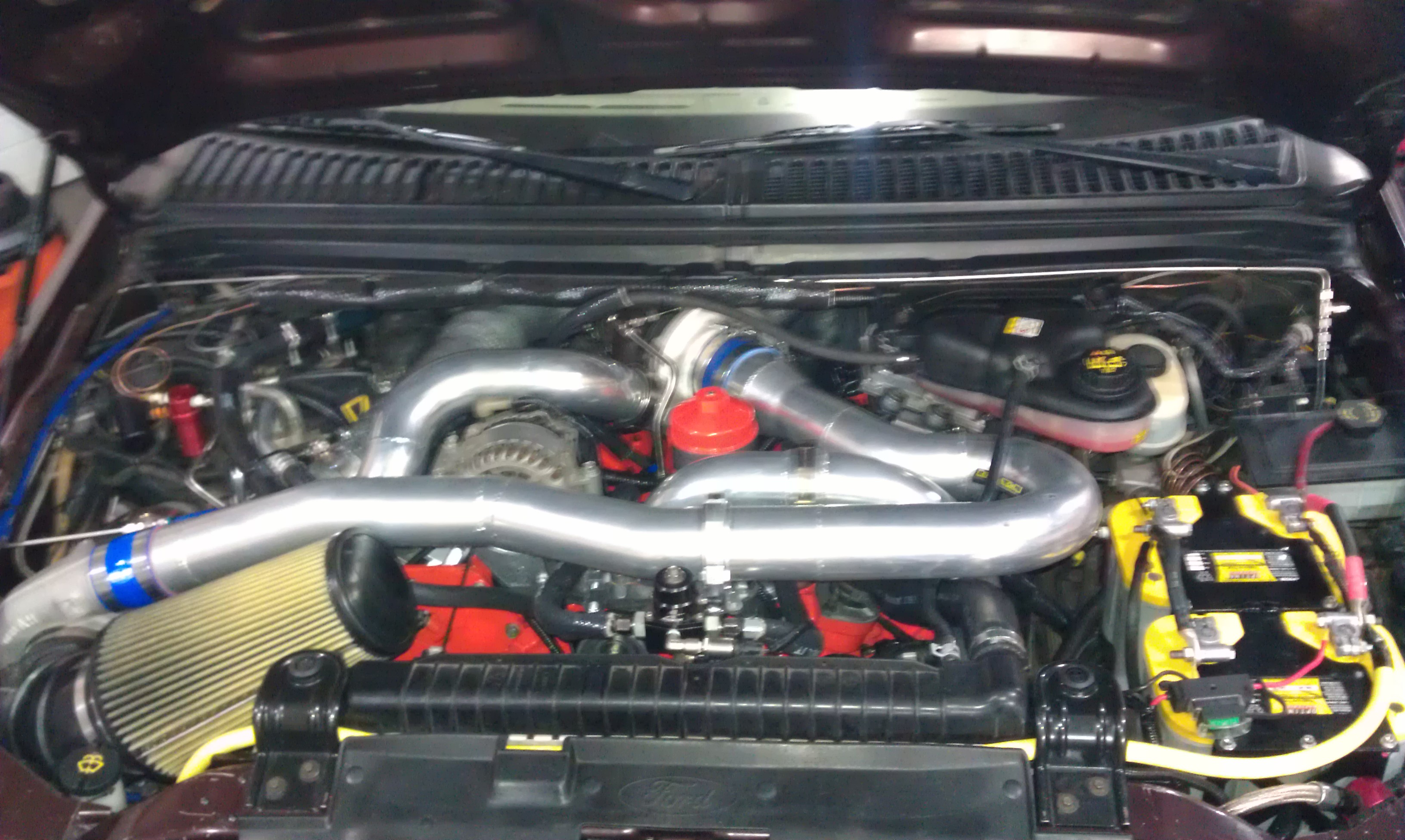

Finally...with the help of Jesus, I finally got the engine back into my truck again.
Lots of changes, but here is a picture...Blurry...cuz I almost fell off the swivel chair...lol.

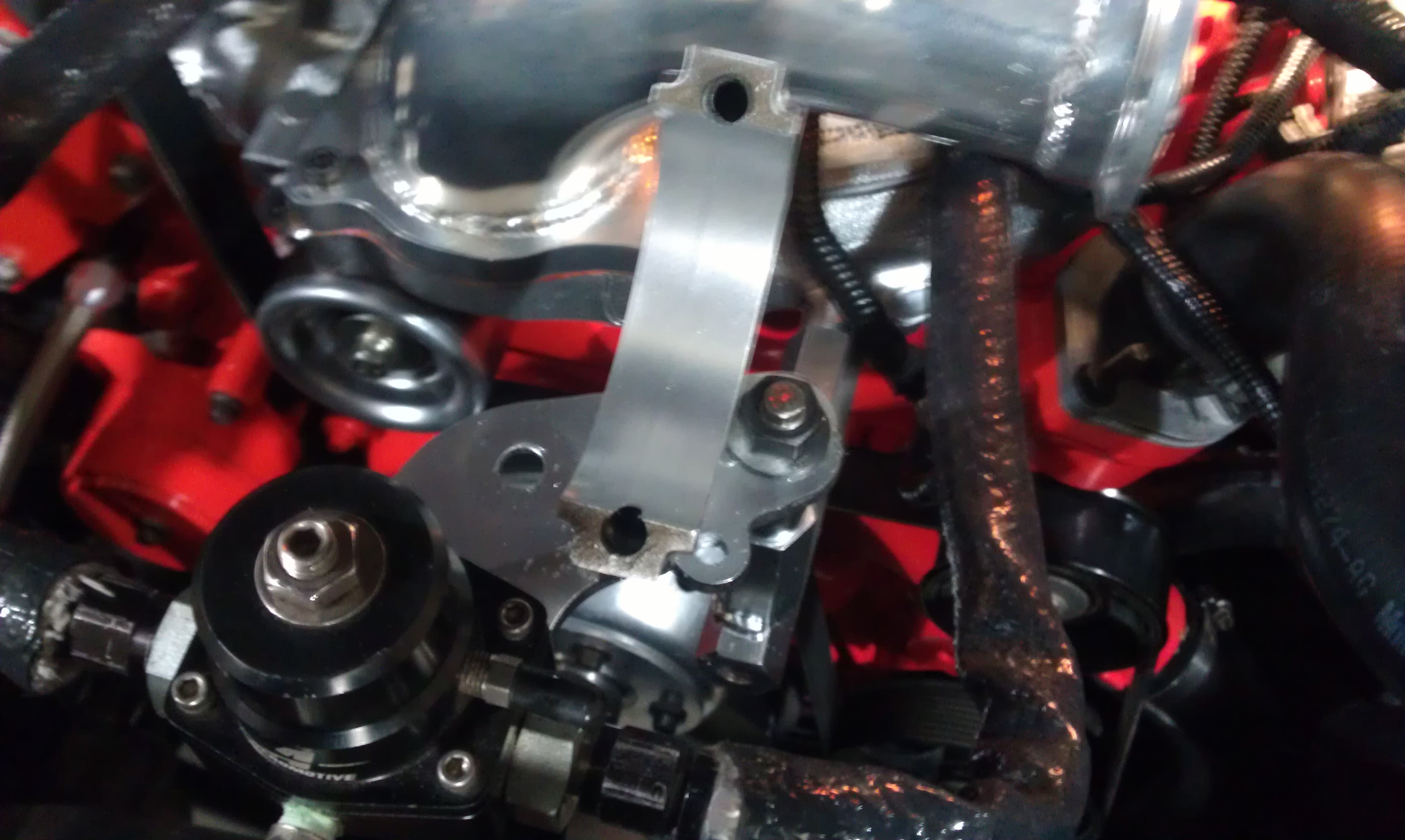

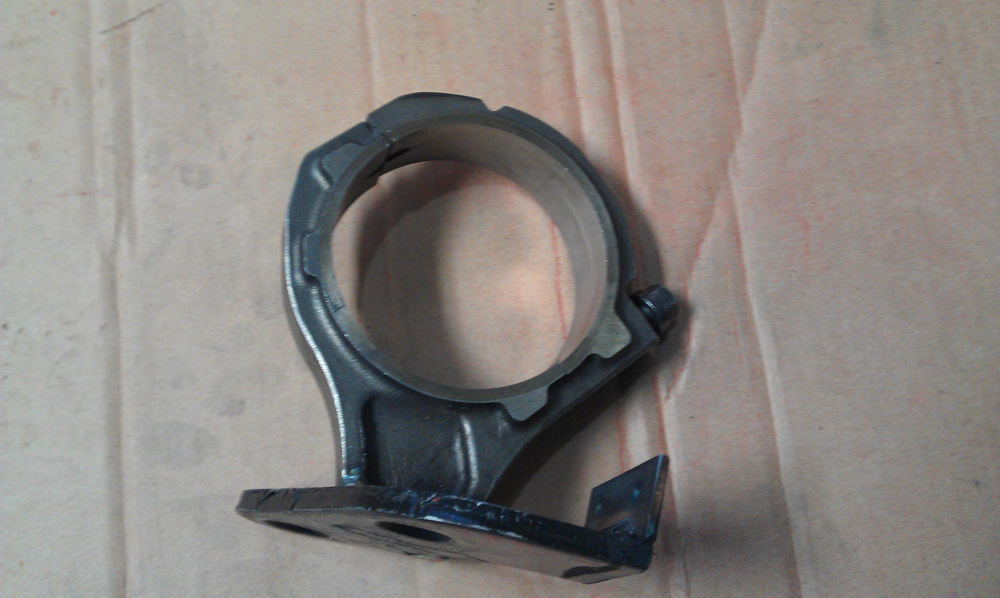

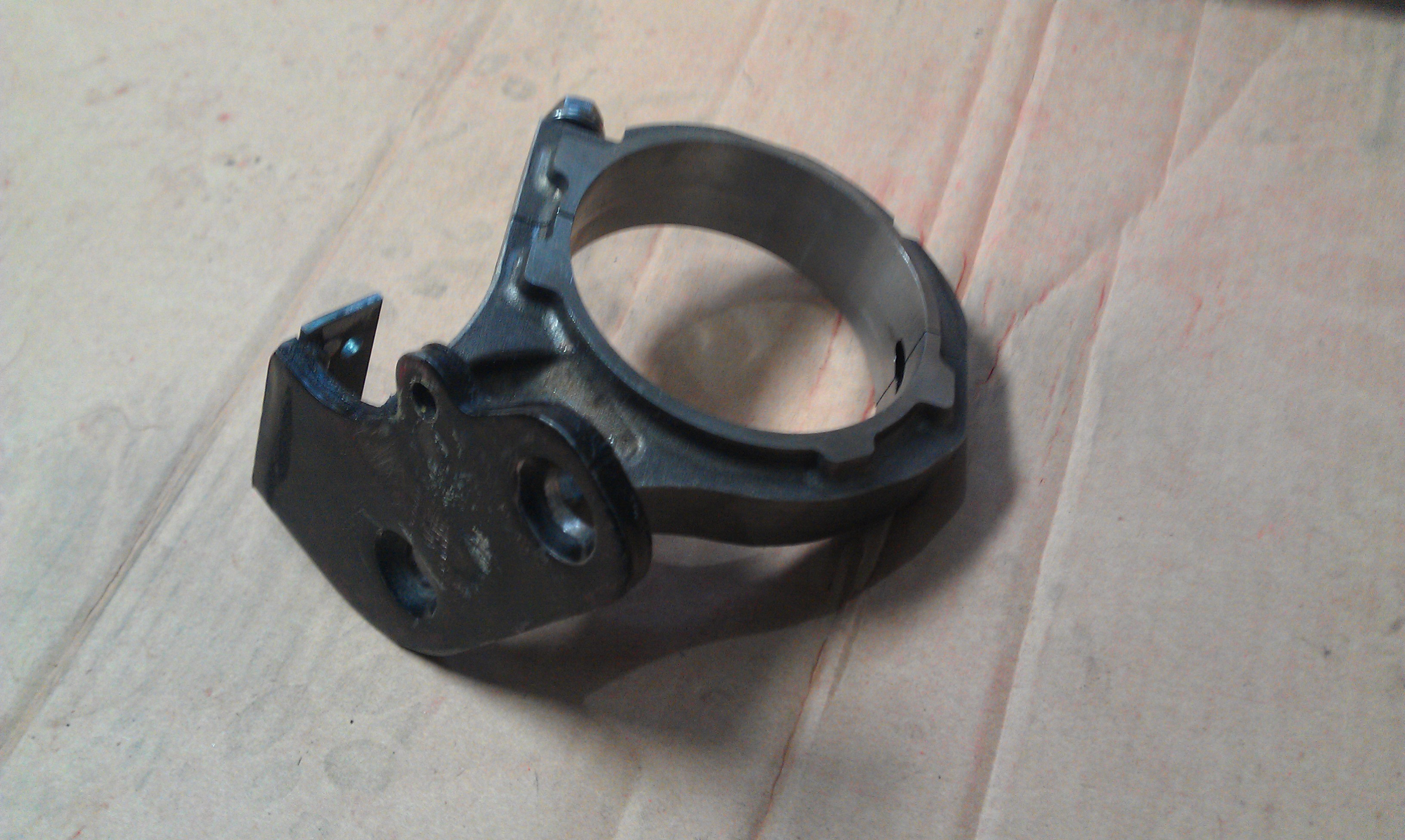

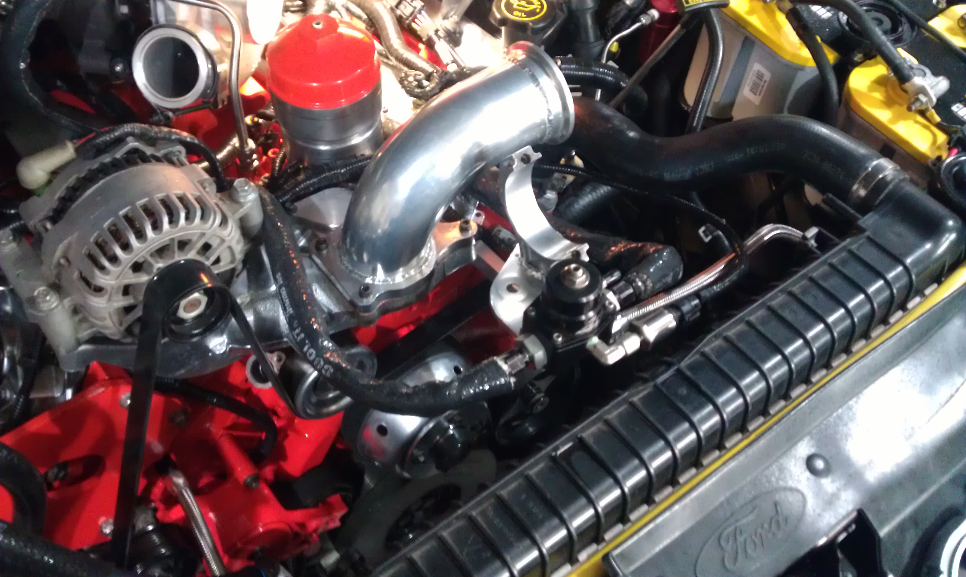

If you look really close at the fuel pressure regulator, you will see a nifty bracket I made using an old connecting rod, an engine lifting bracket, 2 fan stator stand off bolts, and a 2.5" piece of 3/4" flat iron.
It holds the pipe from the primary to the secondary solid, so it doesn't rest on the top rad hose.

Here is a better picture of the bracket.
