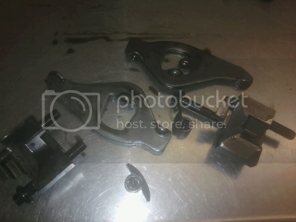

910's shimmed to 1.75.....
So Dave, since most people are shimming those to .030, was it just the amount of shimming you did that caused the coil bind that snapped the rocker mounts? What do you think the seat pressure was on those?
I've personally witnesses broken rocker mounts and rocker arms and that is definitely the weak link in the valve spring assy as far as I can tell, and my next motor is going to have those cryo'ed at the least.
907DAVE
May 21, 2011
2,166
AK
There was no coil bind. To get to that height most of the valves needed .060, others were a bit more or less. FWIW I started with the springs shimmed to just a fuzz under 1.8 - and I had contact.
Did not even bother to check seat pressure last time I pulled the springs, but the chart says 134 Lbs @ 1.75.

FWIW, that was running the spring to the ragged edge....but I was following direction from a shop that has a ton of experience with these motors and was assured that it would be fine.
