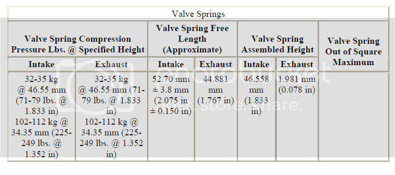

Yea I knew what the seat pressure was, I was more wondering what the installed height, bind and spring rate was. I can't remember if it's in the other thread, and didnt see anything on Go Go's site.
Am I wrong in thinking taller installed height and shorter bind is better?
Max lift height on 26120 is 1.25. Max recommended install is 1.80@. Subtracting leaves .55 of travel. Does this correspond with cam lift?
Stock cam lift is .481...
Stock installed height is 1.833, compresses to 1.352.
Found a copy of my book.
That wasn't actually my question, however that's because I didn't word it properly, and your post answered a lot of other pertinent questions.
What I was trying to ask was if the amount of valve travel would correspond directly to amount of cam lift via the rockers based on stock rocker arm ratio. IOW if the cam lifts .50 in., does the valve travel .50.
No. there is a rocker arm ratio that multiplies the cam lift by a certain amount. I'm not posting a ratio at the moment since I need to verify something - I've been told two different rocker ratios for the stock setup in recent history and I know only one of them is right and I don't recall off the top of my head which one it is.

As you may already know, cam lift doesn't equal valve travel.
Think the stock cam lobe is .295 or so on the intake.
On edit: They just answered, ratio was the term I was looking for.
Chvyrkr
2,205
Ok I was a bit off, intake lobe lift is .2535, exhaust is .2531.
So, with .481 of valve travel, the numbers are there for someone to find the ratio.
Ok, but that assumes the valve actually travels .481 during operation. From what I'm seeing on the charts, that is simply max compression on the spring? The chart you posted is giving the spring pressures at those heights, but it doesn't delineate whether that's actual valve travel. Or am I missing something? If it is then that's great, if not it just deepens the mystery.:fustrate:
In any event it will be fun to use those numbers and see if they correspond with what HRT comes up with.
Chvyrkr
2,205
That's the ford engine manual I'm pulling that info from. And I'm pretty damn sure that .481 is valve travel, and they're giving you the spring pressure at open and closed in that graph.
