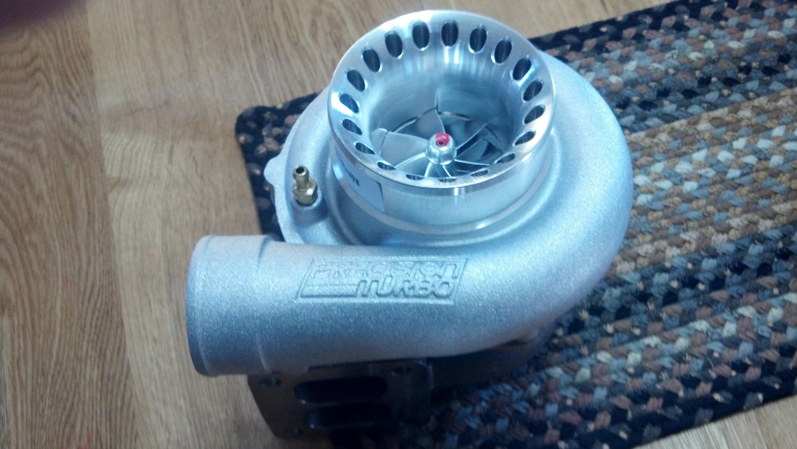

50_shooter
Dec 22, 2013
393
Central IL
It's here, now just need somebody to put it on!
I was surprised, there is a shytload of parts that came with it. Welds look really good in my opinion.
