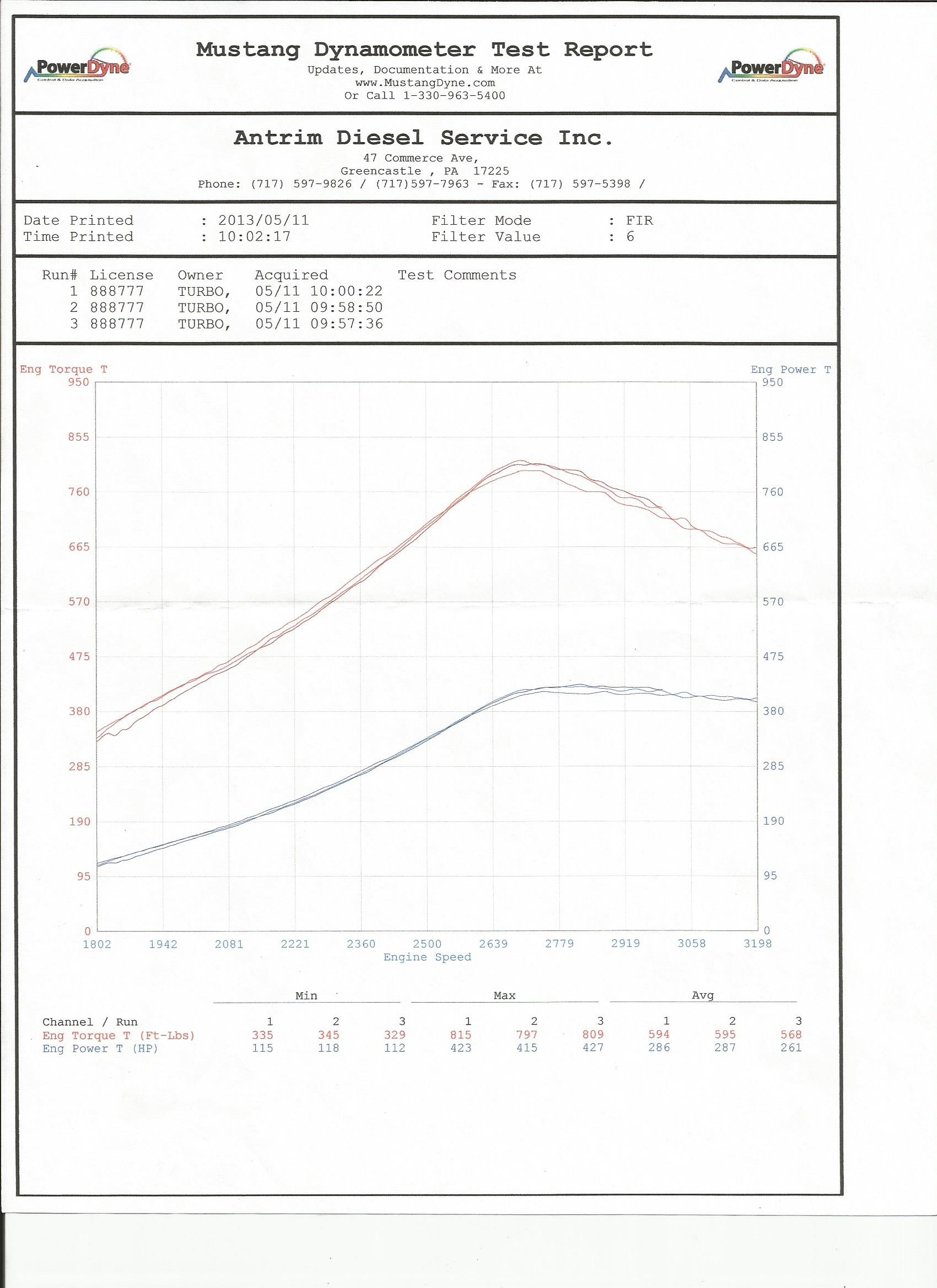

Just made a dyno run at Antrim Diesel's Dyno day yesterday, did 427/815 with my 66mm with 1.15 A/R housing, 250/200's, t500, regulated return, with totally stock motor.
I know there is more to be made with a larger turbo, but for being a drop in without needing to change mount I was pretty impressed. I'll post dyno sheet soon.

http://i955.photobucket.com/albums/ae34/NRHX2009/Scan0005_zpsa4fb9932.jpg

So whos tuning do you run, and was the truck retuned to utilize this new turbo?

So what turbo was the tuning built for? Stock turbo? And the fueling was for 175/80s?
Methinks a good tune would result in more hp/tq.

So while merely speculating, it would seem possible for more hp and tq w/ proper tuning.

I agree with better tuning and those injectors, they would make more hp. Although, I do not recommend this turbo to be ran with anything over a 238/100 tops. I am pretty much testing my own turbos to the limit. Trying to see how long it will last with the bigger injectors.
BIG CORRECTION ON INJECTORS, THEY WERE 230/200's not 250/200's. Sorry for the mixup to anyone.
