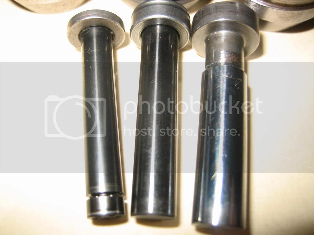

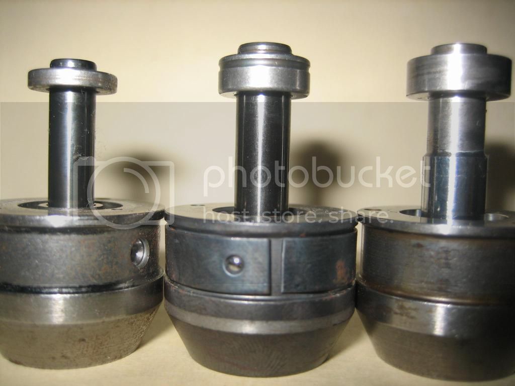

* more powerful solenoid and spring allow for significantly higher icp
*.lower ratio barrel to plunger to decreaser oil vol needs
* oil passage poppet changes to minimize pressure drop across the injector.
* larger nozzle for increased durability
I can't seem to locate any of my pictures of my custom solenoids.... if someone wants to dig I posted a couple of pictures somewhere (maybe PSN) several years ago.

That is great thank you. Its very helpful to see them comparatively like that. I recall you posting solenoids once back awhile ago. That is one key part that would add good deal positive to even current design and significantly boost over all perf as part of a systemic redesign. I was surprised that was not an early thing that was designed and offered by injector builders.
What ICP pressures have you been able to hold in your testing with the those solenoids?
One those barrel and plunger sets what tolerances were you able to consistently hold to?

Solenoids have nothing to do with holding ICP pressures. In fact I have tested very high pressures on a bench using stock solenoids.
The tolerances.... lol.... lets just say it is the closest slip fit you have ever seen. If you hold the plunger in your hand for a moment it will no longer fit in the barrel. It required grinding to be completed in an environmentally controlled machine shop - then sending the components to Europe for some very proprietary coatings - then shipping all the parts back and measuring each one using custom manufactured gauges for measurement then matched to a mating component to get the desired slip fit.
