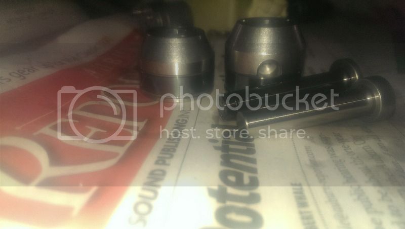

Eh it don't matter. It's all off the topic anyways. Since this was a B code injector thread I will throw what little I do know out there. First off BA BB BC code injectors are basically an AC code injector with different nozzles and VOP @ 3700. In fact all of the B codes are 3700psi VOP. BE codes are basically an AD injector. BD are the only single shot injector with the larger 7.1mm P&B 250cc stock. BI BJ BN codes are all split shot injectors with 7.1mm P&B. They have a taller barrel and longer nozzle cone. The Intensifier piston is also shorter on the splits. Tim @ PIS tested a BI code on the bench and it took like a full 6MS to dump 275cc thru a DT466 nozzle.
Picture of a BD Code P&B next to a BI code P&B
