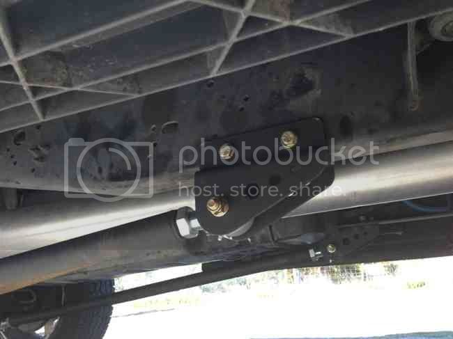

So when drilling into the frame for the pmf bars the tank needs to be removed ?
Would like to know this also. Hope not though sound alike a pain in the ass.
I have PMF bars my tank wasn't in the way on my SCLB, it doesn't matter if you have pmf bars or ouo bars, the way they bolt onto the truck are basically the exact same.
That is pretty far from the truth. Actually.
Nothing about those two products are the same actually, and the way our bar mounts to the pivot mount has more clearance for installation in tight spaces for what it's worth.
And just a heads up, I'm not starting anything, just clarifying a valid point

Ok, so no loading or tightening them down (if adjustable) necessary?
On ours you set the truck at ride height as you use it every day, torque the front section to desired spec, then drill at the coupler and install the crush sleeve and hardware, and you're done. Very smooth and well explained in our instructions ✔️

He said the way the BOLT the frame and yes, it's quite similar. The both use a bracket that bolts in from the side and the bottom. You're drilling holes no matter which kit you buy.
I actually still disagree.
We've been talking in terms of clearance correct? People talking about mounting with Titan tanks, etc.
When you are mounting the bars to the frame mount, ours goes front to back. The other, side to side.
That being said, when mounting next to a fuel tank, skid plate, or crossmember, our bars install easier than anything else because you don't have to fight a cross bolt that can potentially back up to something.
