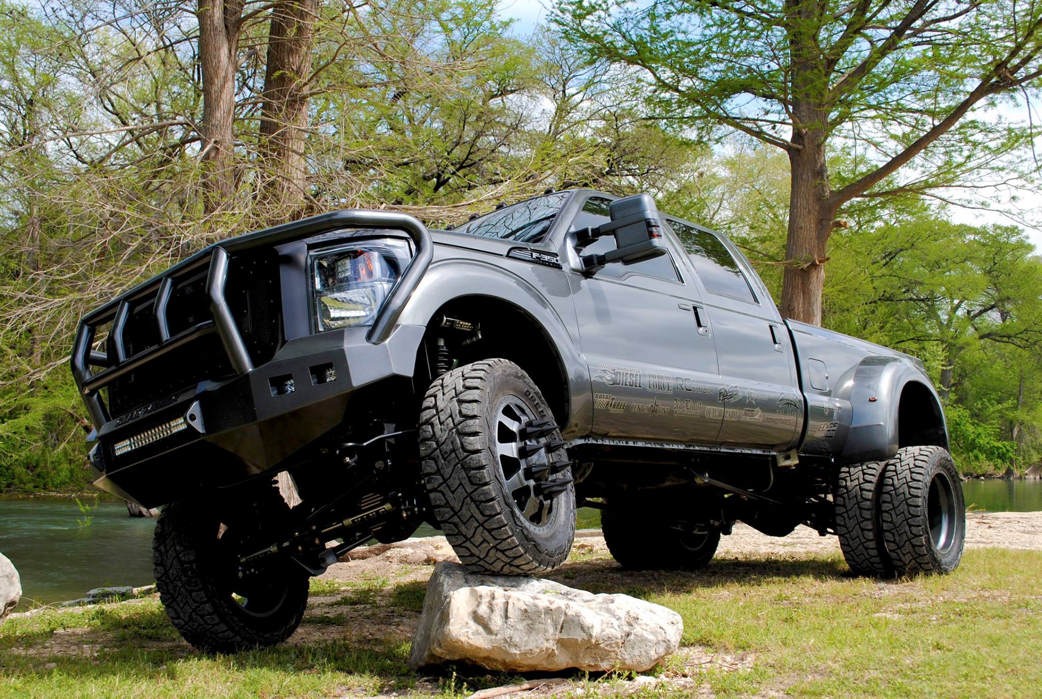

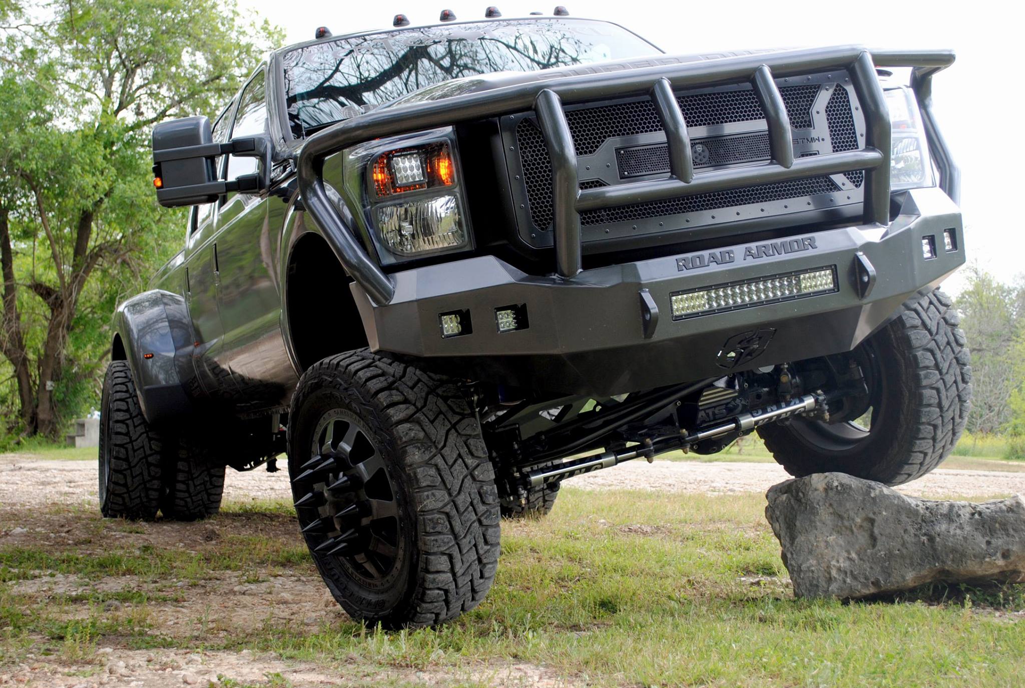

NotStock
1,274
Tucson, AZ
No worries about suspension binding with our kit!
