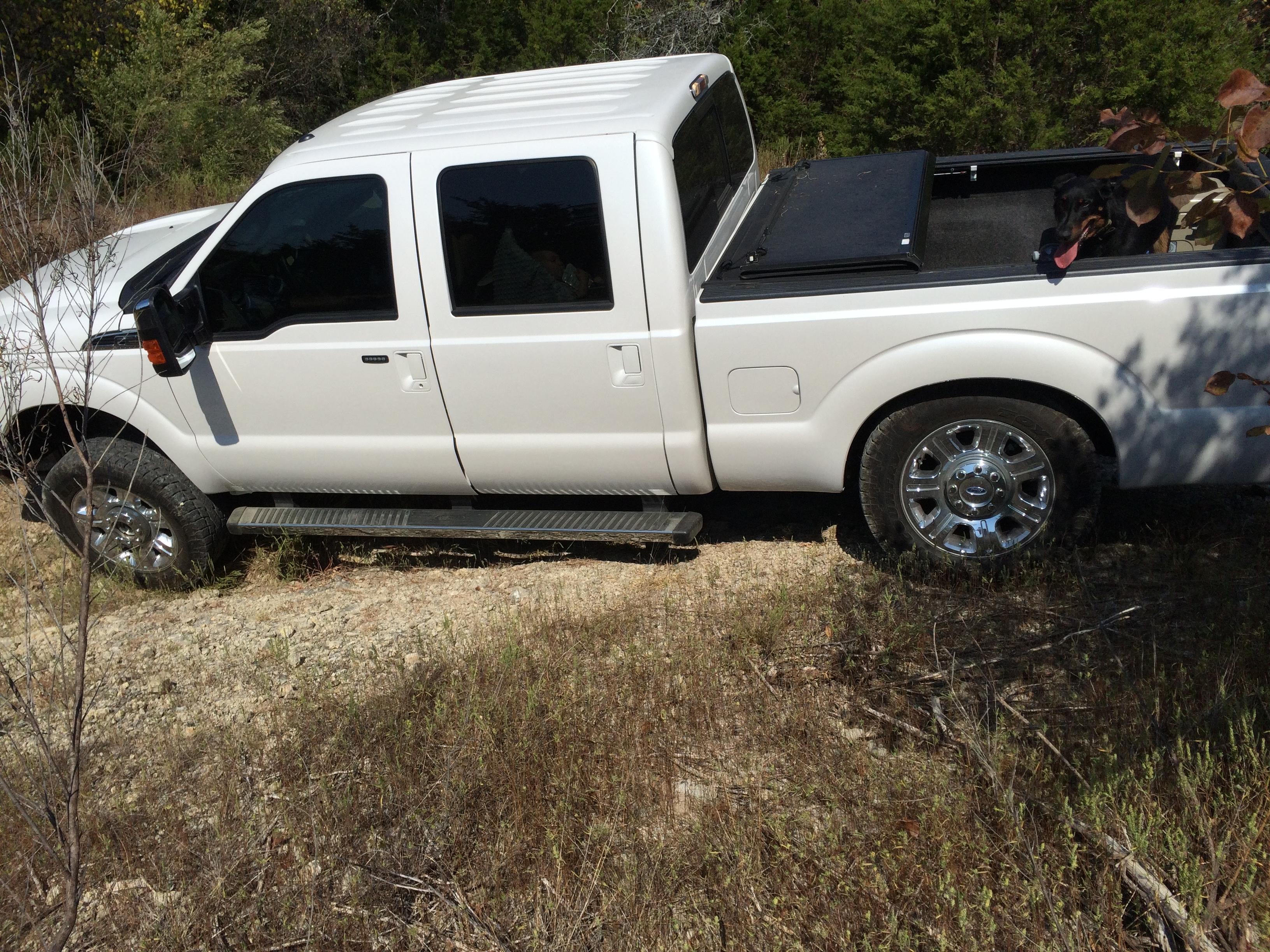

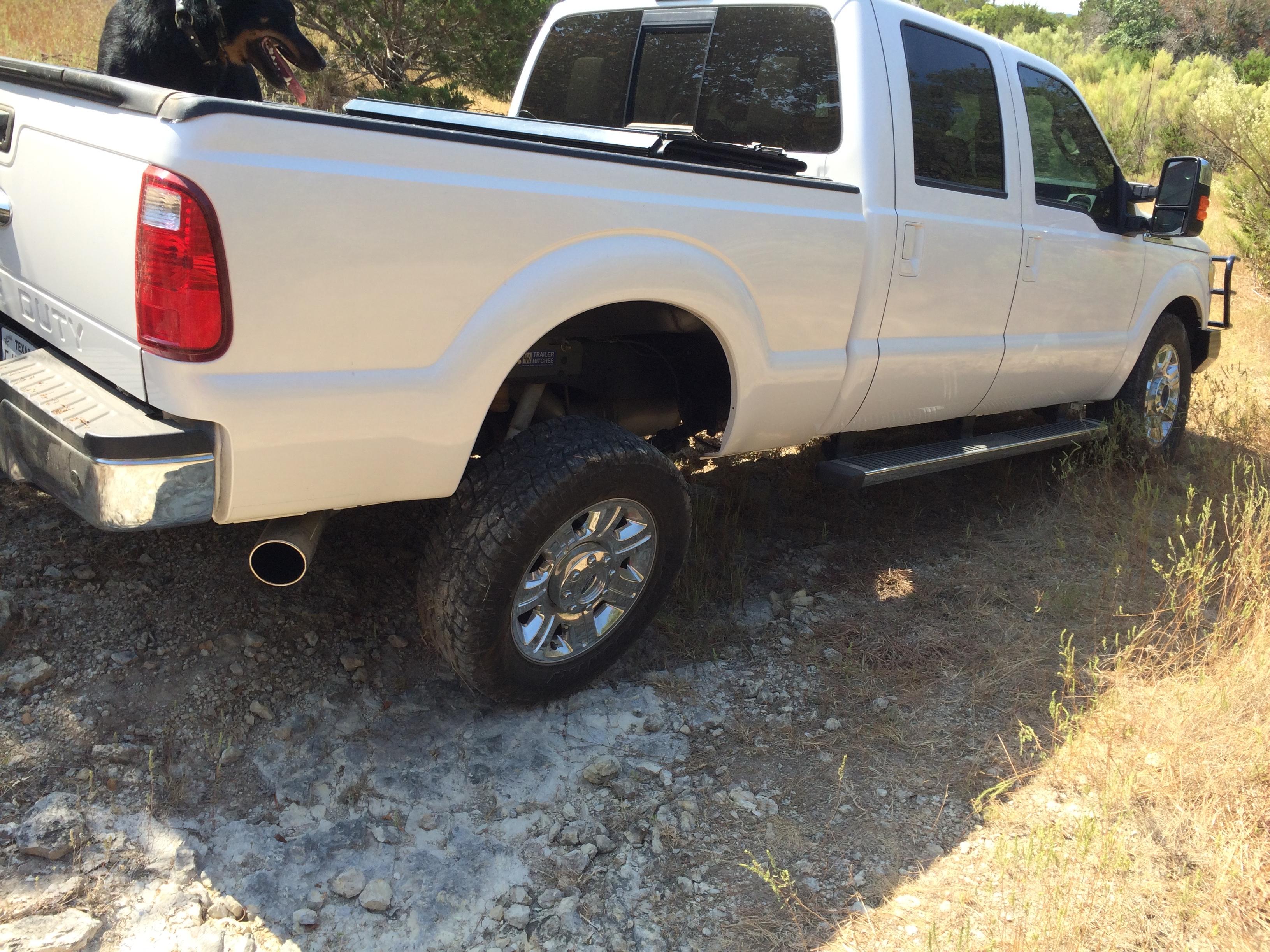

Took my truck out to my ditch and tried to twist it so one wheel would come up. It didn't. Used to be when it was stock I could get 1 wheel up and it would teeter. Today, it's planted. ???
I drove in and out of this several times with the door partially open, no funky noises while twisting it.
It's got 35" on 22", Icon springs, King shocks, Airlift bags, PMF Traction Bars and a Titan 50Gal tank.
Riding in it, one isn't likely to forget it's a 1ton truck, but for a 1ton truck it rides pretty nice.

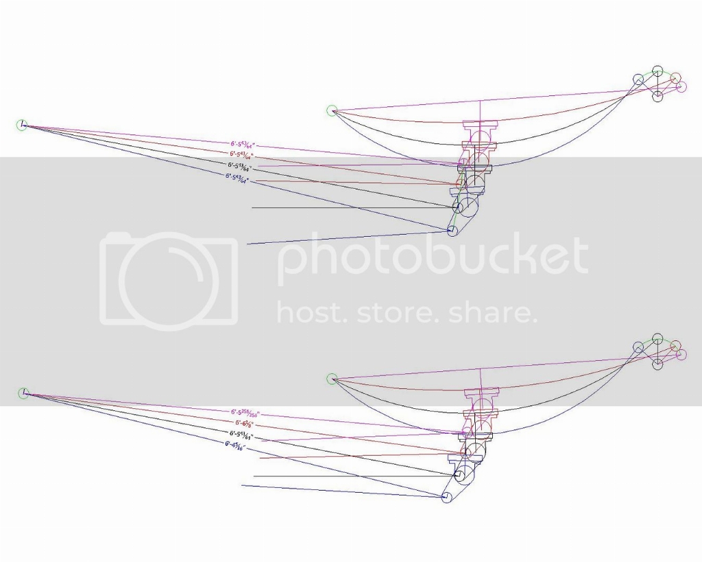

This is just a sketch. Upper picture is with a fixed length bar, lower picture is change of distance from a fixed point of unrestricted motion. Black is static resting position.
