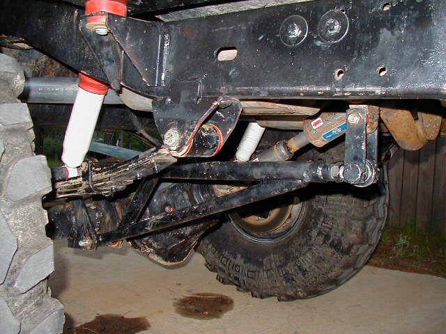

Nope, referring to this design.
But axle wrap is a different force than normal suspension movement. Normal movement lets it float forward and back. But when the housing tries to rotate and the pinion starts going up, the shackle doesn't allow it to go upwards. This is a very common setup that has worked great for years.
Look at PMF's Floating traction Bar. I run them and love them.

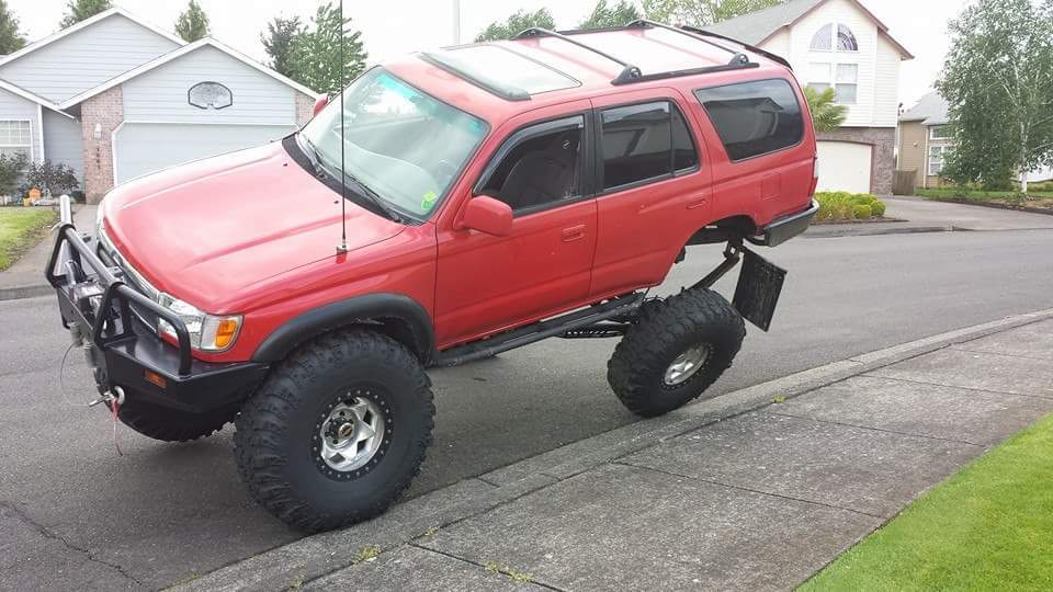

Never seen act before, maybe because I don't go to many of that type of 4x4 events.
I understand what axle wrap and normal suspension movement is thank you.
The only way I see that working is if the shackle is at a perfect 90 degrees to the frame and only for a little while. If not then it will rotate, might not a lot at first but depending on power, which that looks like a crawler truck by how short the driveline is it must have 2 transfer-cases, I would guess it is a Toyota or something with not a lot of power, it will rotate just like leaf springs look like an "S" with power and not bars. It does work PMF has one similar just a little better looking. The reason it doesn't rotate is the top and bottom is opposing forces.
Didn't mean to offend you. But I think that's why the bar needs to be mounted as close to center as possible so it's not seeing the drastic suspension changes when articulating. I'm not saying it's what to do, just asking. Anything can be built strong enough. My dad runs one on his trail truck, full size f150 with one ton axles, built big block ford, 4:1 t-case, etc. He swapped the ford leaf springs out to the 63" chevy leafs since they flex better and also only ran the two longest springs. So that thing would snap a u-joint on command without a traction bar of some type. It has held up for almost 10 years now and there's been numerous times it's been full power and on the back tires only. But his is a lot longer than the one on the picture, so that plays a huge role in it too.

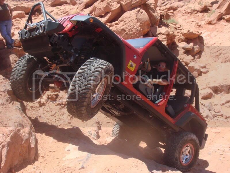

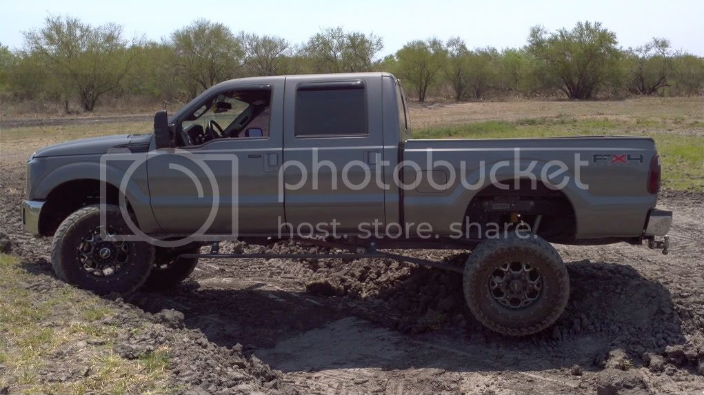

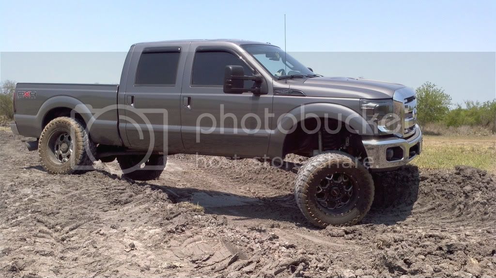

I think everyone has seen these pictures by now.
You know a jeep that will out flex this truck will do the same thing at those angles correct?
You also know that the hardest of off road vehicles limit travel as there is a point where travel is useless. You do know that right?
Coueshunter
Sep 1, 2015
180
Gilbert, Az
So because in this situation the suspension isn't just fully dropping out then it must bind and not have problems... Right?
Again look the tire didn't even drop out on the drivers side, it must not be able to flex or must be improperly built.. Right?
I certainly hope you know of a Jeep that will outflex a street driven tow rig Superduty. LOL. That Jeep isn't going to tow half the peoples trailers on this site nor will it make the kind of power and torque that a lot of these trucks make.
We are not building a crawler to go up Back Door in Johnson Valley LOL. This is a street driven, towing, and occasional offroad truck.
Travel is travel...if a stock truck comes with 10" of travel. I would like it to stay that way. Even if it is not useable in your opinion.
All we are doing is trying to make a truck not shake when it accelerates, not make it ride like **** when unloaded, be able to still tow a load, not make any noises while driving, and be able to not limit its travel. It is pretty simple.
