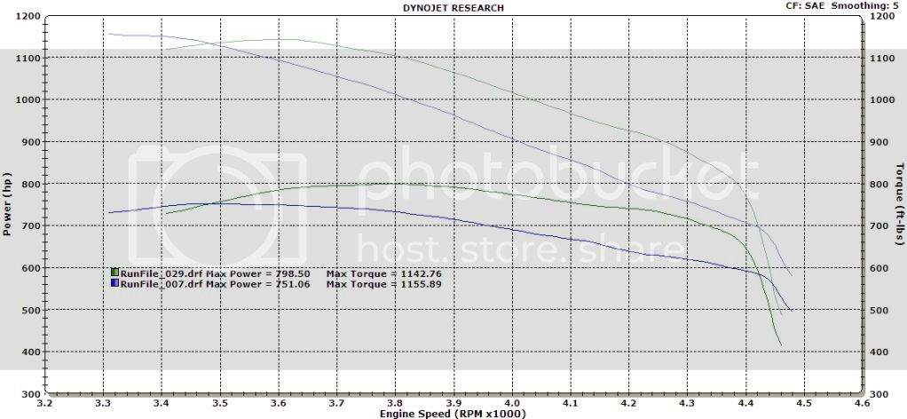

elite tested almost identicle sized turbos, both 75mm with the same ex wheels and almost idetincle A/R. one being a precision billet and one being my batmo race covered 75 ... the precision made about 15hp more at peak, and made 100hp more at 4000 rpms. haller has the graphs iirc.
Word.
I figured the graphs would have been posted sooner. Maybe this thread will draw them out from hiding.

Batmowheels are overhyped wheels that dont flow as much as normal billet wheel from say precesion or garrett. Tadd from Elite has proven it.
Here Tadds precesion with billet wheel vs bullseye/batmo dyno chart.
IMO batmowheels are too expensive for a crappy wheel and almost nothing to show for what your paying for.
But Aaron also showed a gain w/ the batmo vs stock.
http://powerstrokenation.com/forums/showthread.php?t=117972&highlight=71mm&page=3
It clearly showed a gain over the cast stock w/ the batmo wheel and the 71mm had the best #'s. I'd say the idea of the batmo trying to take the thunder from elite is overhyped. It's simply an option for the ave guy who doesn't want to run up his credit card.
Isn't that the basic idea for the batmo? Gains over stock? not to steal customers away from elite.
Anyone who thinks the batmo will get 71mm or High power type gains is a fool but I've read too many posts where guys were hoping to get some EGTS down and maybe better spool up on a budget and the batmo was an inexpensive way to accomplish that.
