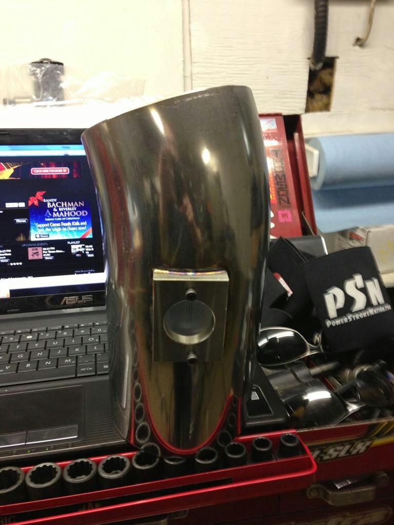

Well I finally have an intake coming, thanks to Shane (white_monster) for coming through and helping me out on that...he heard the problems I was having and got one made for me in 1 hour...I really appreciate it buddy!
I just have to order a filter and I should be good to go
I don't have a hold up on getting my truck drivable again finally
Sent from my SCH-I535
You own a Ford?? Great to see it coming together, been a while. Now lets see what a lots of fuel will get cha. :ford:
