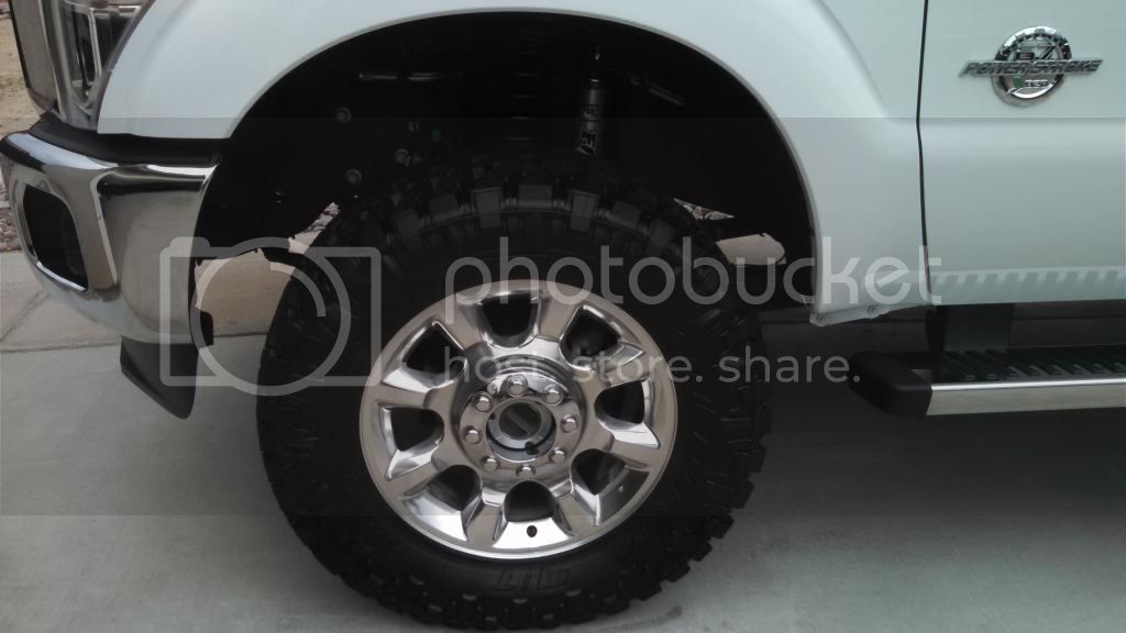

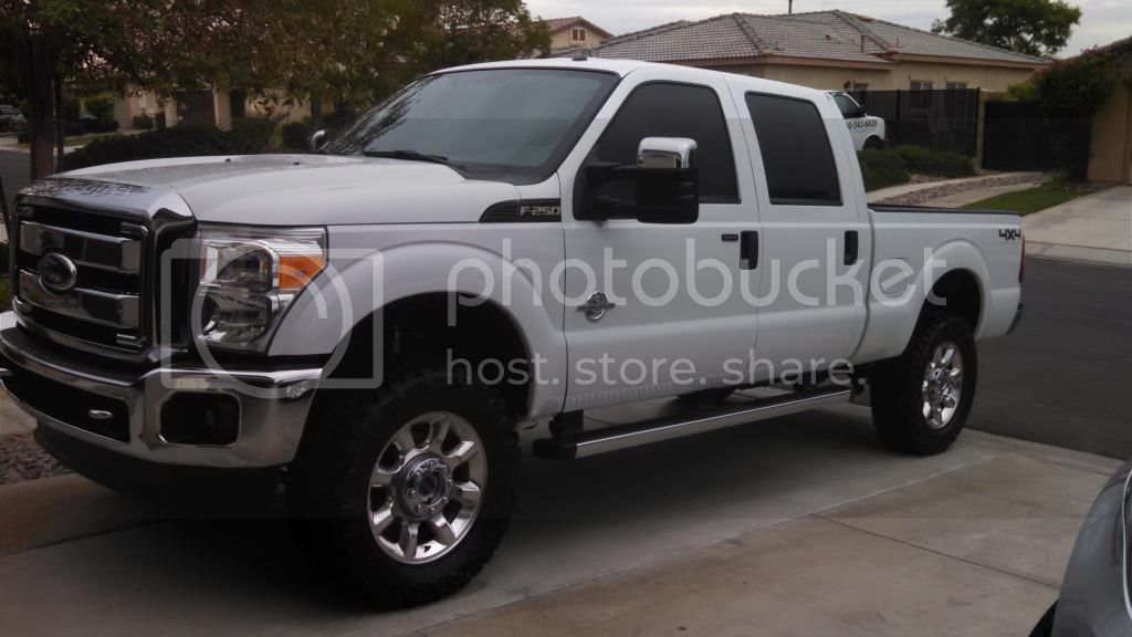

My 2011 with Carli 2.5" Fox Commuter 2.0's Stock rims wrapped with 35/12.5/20 Nitto Trail Grapplers. Seems like more body roll than stock, but could be due to the increased height. Can barley feel the whoops on the freeways now.

I bet it has more body roll because you lifted the front without getting offset wheels, I would guarantee the body roll would decrease with the tires sticking outside the fender.
