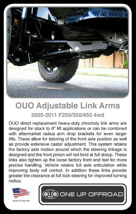

Whether it be PMF OR OUO on the "3 link" adjustable radius arm... Which were not getting into, they are there to help with the handling aspect of the suspension and steering. It has very little effect on the actual ride quality.

See I don't understand how the 3 link pmf system would ride any smoother than the stock radius arms. They both have 3 mounting points and with fixed mounting points they should literally ride the exact same. Now I've seen a 3 sink system where the top mounting point was secured by a gas shock of some sort and I can understand that being smoother, but I really cannot see why the 3 link system would be smoother my any means.
Because its adjustable. So instead of having a single swing point where the front axle will tilt downward at droop or increased lift, you can now get the axle perfectly level ( no arched spring ) and it the spring can then compress and expand in a N / S motion instead of a N / S motion with a forward bulge. You just can adjust for that with a non adjustable radius arm.

Right, but it's hard for me to believe that the ride is night and day different as some have posted. Sure they are adjustable, but at the end of the day, 3 fixed mounting points will create the same motion. 4-link is an actual difference, but I think ppl may be buying into the look of the 3 link rather than the ugly radius arms. And do they justify $900 price tag?

Personally I prefer the look of a 4 link system, but the 3 link has proven to be more stable in my experience.
With the 4 link I had sloppy steering. With that loose feeling. Also had a cosiderable amount of body roll. Was is smooth YES.
The adjustable radius arms tightened everything back up, and in the the end I would rather have a tighter more controlled vehicle and adjust shock/ coil option to get the better ride.
Having loose steering or body roll just means you will be spending more money on sway bars, stabelizers, gear boxes, etc.
Same motion, but with the axle located in a different area. Its hard to explain, but the radius arm the higher the truck goes the axle gets pulled back further towards to rear of the fender. With the adjustable 3 link or even 4 link for that matter ( though ride characteristics diff from one to the other ) you can get better geometry and keep the axle in the correct location. When you factor in the drag link, track bar, shocks and springs are also affected when the axle is shifted further back you'll kinda of understand what I mean. Also the pivot points for the steering knuckles being lined up vertically rather than tilted forward makes a difference.
