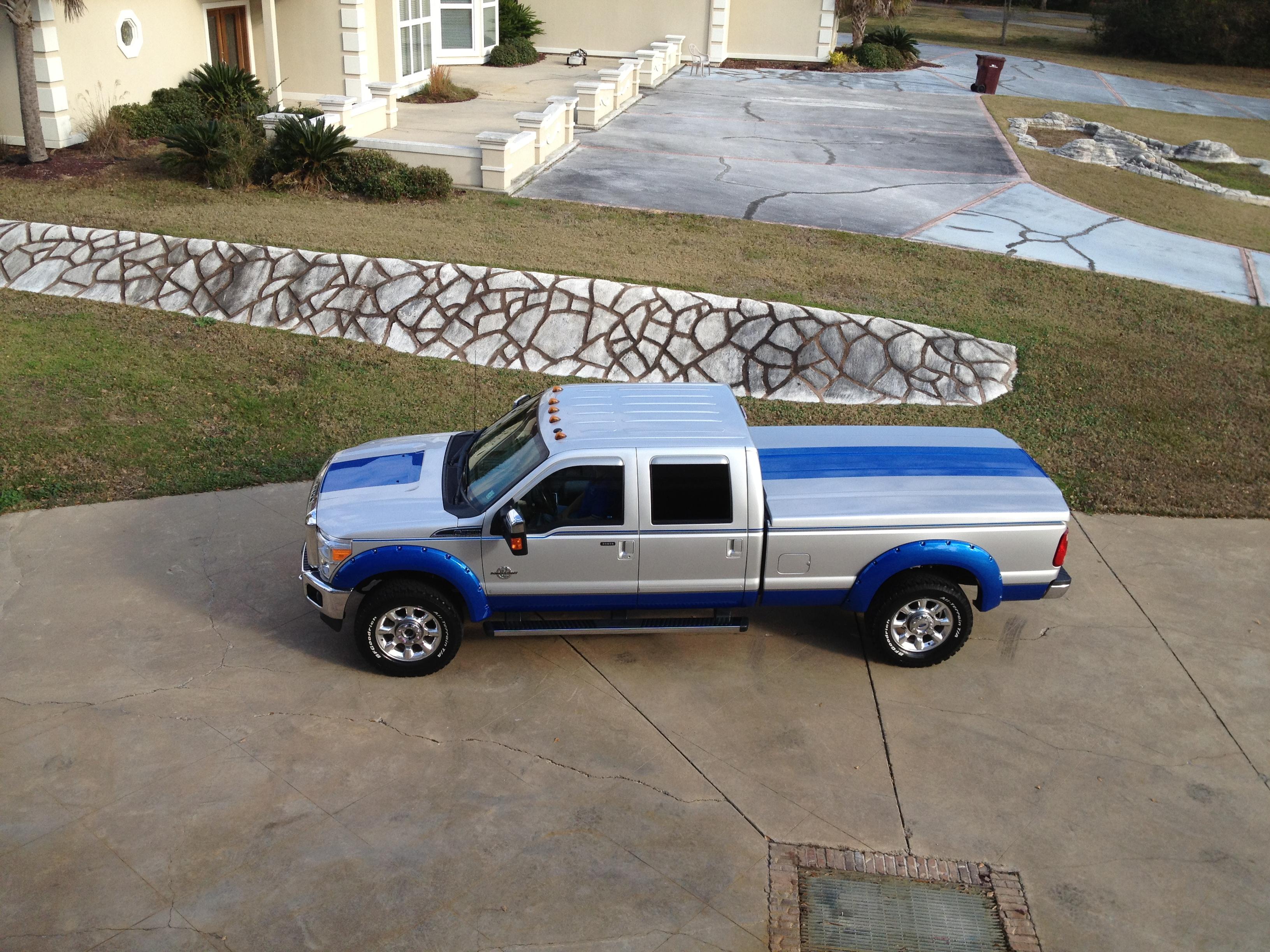

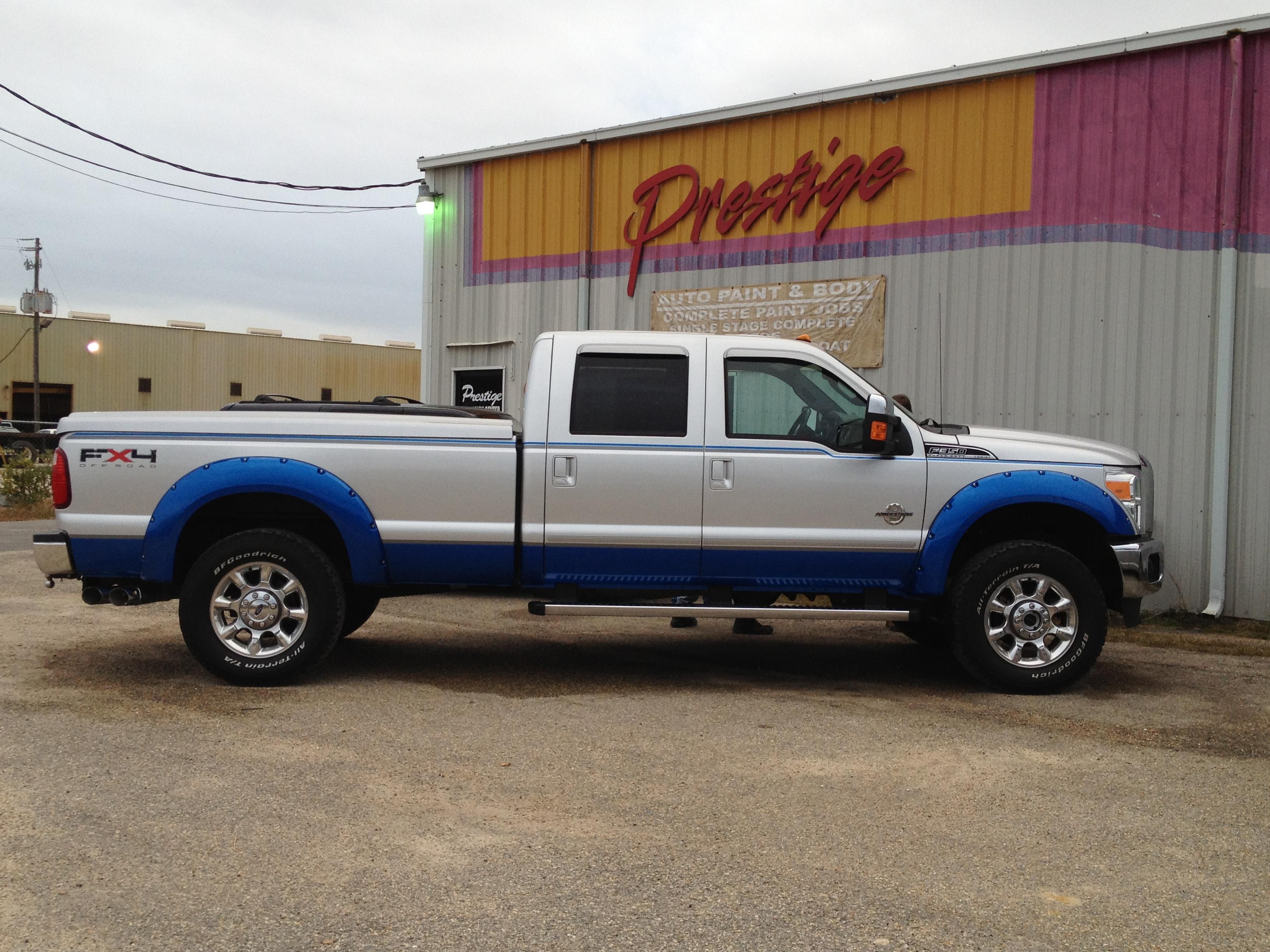

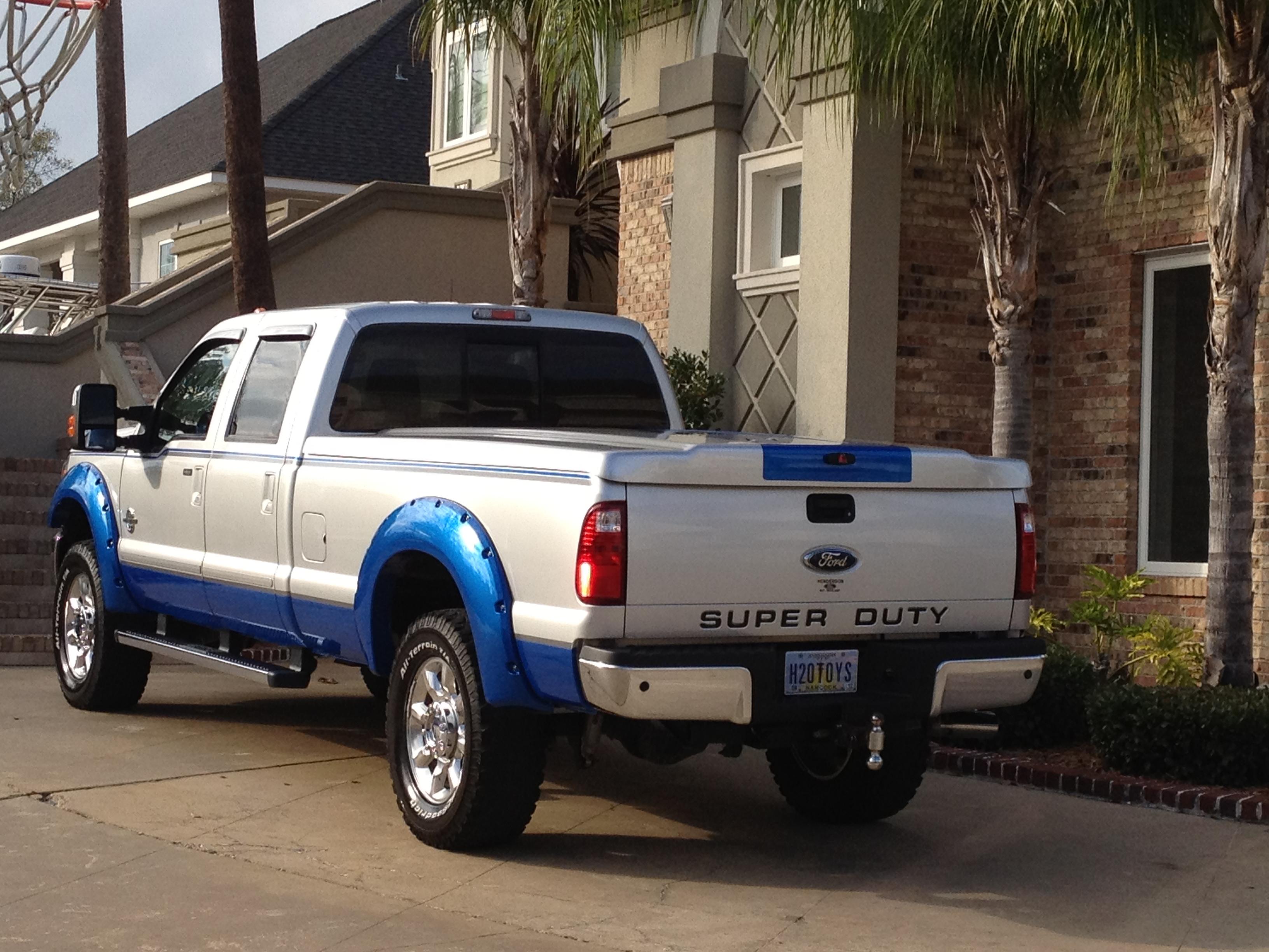

I just spoke with Radio over at Carli, he was very helpful. Ill be on the HWY most of the time and towing heavy long boats occasionally. He suggested I go with the 2.0 Commuter set up. I do prefer the 2.5" lift vs the 4.5" for work purposes and I like that stuffed wheel look with some 35" rubber. Just hoping it will be slightly taller than my 11 350 LWB with the Rancho shocks. My only reservation is the truck being so heavy and the set up being too soft. I know the Ranchos didn't last long after 50,000 miles but they were cheap. If the Carli set up is better than the factory in ride..like Radio stated..but mostly handling is my concern around corners..and with a 13-15k load.. Im cool and ready to order. ANY Suggestion and experiences. thx for the help.
