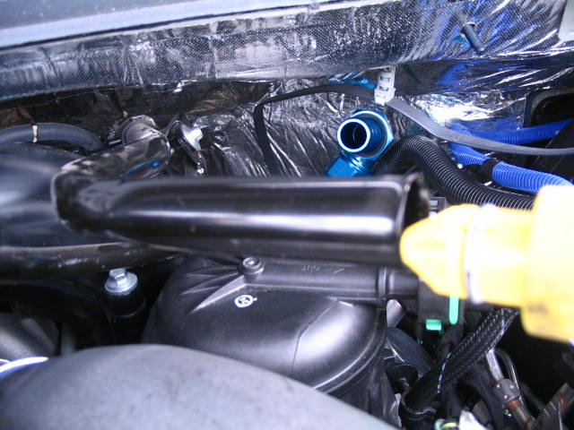

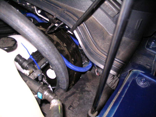

I’m not sure how you guys got the 90 and hose down past the fuel lines, in less you bent the heck out of them ,I ended up running mine forward then down past the brake booster. I could not see any other way without major fuel line bending.??

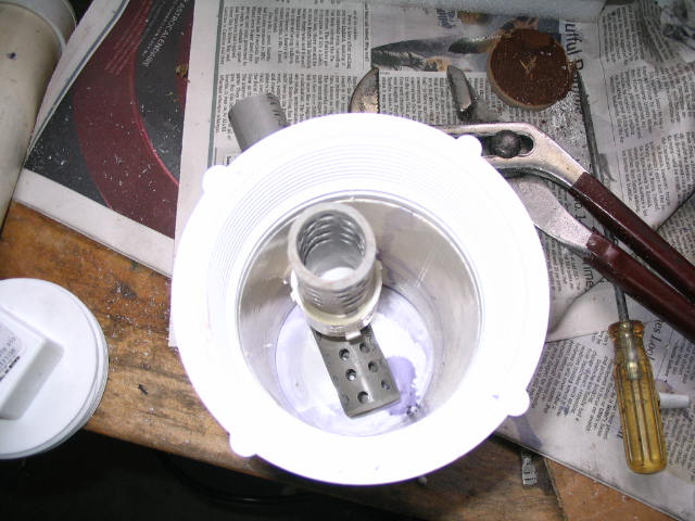

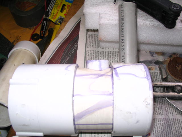

I built my can with 1inch in and out and 3 layers of scotch bright and steel wool inside, then I ran it out to the pass side rear bumper.
