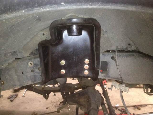

I've heard the holes for the coil buckets are already on the leaf sprung front end trucks, Is this true? And does any fab work need to be done? I'd like to put an 05 front on my 7.3
G Racing
1,643
Southeast Texas
Not all the holes are there and you will have to drill some of them. The only fab that I do is with the pitman arm. The taper has to be enlarged. I found it easier to buy the new coil buckets and the radius arm buckets than having to cut the rivets out of the old ones but that's just me.
so would it be beneficial to buy new coil buckets, radius arm buckets, and a pitman arm from a coil sprung truck? Ive removed coil buckets from an 2013 truck and never want to do it again.
sidwaz
Dec 20, 2011
99
Vancouver, BC
I have done this using 05-07 components.
G Racing
1,643
Southeast Texas
Those rivets are a PITA to get out. Heat them up and then you can work on them with an air chisel. I haven't been able to find a direct swap pitman arm so I just mod the old one to fit by having the taper slightly enlarged.
