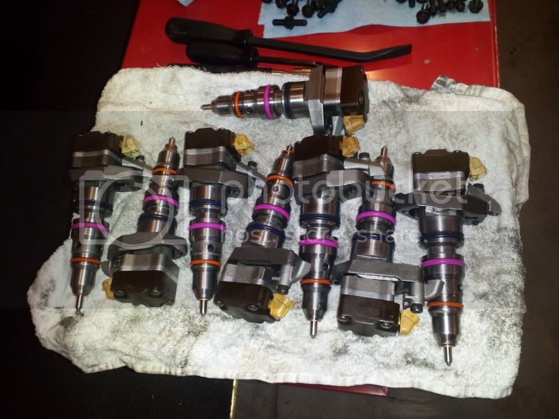

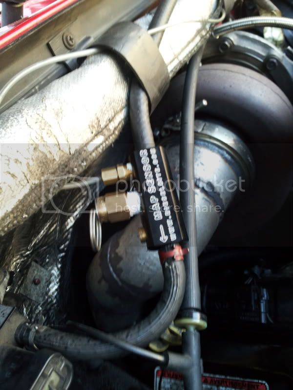

Okay back to this.... Since i last posted i have:
1. Installed a new set of injectors that i know 100% are working correctly
2. Changed the oil
3. Moved where my IPR dumps, so its dumping into the front cover instead of right back into the resevoir (trying to lower oil temps)
4. installed a boost fooler
I believe my rough idle/overall running issue is oil temp related. Since i moved the IPR dump i havent seen temps over 200, and before i could easily see 215 and once it was up there it wouldnt come back down. Now the temps go up when driving hard but come back down also.
Seems like its still not running great though. And its tough to tell if the extended start is still there because i havent started the truck very many times without changing something. Im going to go fire it up in 2 hours and see what happens. RPMs at idle fluctuate a tiny bit, i can see the tach move ever so slightly and its noticeable in the cab too.
Im just lost as to what could be the issue at this point
