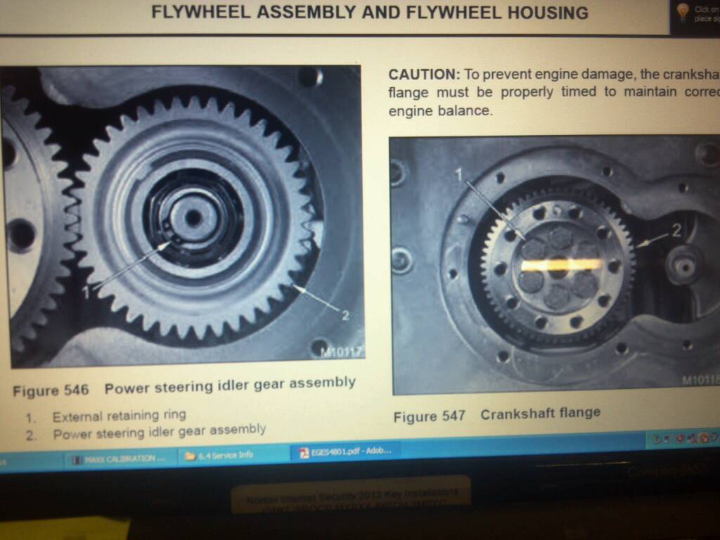

The cranks are different as well. Other than rods and pistons and some valve train. They really are two totally different engines. Here is the differences in the crank.
