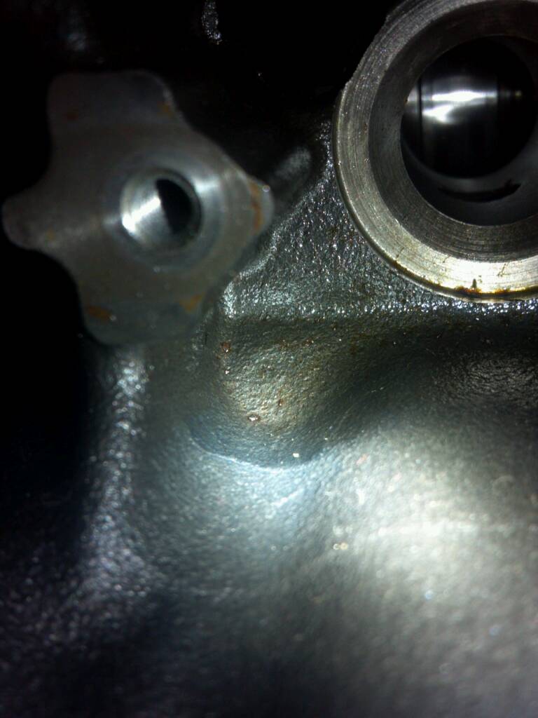

They seem to crack after the second or third time being torqued. The block we cracked had the original A1studs in for 35k miles torqued at 190 ft lbs. Motor was pulled for new pistons. Same studs were reused but new spec called for 210ft lbs. Motor went 50 miles and coolant was leaking out of threads on one stud. Job was redone this time sealing threads with liquid teflon. Went approximately another 50 miles before crack spread to the lifter galley, flooding engine in coolant. The crack runs horizontally front to back 4 threads from the bottom of the hole. Almost like the block pulled apart with the torque. The stud with the issue was on the right hand side second stud from the back, top row. Right where the casting is the thinnest. Truck now has a new block with studs torqued back at 190 and so far isnt leaking.
Did it crack at the casting line? I have not seen a actual crack yet.
mike@haller's
1,005
Cheyenne, Wyoming
No its about an inch below it. In the pic its the line below the casting line.
