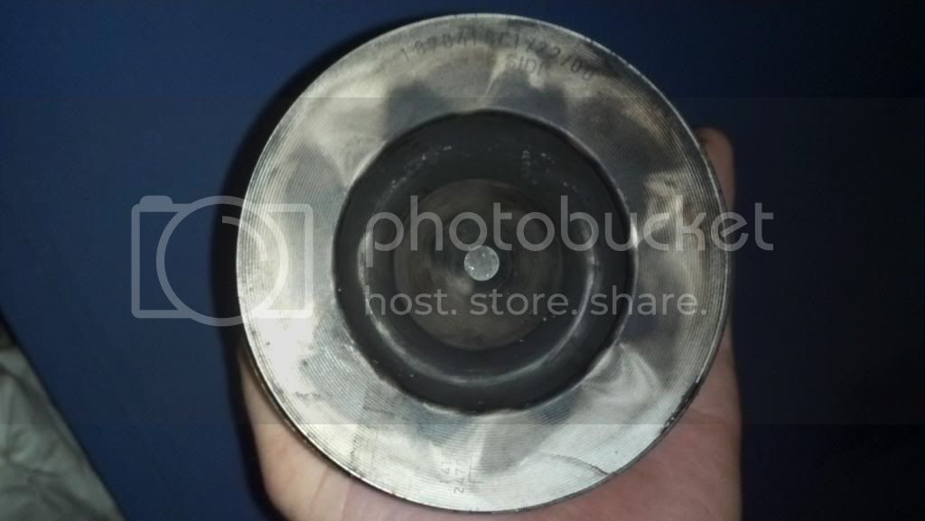

Here is mine from cyl 7,I haven't seen one cracking down low like this yet. It must have just started. Lower right side of piston.
powerstrokin15
5,594
Charleston, WV
if it matters, I drive mine hard, 24/7 in a race tune. I live in the mountains, at a decently high altitude. I tow pretty often as well, but don't beat on it when I tow.

Ahh the joys of owning a 6.4!
always something with these emission engines anymore. I might have to put off buying another 6.4 for awhile so I can save for a overhaul when i get it once ive drove it for awhile
Strokin6.4
Apr 19, 2012
1,117
I have a summet of dirt drags under my belt. No telling what temps and RPMs I was seeing but I'm sure that didnt help my truck at all.
Wemoy1
Nov 16, 2011
510
PA
I have one time of 2300F on the pyro before the heads were done and all pistons checked out a ok but that was 40000 ago.
nothing should ever be that hot.
i kick my trucks ass's , but my green one let one go at 5000 miles on them , cylinder #7. there is a reason IH redesigned the piston, its weak. im sure for a daily driven cast piston the new one is much stronger than the original design, hence the redesign. how often do you see a piston change in a motor? i cant imagine anyting but good coming from it. the new mtor in my green truck has elite forged and stroker rods, the silver truck got elite coated HD's. i have no fear in either now, i worried about the silver truck having the original pistons from BFT's motor but i thought the intake manifold would keep them alive, but going to the 110's and dual pumps killed number 3, and they let go at high boost and low bp (65/67). i know heat and BP played no role because they never saw over 1500* .
now all i can do is believe in re-engineering. BTW this $hit is expensive.

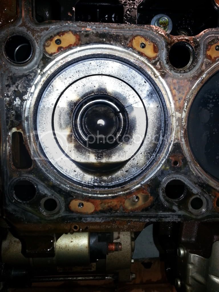

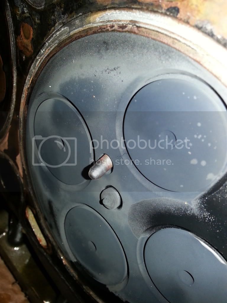

This is the truck I posted about in the first of this thread.
There's a piece missing out of the piston.
Passenger side head is cracked on every exhaust valve. Suspecting driver side is the same way.
