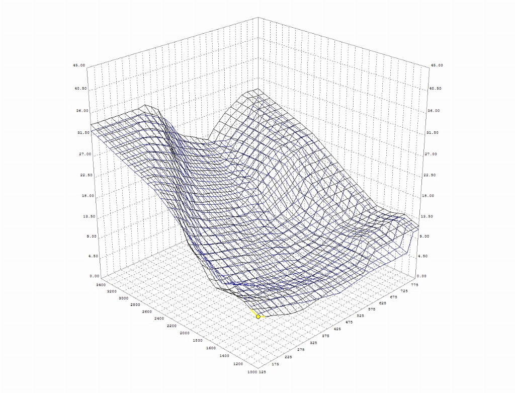

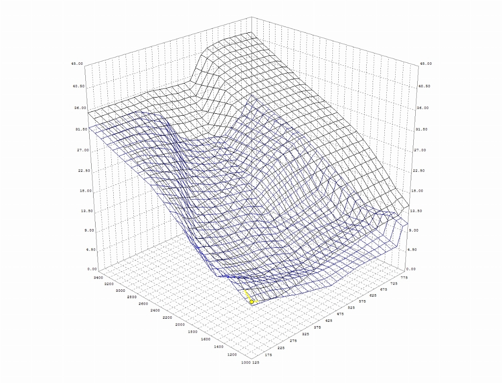

The stuff he has is from actual programs pulled off of chips - from rod'd DP tuned trucks.
Truuust me.
Here is a DP tuning 80e map... yummy stuff...

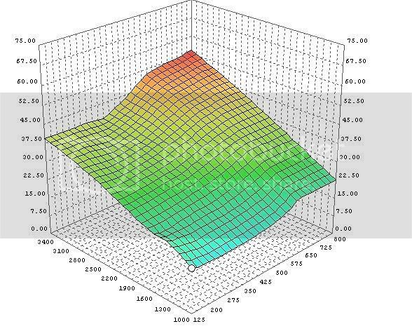

Now here is a guy who tunes part time for the love of the sport...
Another good old DP map...
If he saw that timing was so advanced, why did he continue running it until it blew?

Joe, I'm glad that I'm not the only one that doesn't mind pointing out the obvious. Like the two guys about 3 or 4 weeks ago that both blew a rod out of their block within a week of each other, both running dp tuning. Which Jody proceeded to explain how it was, and I quote
NO WAY IT WAS MY TUNING!!!!!
LOL Picture frame worthy!
