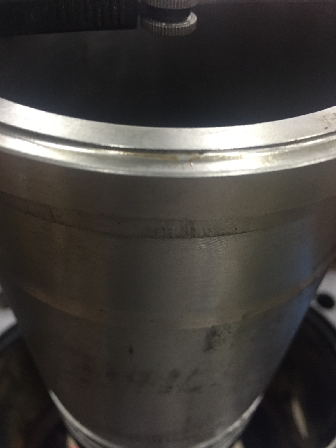

Can anyone school me on liner protrusion. Deck to bottom of counter bore is .356
The first step of the liner is .352 and then the next step is .398. None of these seem to get me the proper .003-.004 measurement so do I measure to the first or second step on the liner ImageUploadedByTapatalk1457049517.228781.jpg

Yes but it sits down in the hole .004 not protrude out .004

Ok. Just thought maybe there was a brain fart somewhere. Haha. I didn't think cylinder sleeves were supposed to protrude, but didn't think they should be sunk in either. Thought they should be even with the top.

The spec I found from international was .003-.004 protruding. Which There's two steps on the liner one sunken .004 other sticking out .042.

You ordered from a supplier at your work right? Maybe give them a ring on the phone.
There should be a lip on the bottom of your cylinder ready for the sleeve and then the outside step on your sleeve sits on that lip in the cylinder and the inside step on your sleeve goes past and should be even with the bottom of the cylinder. Sounds like the sleeve is
.008 too short. Are they all that length?
