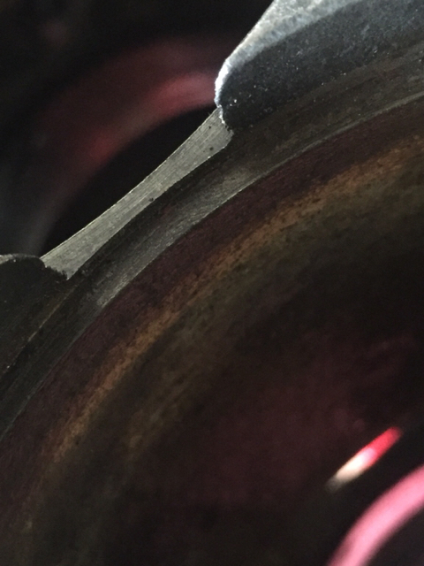

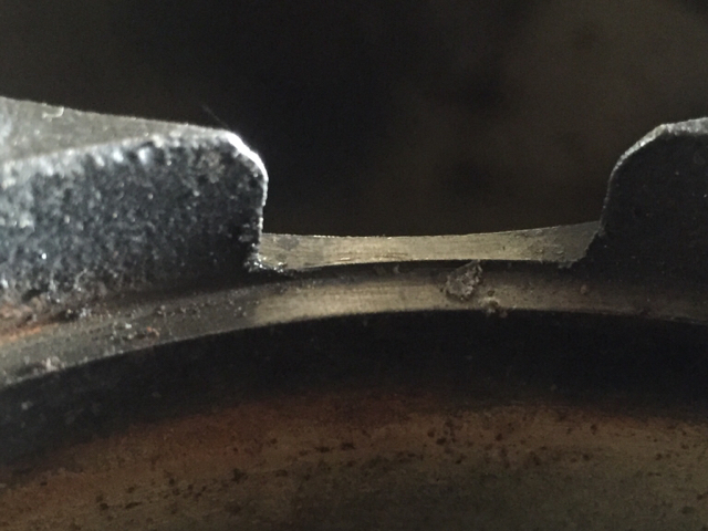

Meanwhile looking at my block. Cylinders 1&6 counter bores are cut deeper. Is this normal? ImageUploadedByTapatalk1457297930.799178.jpgImageUploadedByTapatalk1457297939.617441.jpg

Yes, I ran on street for a few months. I was running a 5spd Allison from a duramax behind it at the time. Then I pulled it to switch it to a 6spd. Needed lower highway rpm, but the 3.73s with 35s was perfect behind the Allison 1st gear pulling a load. I wouldn't recommend a manual trans, even though I prefer them in all aspects over an auto. I was 948/1863 on the dyno when I snapped the shaft in my hx52. Between that and rebuilding the trans to a 6spd, that was the end of that truck

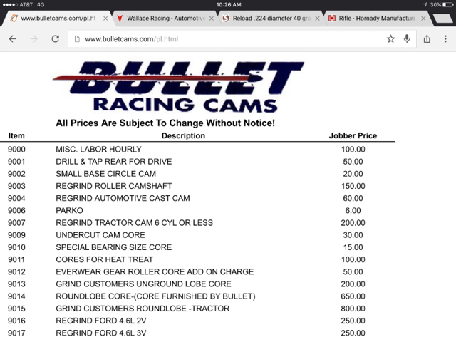

Bullet cams is going to grind me a cam for my dt360. Found a little more wear than I would like to see. On one lobe

It was (cheap) priced up front. I told him the goals of the truck wanted to stay reliable so not to go crazy with lift but to help the motor breathe gave him a 800 hp goal and what turbo I was planning he told me not a problem just send the core to him and it would be done.
They do tractor pulling cams and regular gas cams had great experiences with them in the past on some friends mustangs.
