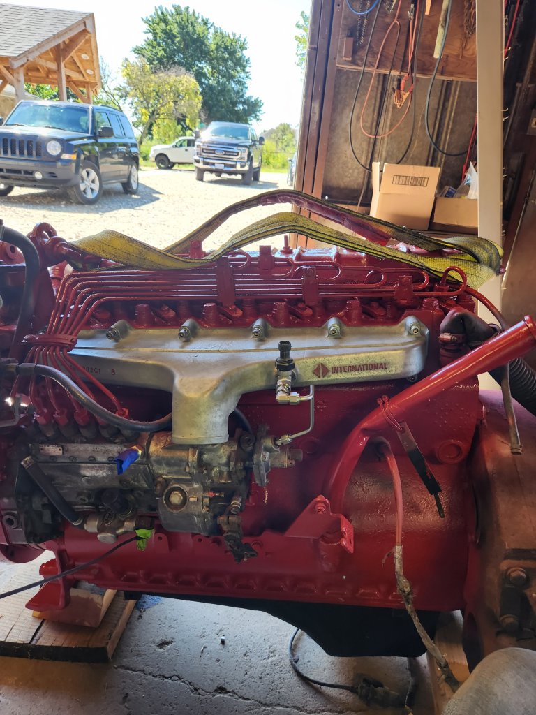

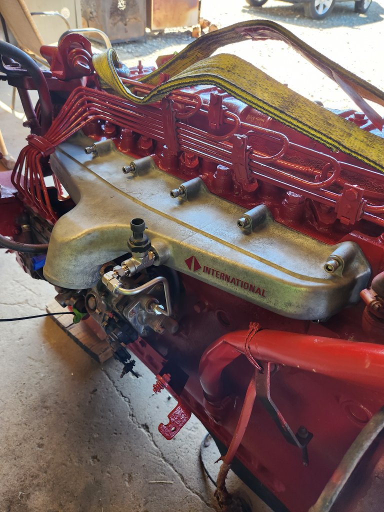

Bead blasted paint off intake. New Android tube out of ss and factory map pressure sensor installed.

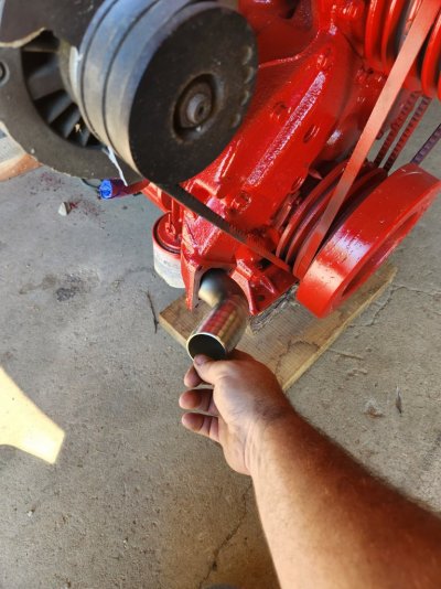

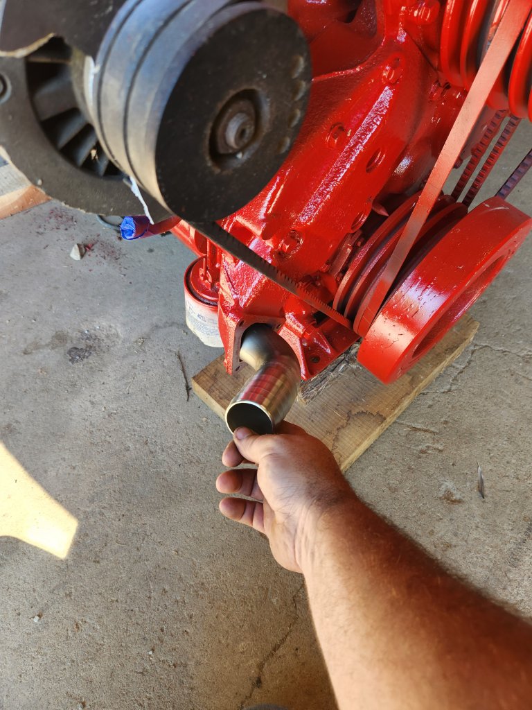

Making custom water pump inlet flange. This will align with the stock lower radiator hose. The cast one was wrong angle and too bulky.
Nice! My intake plenum if flipped upside down so I could run plumbing over the top with a water to air intercooler in between. Saved me some plumbing and welding pipe

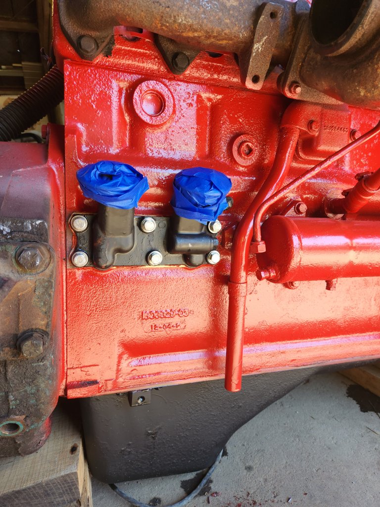

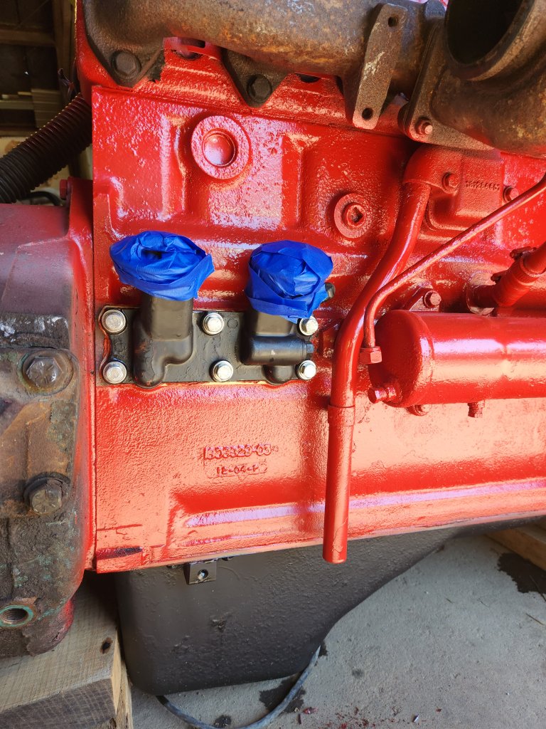

Ag oil filter assembly on.
Now there is an option I wish I would have known about! I did the relocation kit which is fine but it’s more stuff going on that side of the motor, on The upside I mounted back on the frame rail that is easy to get to and it cools the oil a bit
